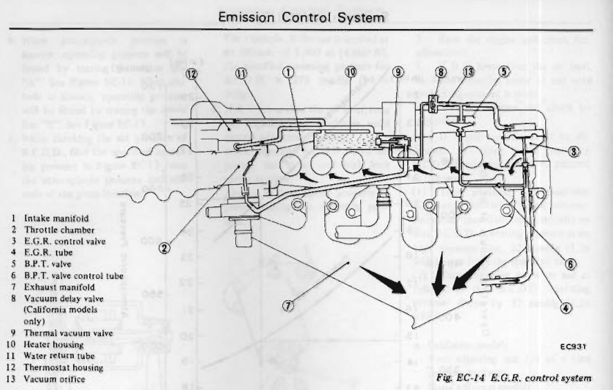

Might be that those aren't access points for the EGR ports but are actually core plugs.  Screw-in instead of the typical press-in.
I've never examined the inside of an intake runner to see where the exhaust gases are let in.  Might tell you something.  There has to be holes somewhere.  I've seen them on my 2003 vehicle, a Ford.  They're known to clog.
The FSM is pretty vague with magical arrows.
Edit - actually I think that the holes are in the plenum not the runners, I think I knew that but had forgotten.  Harder to see.  Which I still had my pile of parts to go play with.  A borescope view would be fun.

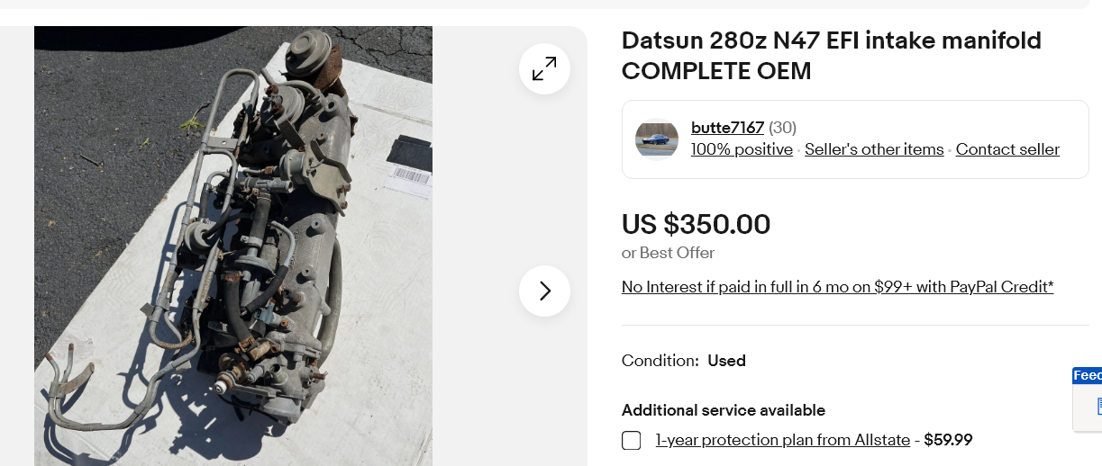

Coincidentally, many people think that Nissan added the webbing to the 1978 manifold to combat the heat soak problem.  Subject of a current discussion.  I'd look for an N47 (I think) 1978 manifold.
Still not cheap.  $8 for a tube of SteelStik.
https://www.ebay.com/itm/385520584919?mkcid=16&mkevt=1&mkrid=711-127632-2357-0&ssspo=So6yfmz_TvS&sssrc=2047675&ssuid=bBzFtXzvTQO&widget_ver=artemis&media=COPY

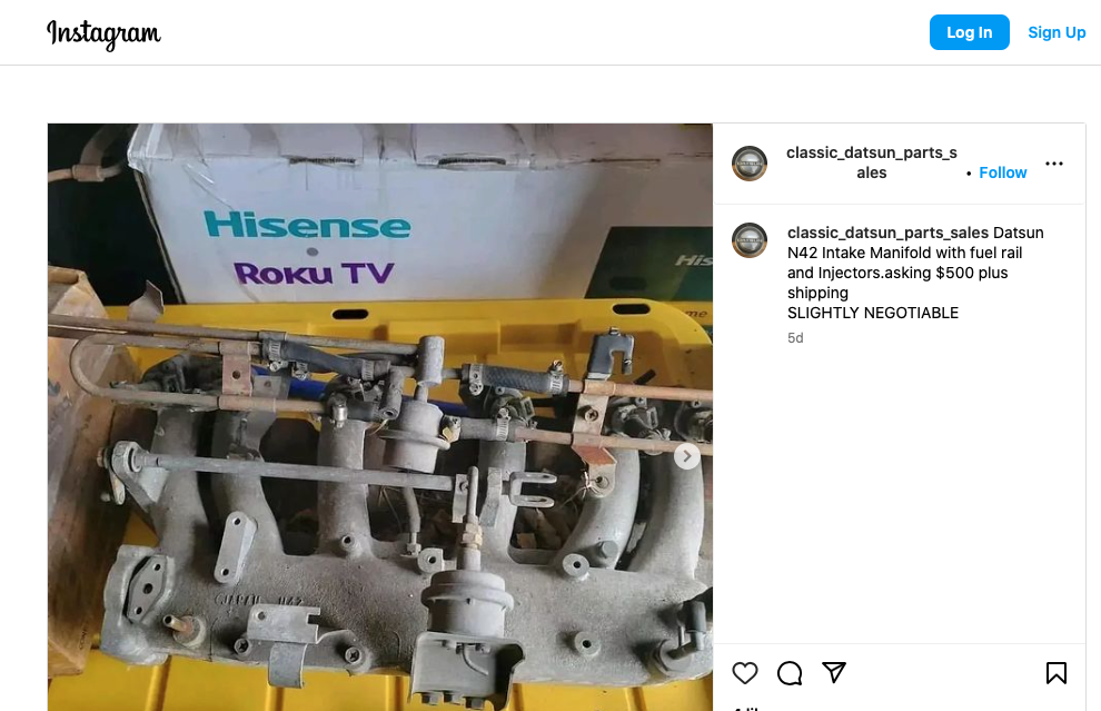

I checked eBay and found no N42 Non EGR's currently for say or sold. I checked some other individual sites and they all said sold out.
2040-parts.com list one for $500 but the site looks shady to me.
Another on Instagram, also $500. beware of scammers!!

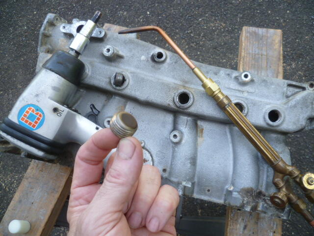

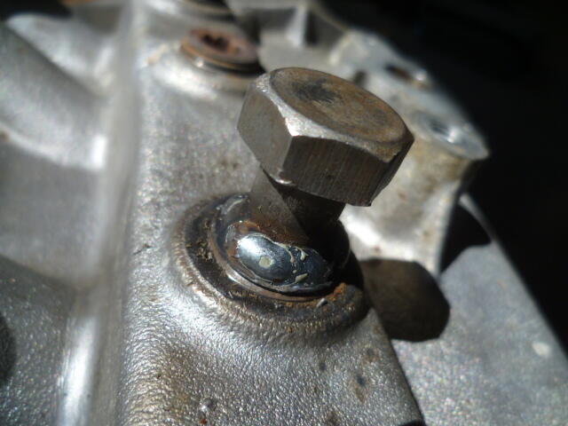

Those plugs cover over a passageway between the EGR passageway and into the individual runners. That "sand" you poured out is probably just years of decomposed aluminum and combustion byproducts and debris. If you removed one of the threaded plugs, you "should" see the hole up into the cylinder runner. And again, if you don't it's because it's all plugged with crap. It's there.
How do I know all this? Because I did an EGR delete on a ZX intake manifold. It was not a simple job. Went like this:
Step one was getting the plugs out. First one came out with no significant drama. Kinda like yours. Lulled me into a false sense of security. Just like yours.
Next couple required torch heat and an impact to get them out:
Next couple stripped out the hex (just like yours) and required emergency measures:

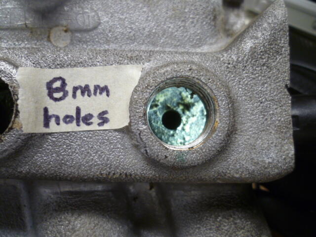

But if you manage to get all the plugs out, you should be able to look down inside the holes and see the passageway into the runners. Here's an example. Note that I've labeled the hole as 8mm, but be aware that they changed that later in the run and made the holes further from the EGR larger, presumably to even out the amount of recirculated gasses between the cylinders:

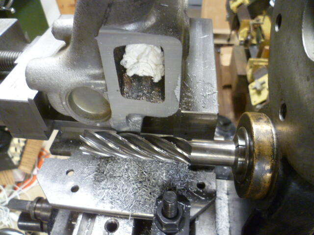

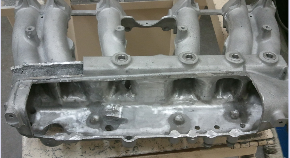

I drilled and tapped the holes and loctited a blug bolt into each of the holes. Then I sawed off the EGR section, milled it flat, and made a block off plate:
Quite a bit of work, but turned out great, and since the sealing into the runners is done with bolts, that plate doesn't even really need to seal.
