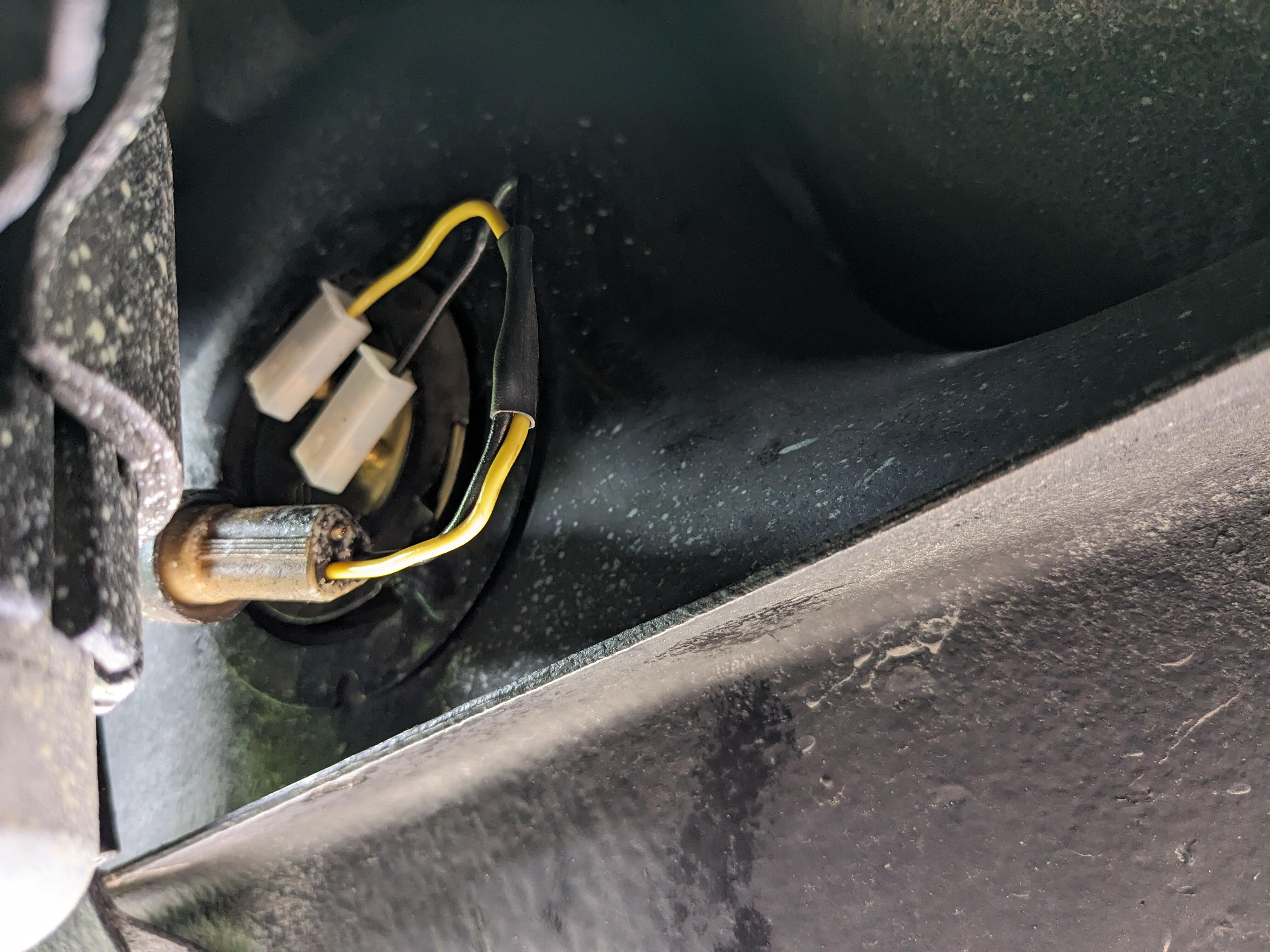

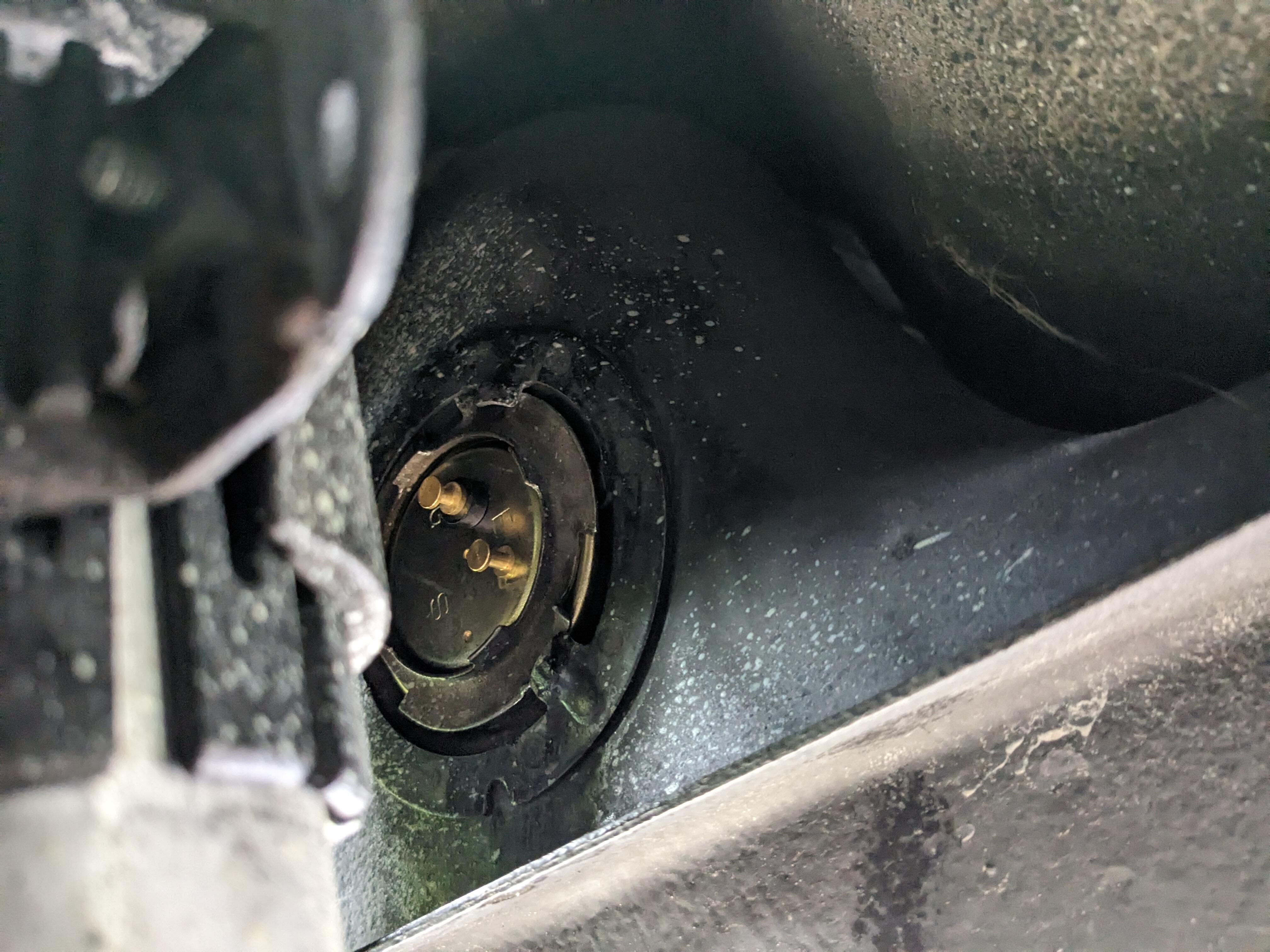

Put in the new replacement sender yesterday, since the rains hadn't started yet. I reused the factory o-ring as it is more substantial. Had to remake the short harness. I found that when I filled the tank after, I will have to remove & adjust the arm, as it doesn't register at the full mark. Made sure notch aligned with alignment tab.

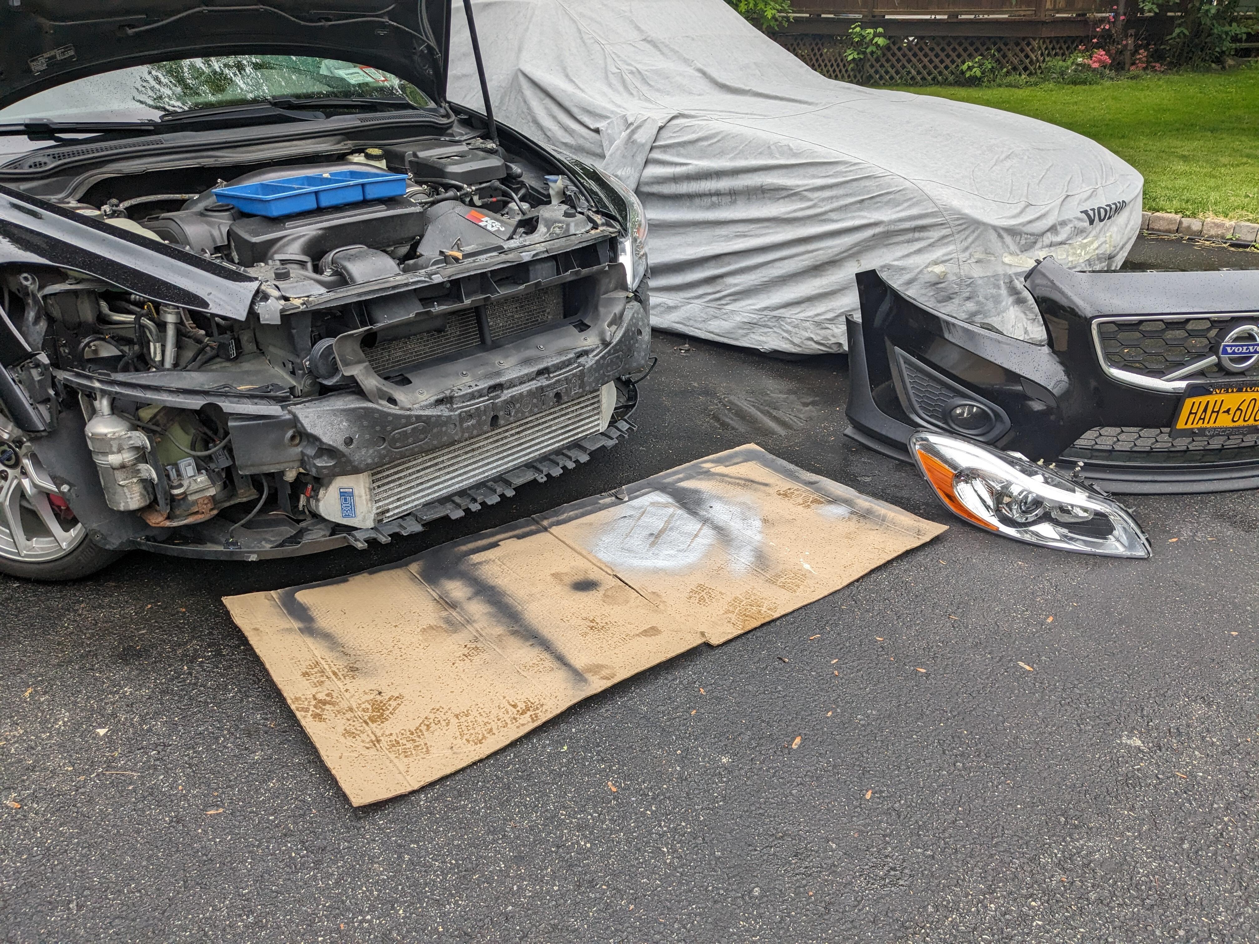

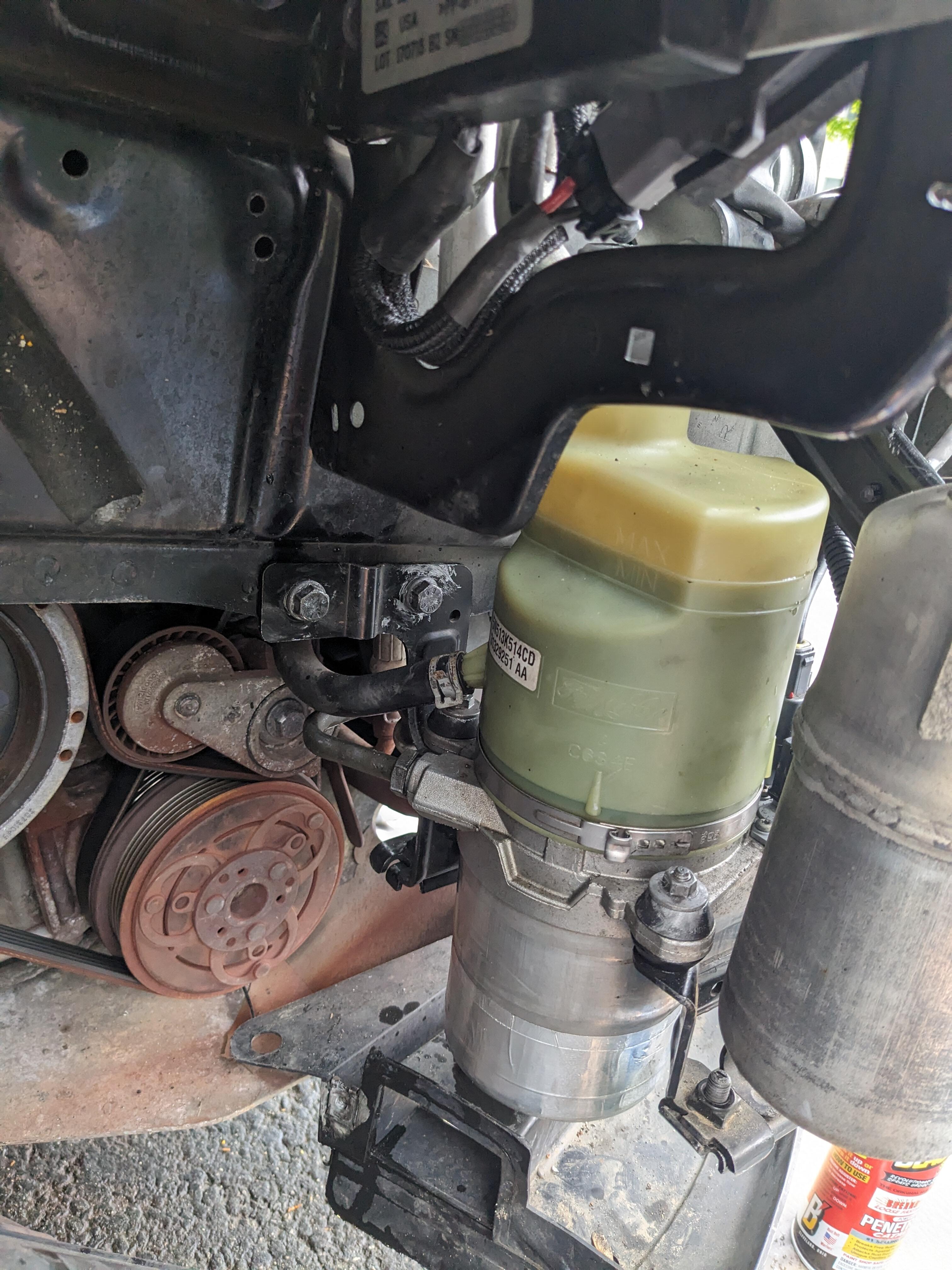

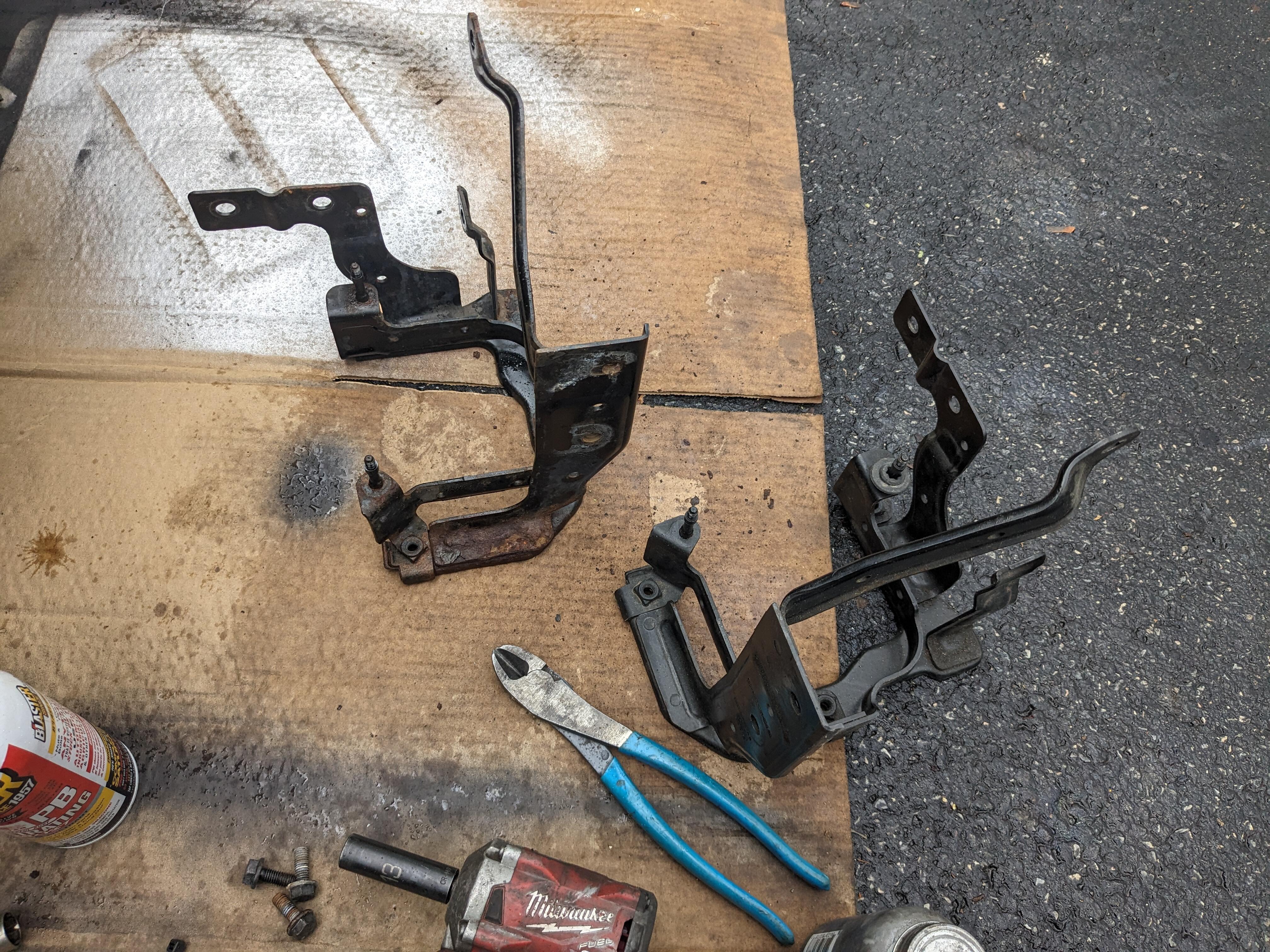

Yesterday I swapped out the EPS pump on the C30.

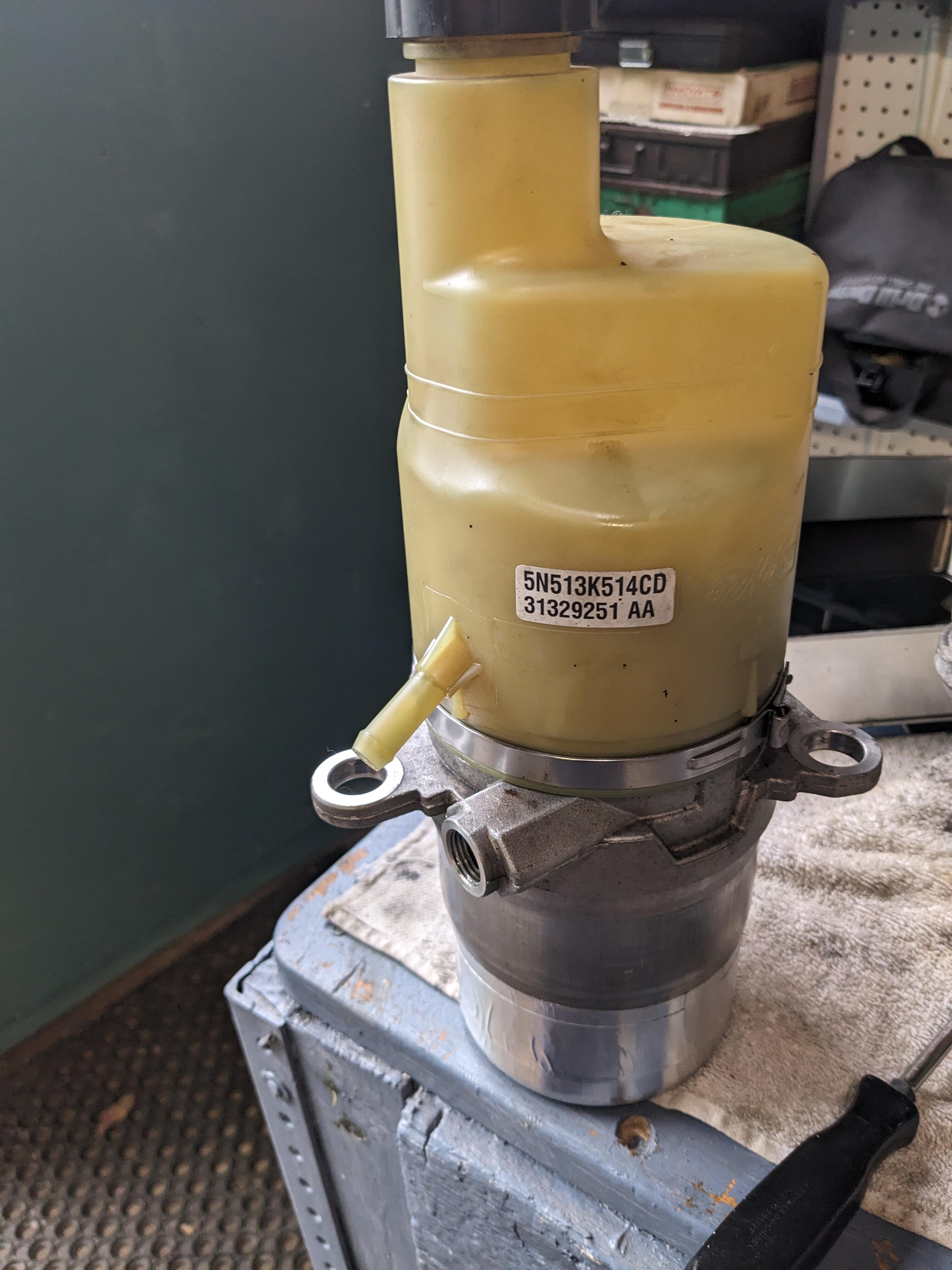

remove reservoir
transfer to rebuilt pump
replaced mount brackets
in place
Problem is, there are more than one style power supply fitting, it turns out. I didn't think to even check that. All the online vendors that sell terminal/connecotr kits for these pumps (commonly used for EPS conversions) sell the Type 1 set, which is what is on my (2012) car already, not what's on the older remote reservoir pumps.

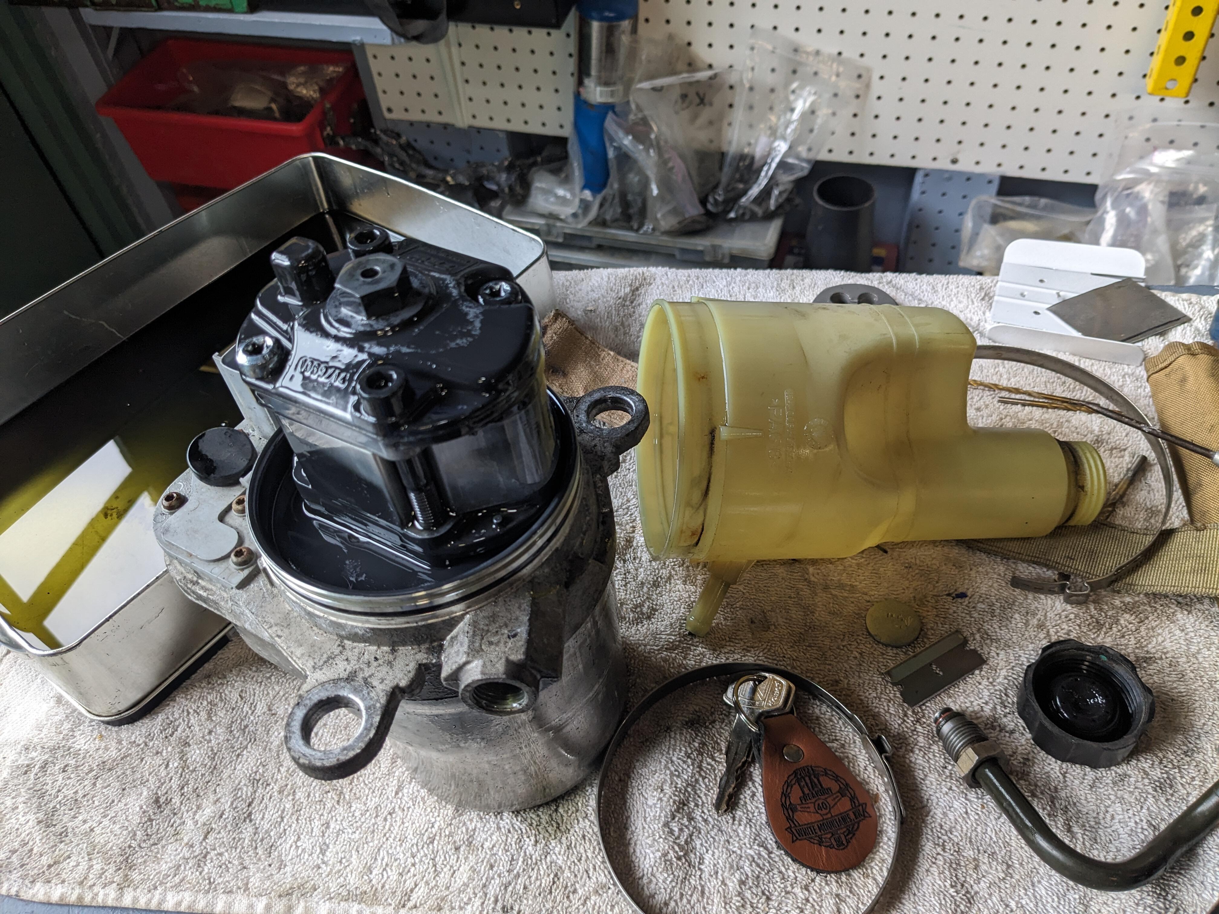

So, today I rebuilt my original pump & reinstalled that. Remove pump
no bearing remnants in this one
cut off lower housing
back together with new lower bearing
back in, take 2. All good now, pump works, no noises
