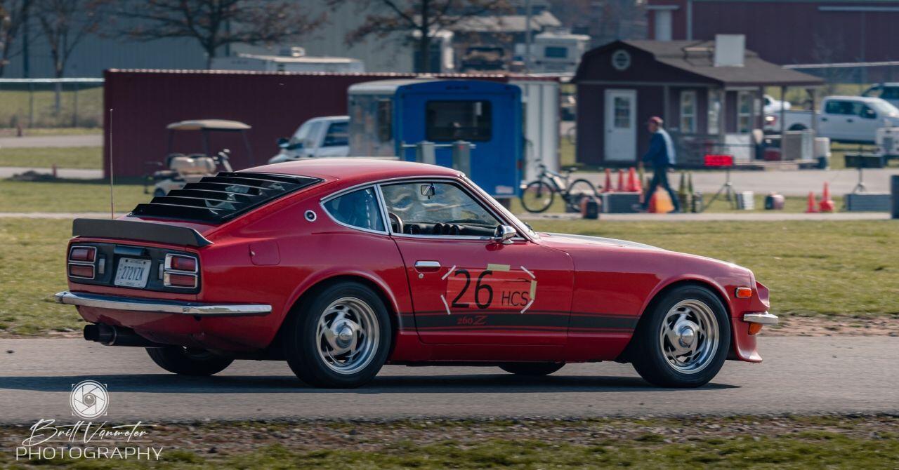

This past weekend I got a successful 8 runs in at Dragway 42 near Cleveland, OH. The event took place in their parking lot which is a lawn area crisscrossed by pavement. This was their last event of the year so I'm making plans for my 260z's hibernation upgrades.
One issue I'd like to address is rear tire grip. I've tried lowering my air pressure to 28.5 psi in the tires all around but my rear tires could still use a little more grip.  I'm currently using Kumho Ecsta AST KU25 All-Season 225/50R15 91H which are performing well on roadways. I started looking at a track tire alternatives that I can switch to for auto-X and came across some 225/50R15 Hoosier R7 with 3/4 thread remaining on usedracingtires.com at $100 each (plus shipping). I am likely only able to haul two extra wheels in my '74 Z so unless I want to risk driving with these slicks on the public streets, I would be limited to switching out only one axel at the auto-X event.

Been to 42 a few times with my '73 FP car. Fast and fun.
Q1. It's probably best to use the same tires front and rear. You want the car to be as "neutral" as possible. Too much front traction can induce oversteer, to much rear traction can induce understeer.
Q2. No
Q3. I see that you are running HCS. The rules only allow for an 8" rim width. When I drove my '76 car in BSP, I went with a 16x7 rim with a 225-50-16 tire. I tried 16x8 rims, but they rubbed a little. You should probably stay away from steel rims. They are less expensive than alloy, but much heavier. Un-sprung weight is your friend.

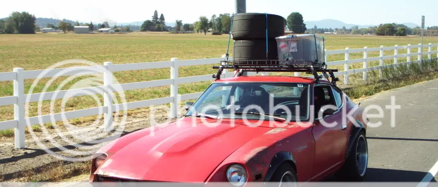

It looks like my best option to control my car around the sharp Auto-X turns would be to install an LSD. I'm tabling my tire upgrade for now but if I go back to it, I can always buy a full set of 4 and car-top two of them.

Looks like you still have room to lower the car.  That will make a big difference.  And anti-roll bars.
Perhaps breaking loose is the wrong words. I get tire screeching and oversteer both right and left. I understand that oversteer is inevitable when the car is pushed beyond its limits. I want is to expand the car's limits. I thought sticky tires was my most cost effective way to do this but now it sounds that an LSD might be the way to go.
