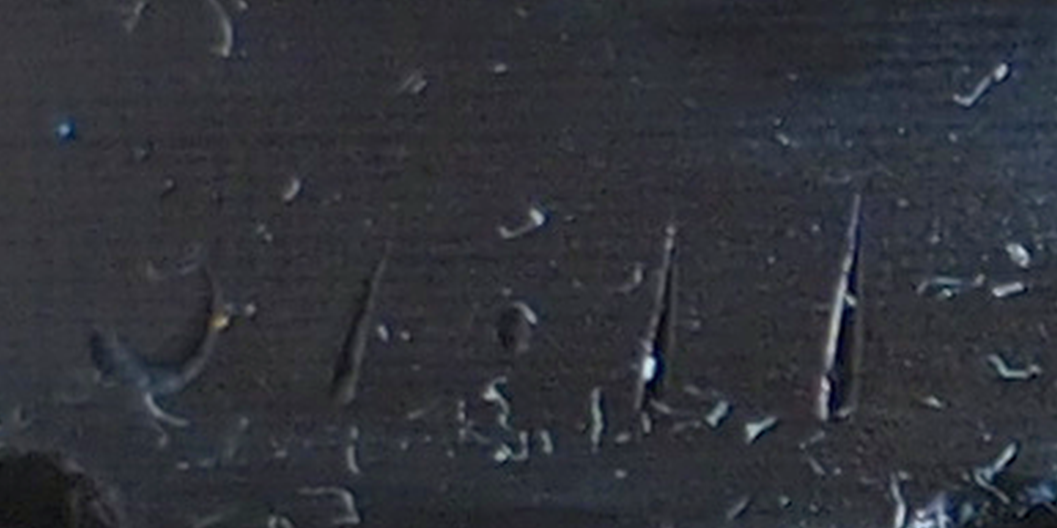

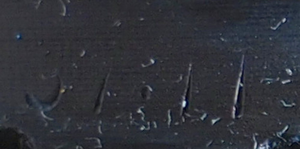

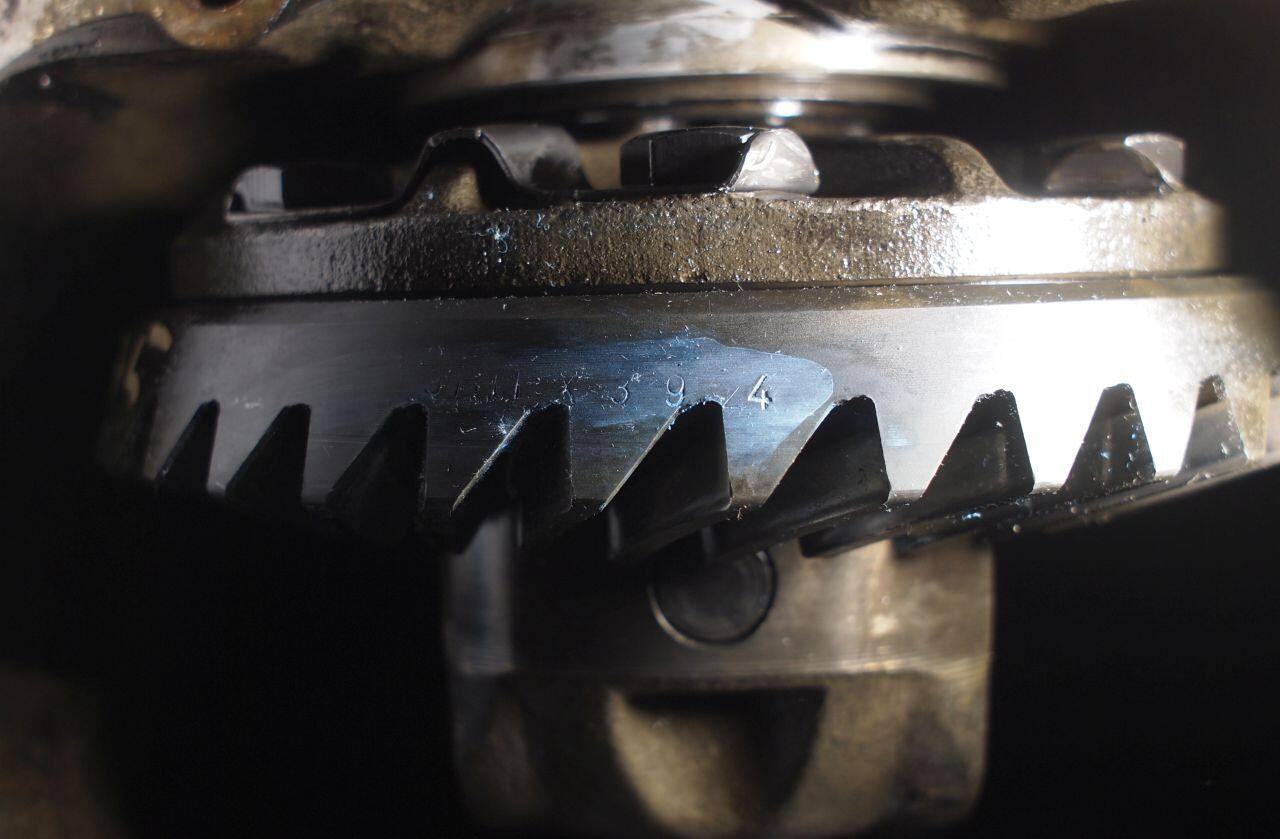

I'm trying to determine the gear ratio on my R180. There is a number on the ring gear of ?? x 394
Does this mean 3.94:1 ?
Should I just see how many turns of the differential input is required to make a full revolution of the ring gear?
Can anyone assist in decoding this?

If the numbers don't make sense then counting turns is pretty fool proof
Or just count the teeth......
All the ring gears I've seen have the two tooth counts with a : between them stamped into that crown gear, like 39:10 which would be 3.9 to 1 ratio. Keep looking.
Edited by zKars
https://www.classiczcars.com/topic/68685-r180-gear-ratio/#findComment-659675
I think zKars is right. It's hard to say where the differential came from because the R180 was switched out with an R200 in the early 1980's but some time after that, it must of got switched back to an R180.
