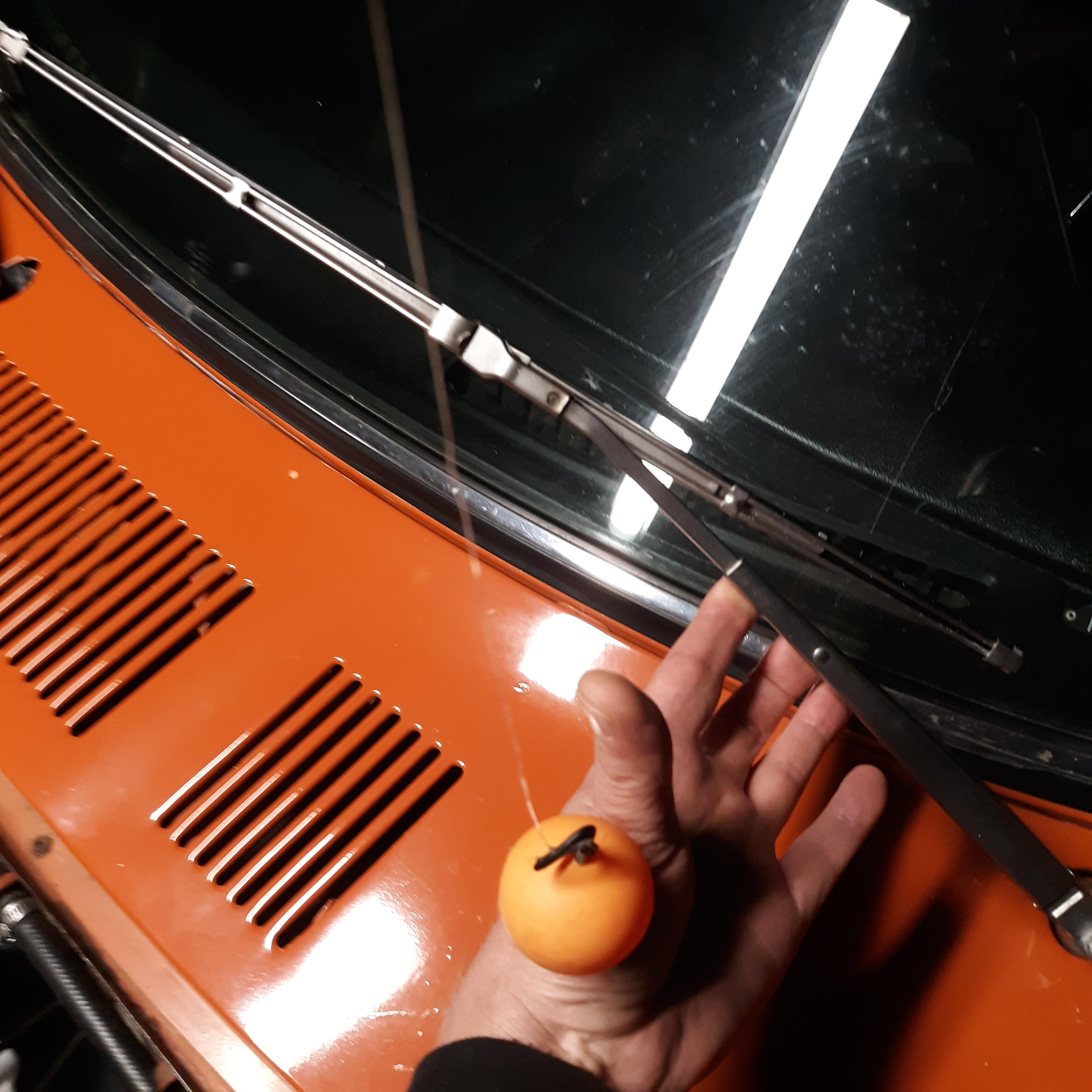

For those of us running the OE wiper blade frames, what are you doing for blade refills??? None of my area parts stores carry refills other than a Trico break-to-fit length that doesn't work. I've crawled Amazon and ebay, thought I had found a match with some NOS ANCO blades but no joy.

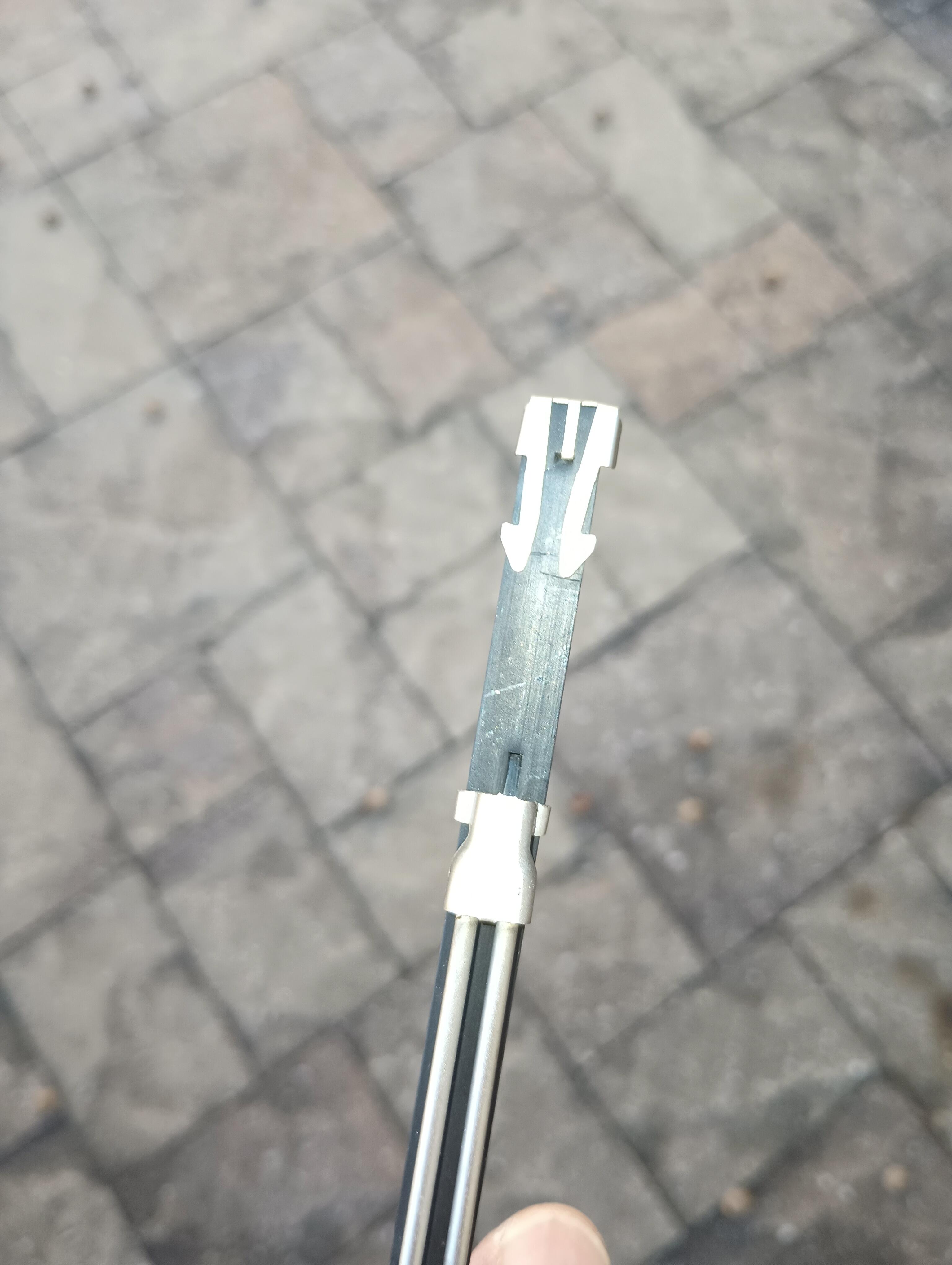

In digging deeper, I read the reviews on Amazon for the 33-183, and people say the bayonet adapter is plastic. https://www.amazon.com/Trico-33-183-Classic-Wiper-Blade/product-reviews/B000CRMNJC/ref=cm_cr_dp_d_show_all_btm?ie=UTF8&reviewerType=all_reviews

Yup, I found the same comments on Amazon. Look closely at the pic and you can see the stainless steel reinforcments along the backbone, common on most new blades. These SS ribs are typically too wide to fit the OE frame.

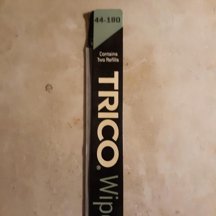

I have these on mine. No issues, bought at local parts chain. Advance I believe...
Trico 44-180
A search in Google is showing a lot of "out of stock" on that part. I bought some the previous time you mentioned them. More and more parts are just unobtainable.
