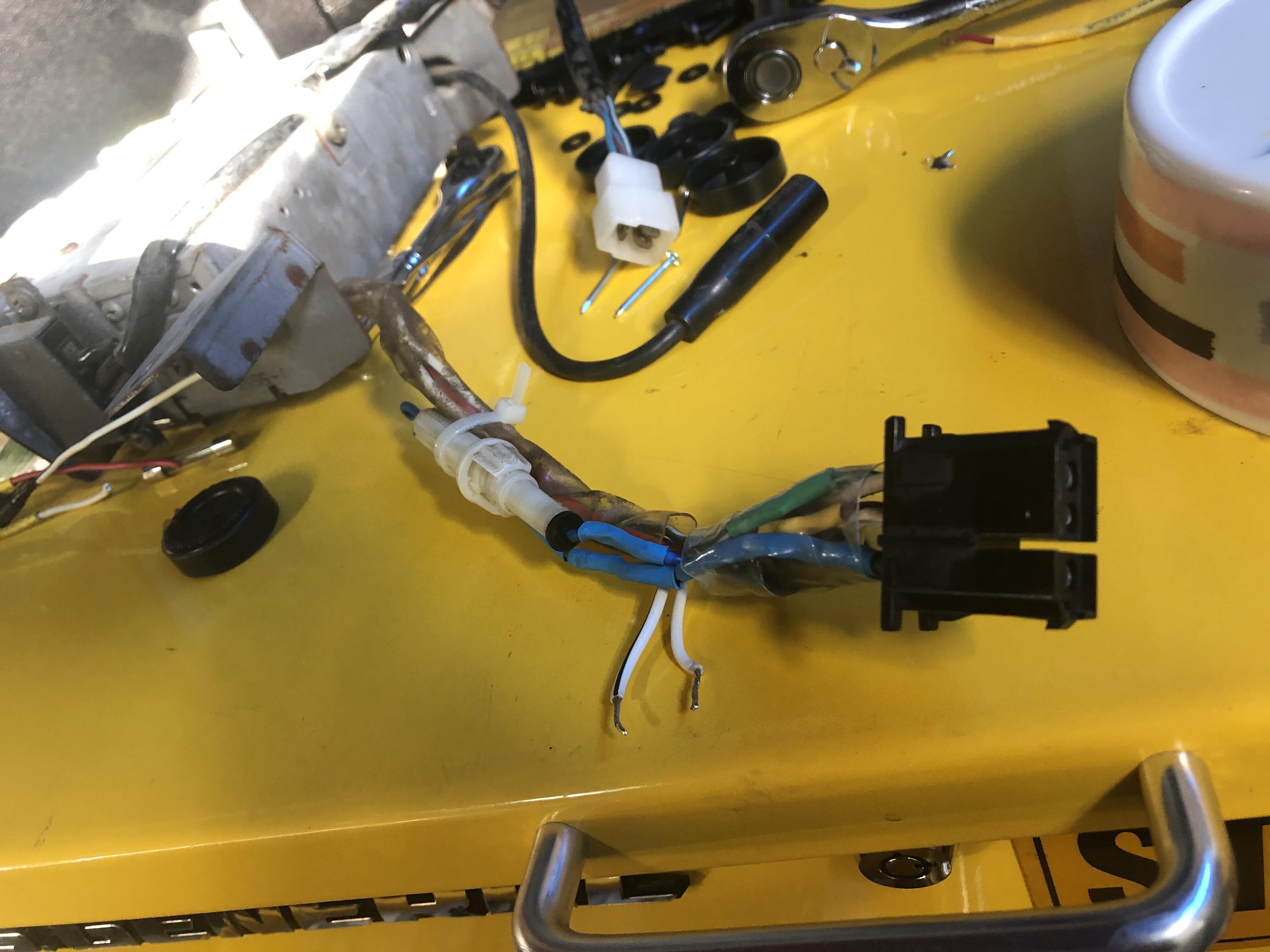

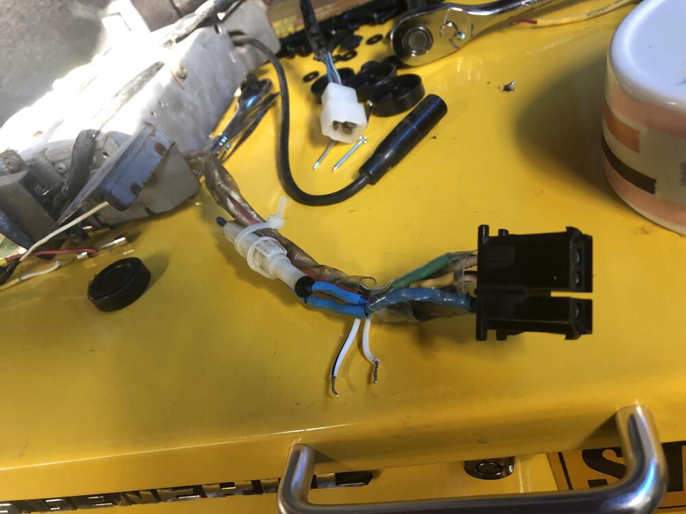

I dont have the female end of this connector under my dash. Seems like this is the only modification the previous owner made. Basically cut out the connector.

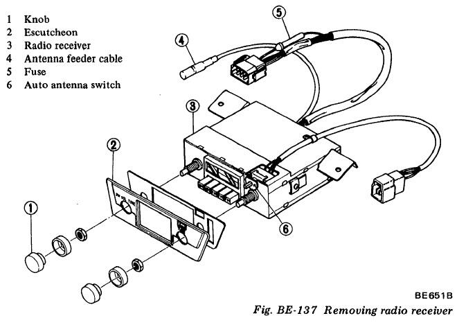

I could not locate the wiring diagram for the radio in the FSM. I am sure there are power and speaker wires all in this connector.
Any tips?
Are you sure? It should be in the chassis-service manual in the electronics section.. otherwise it should be somewhere on the internet i think.  I can't help you as i don't have a clarion of that type.  (The one with the fuse is the 12v+ i guess.. and with a ohm-meter you can find out the rest? 🙂)

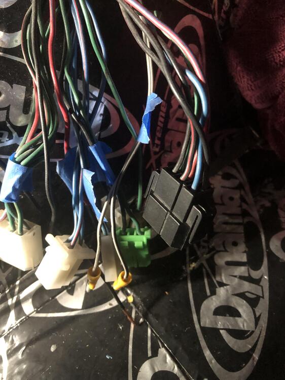

OK, so my car has this connector still there with wires cut which you see connected in #5 in the pic.

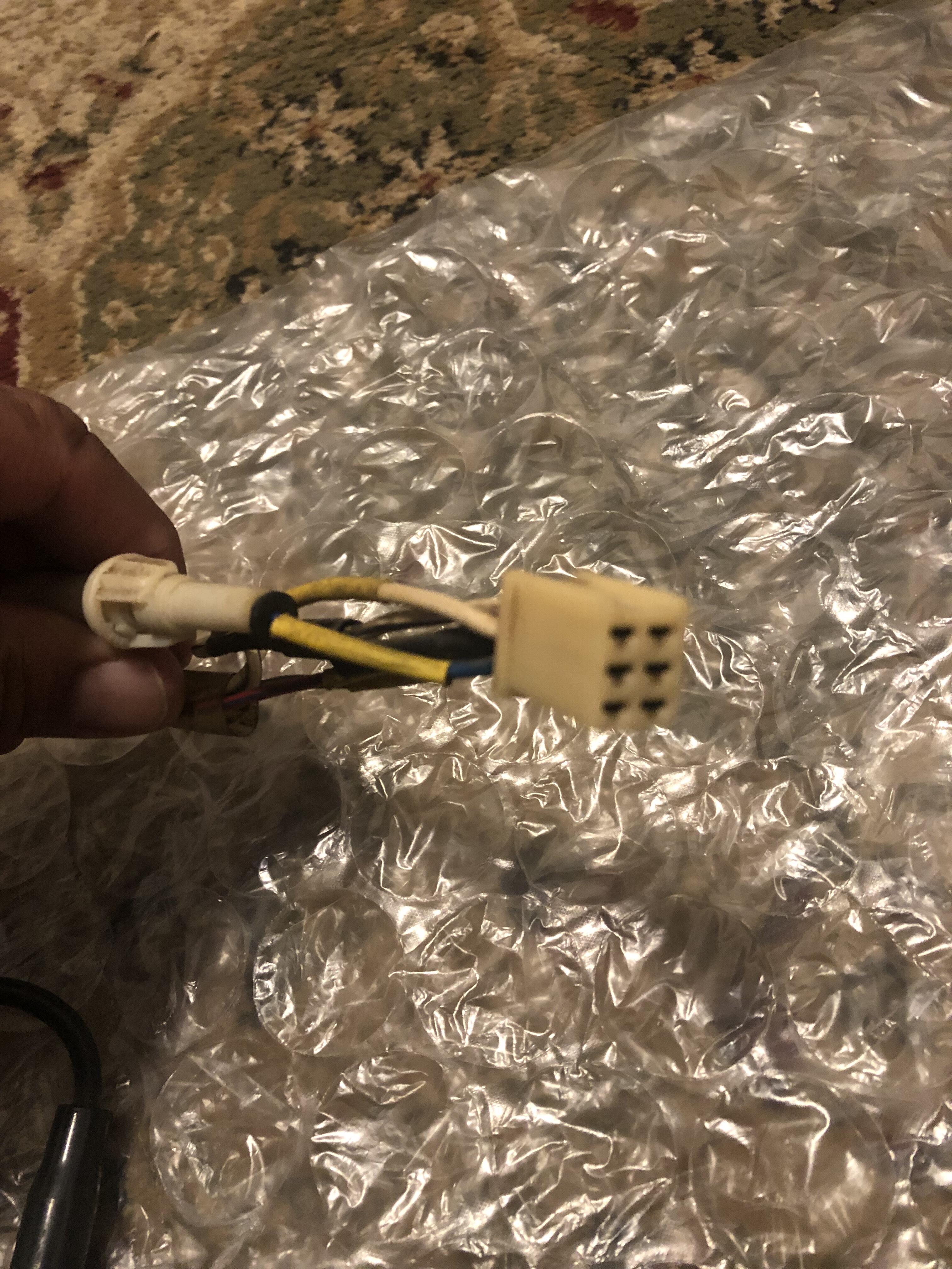

This Calrion from the 76 280z 2+2 has a different connector!!!
I need to try my luck with the guy i bought the Radio from. May be he still has the parts car.
Luckily, I found that the connector from my original radio harness was complete (male/female). Cut the Clarion connector and tested with the original black radio connector and it works great. Radio lights up!!! Good reception even with no antenna extension.
I had to directly connect the speakers with the radio speaker wires as I have the 2 new Polk Audio speakers installed. I think this is a mono radio so planning to just connect the two speakers in parallel and call it a day.
Probably will buy a cheap FM broadcaster to send music to the radio ... but i dont listen to anything when driving it anyway.
