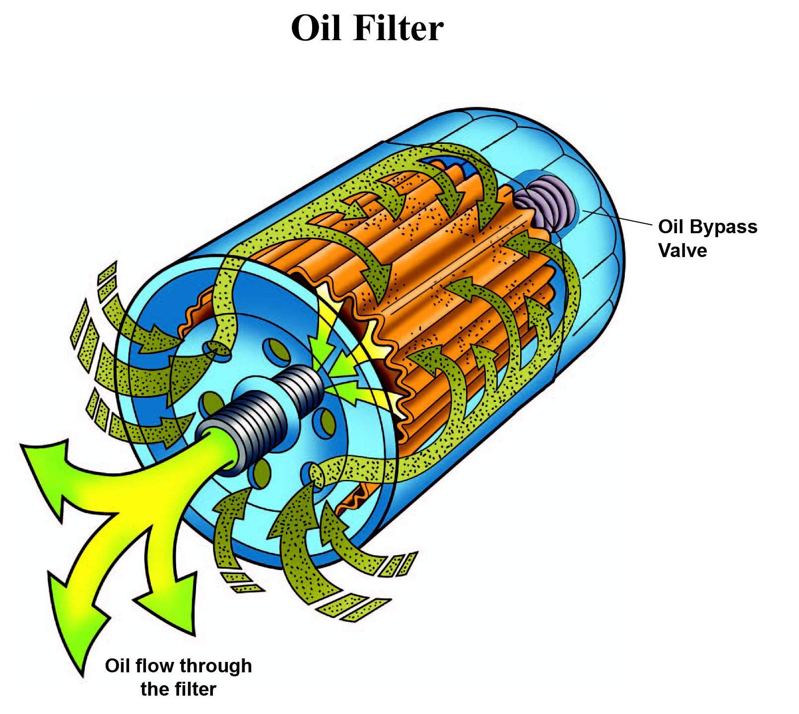

Guess you now can find out what i always wanted to know.. does the oil flow from the inside to the outside in the oilfilter or visaversa? 🙂
btw.. use a sharp chisel (woodchisel) to open up the oilfilter (Near the connecting end) do not use a hacksaw, Hihi..  as they make lots of metalflakes..  first woodchisel, then scissors can be used.
Edited by dutchzcarguy
In the small holes, out the big one.
