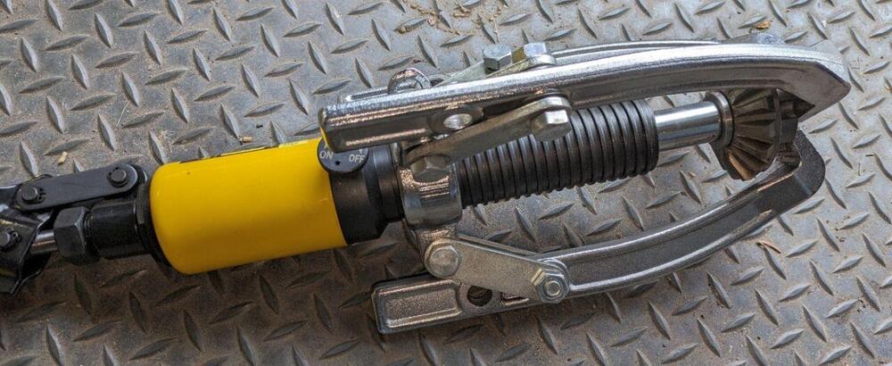

KAAZ tech replied that its a tight fit but I should be able to install the new buttons.
In the mean time I found this thread:
https://ratsun.net/topic/23766-k-r180-411-swap-need-help-pics/
that shows how to swap the buttons from an older R180 to a K R180. The article also references the same thread that Zed Head posted but includes more detailed information on how to separate the spider gears from the R180 to get to the buttons. Specifically, it shows where the roll pin is located that I need to drive out.
