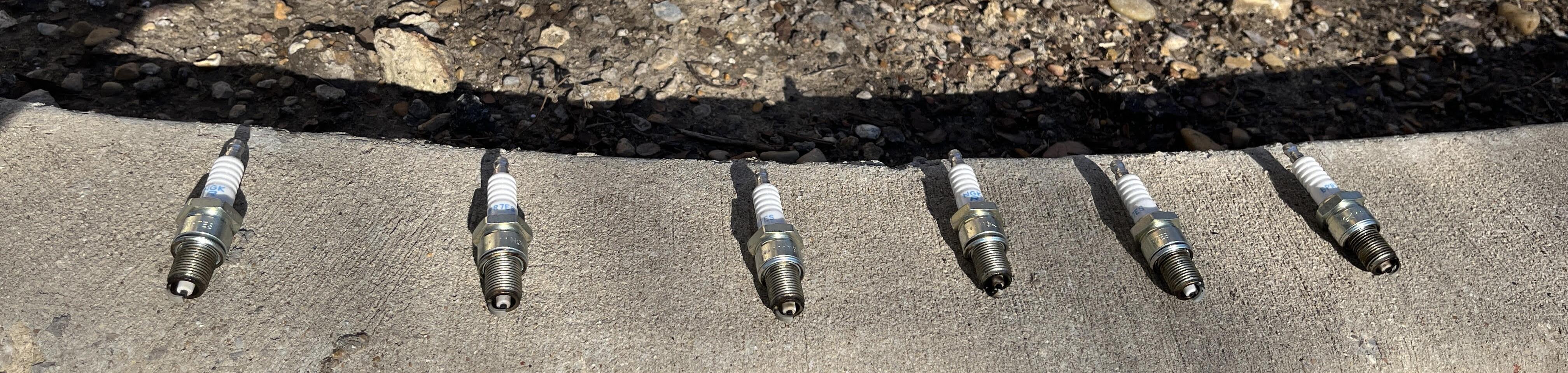

Hi guys,
I'm running lean all of a sudden and not sure why.
It is worst when hot-starting with a very lumpy idle that stabilizes after a minute or so but it is weak throughout the rev range (unless flooring the pedal).  The idle stabilizes the longer it sits but is definitely misfiring (or not firing) when hot started.  The idle is very lumpy but also smells very rich.
New plugs with ~2 hours run time on them.  Injectors about 2 years old.  Any idea on the below plug images?

The hot start issue is very common.  But it usually clears up within a minute and the engine runs normally.  Your plugs are too new to tell much.
It's weird this would just start all of a sudden though.  The car started running really lean on the freeway out of the blue, I had to get off the freeway and richen it a tooth on the AFM because I was concerned about potential engine damage if I didn't (it read 18 on my AirFuel gauge all of a sudden and started to misfire).
Cylinder 3's spark plug looked very rich compared to the others.
