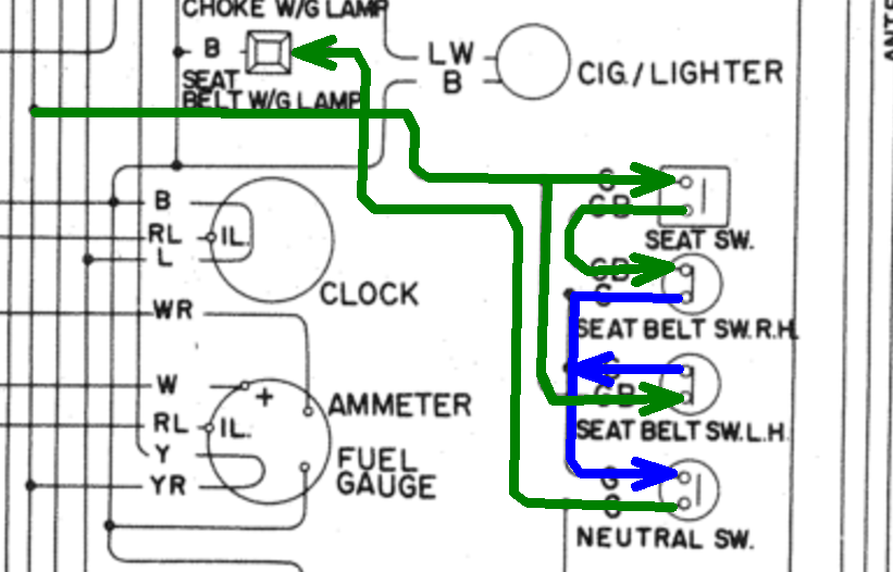

I couldn't find it on the 72 wiring diagram, so I'm going to assume it was done the same was as is shown in the 73 wiring diagram.
The 12VDC+ goes to the passenger seat switch and to the driver seat belt switch. If there is a passenger (or heavy object) in the seat, the 12VDC+ goes to the passenger seat belt switch. If the belt is not latched, the 12VDC+ will go to the neutral switch. Whenever the transmission is in neutral, the 12VDC+ will go to the seat belt warning lamp.

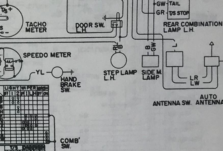

I guess it would help if I had the right wiring diagram for my year! 3/72. My seatbelt buzzer and key buzzer are the same (no key buzzer on steering column) and the buzzer is near the fuse box. The wiring diagram I have is for an early model without the seatbelt light. At least now I have a fighting chance.

It is a challenge to get a static document like a wiring diagram to match production changes. The wiring diagrams we have in the FSMs were probably created before the first car rolled off the assembly line for that year. Today we are spoiled by being able to open up a CAD program and fix an error. I don't want to think about what it was like when you had to create these with vellum.
I have seen significant differences elsewhere. In the 73 diagrams, it shows several extra wires for the intermittent wiper amplifier. That was confusing. In the 75 manual, it shows the seatbelt interlock relay that was eliminated just prior to the start of the 75 MY production. Remember that the North American 260Z had an extended production year as Nissan was preparing to roll out the 280Z. During that timeframe, the US government walked back the requirement for the seat belt interlock requirements, and I'm sure Nissan yanked that abomination out of the wiring as soon as possible.
Then there are errors that crept in, like the representation of the ignition relay for the 280Z that shows two wires going to the same place.
