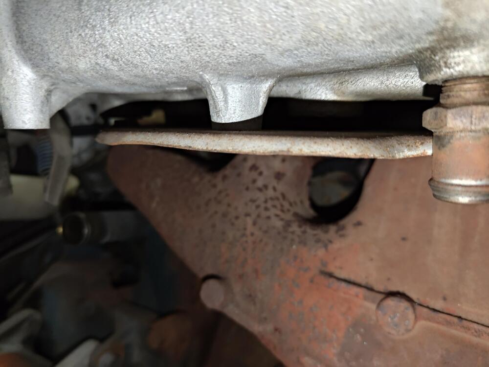

2 hours ago, Zed Head said:
That's the PCV valve, not the BCDD.
Yes, the PCV hose from the block to the PV is a specially formed hose.  Yarb referred to it above.  Small one end, big on the other.
When things aren't tuned well the engine will often be non-responsive to tuning efforts.  Kind of a vicious cycle, a rabbit hole.  The missing and break up at higher PRM are probably due to the massive vacccum leak through the PCV valve under the intake manifold and also through the hole in the block.  Air can enter the crankcase through the hole in the side of the block and travel through the engine to the intake manifold.
You can either block the two PCV holes, or get the proper hoses connected.  The EFI system will not work correctly with a partially intact system.
Looking at EC-2 on the FSM makes the BCDD look like it has a bung on the bottom of it in the initial picture.  That's on me for mistaking it as such. Leave it up to me to do something dumb like that in a community I'm new in.
I did find a picture from ZcarDepot, but I swear the other bung that hose came off of (the larger one) was pointing straight at the ground which is likely why I confused it with the BCDD (because it looks like a bung in the fsm, or I suppose one could confuse the drawing as it having one.)
Then again I could have just been entirely mistaken due to lack of sleep. I'll double check shortly.
The post from Zcardepot:
I could be wrong, and like I said I'll look shortly, but I swear that bung did not point out parallel with the car, instead perpendicular to the ground.
Edit, now that I think about it, that pcv valve under the intake manifold did seem further back towards the engine bay, too. But again, this will be cleared up momentarily.

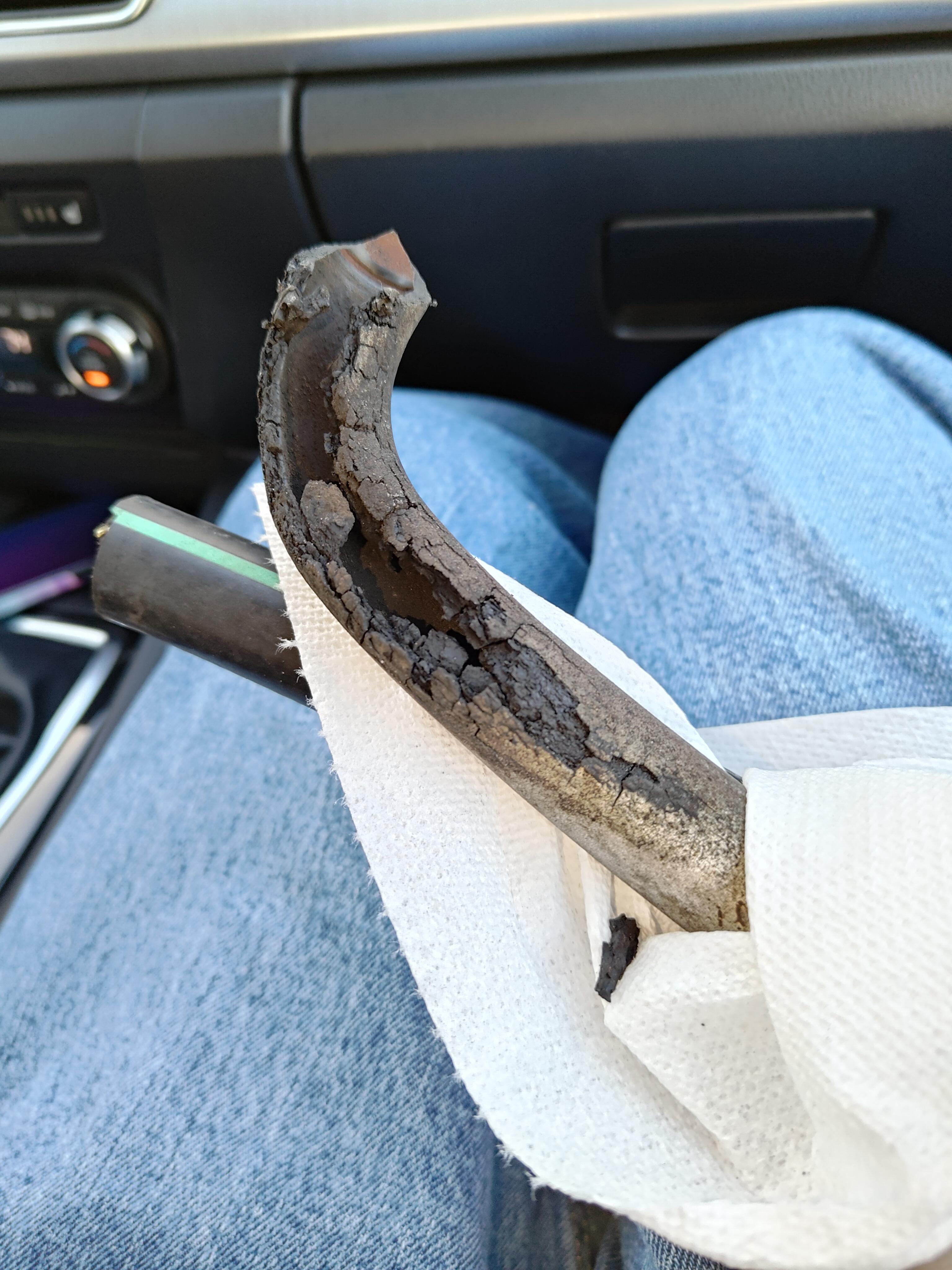

Well, It appears I had a lapse in memory.
The receiving end of that bung does indeed point out to the side and not down.
The replacement hose looks to be out of stock. So I'm off to source a brass coupler and a 1" hose to join them together.
Also, I included a picture of just what that hose looked like coming off the car. P_20240304_173521.jpgP_20240304_173649.jpg
