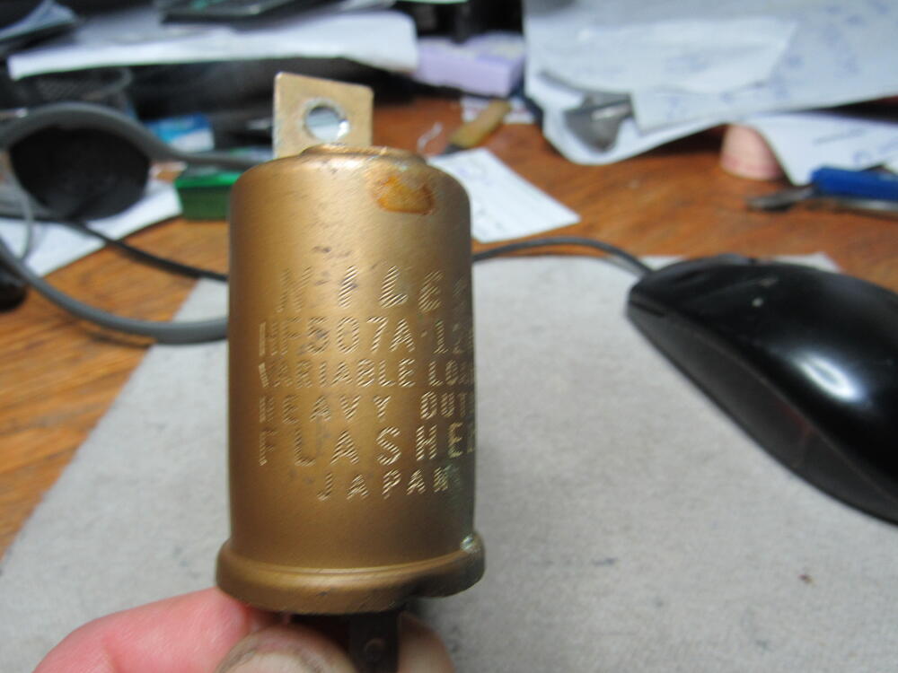

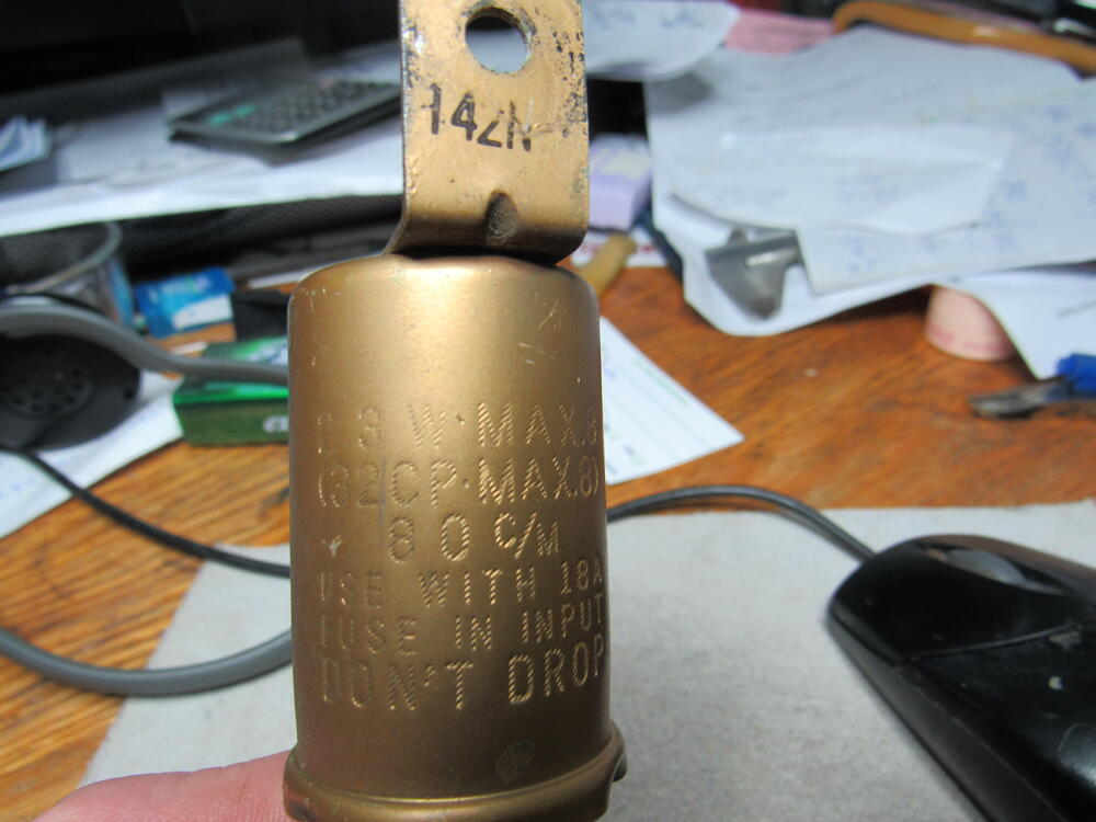

Are you using a two wire or 3 wire flasher relay?  A link to the part or part number would be very helpful. As for both sides flashing when moving the turn signal stalk, has the switch been rebuilt? That could be the rocker in the switch not being bent at the correct angle.
2 wire flasher unit. Part number for flasher?  I dismantled the switch today, cleaned everything, there is only one ball bearing in that switch and nothing looked bent or out of shape.
