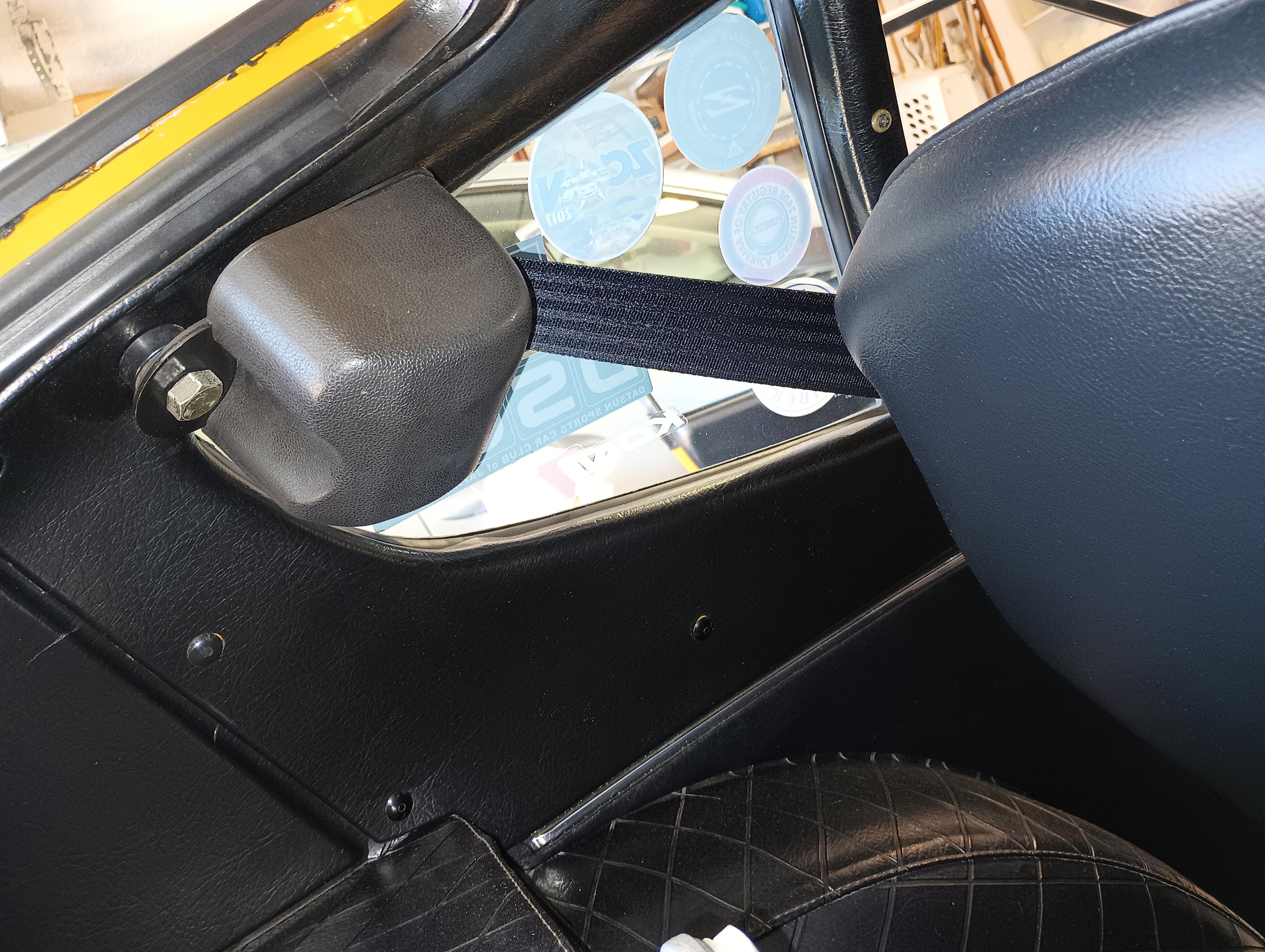

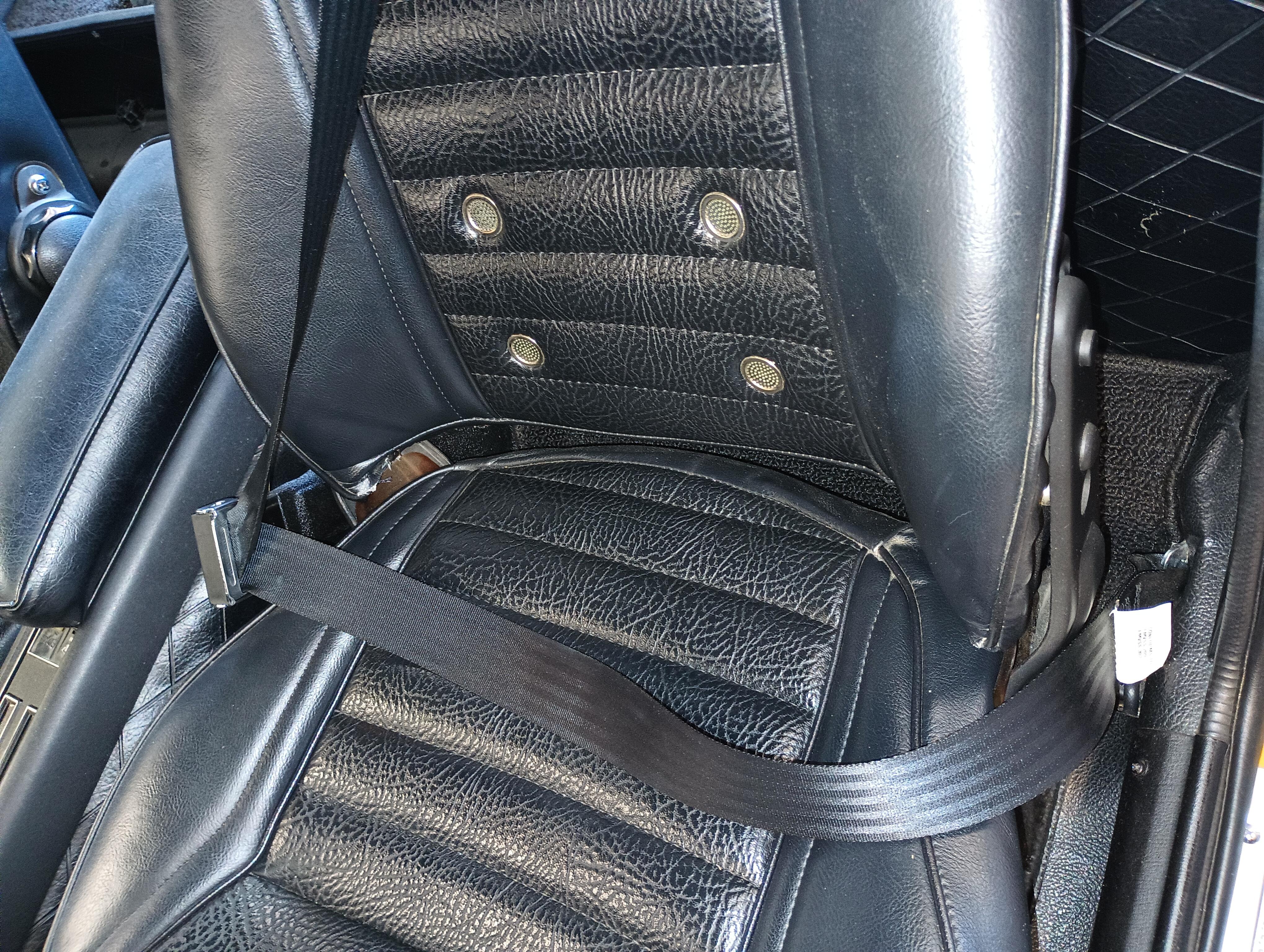

This is the Roadster Retractable 3-point belt from Wesco, a very comfortable belt.
The retractor is mounted at the original shoulder belt location using the OE bolts.
The lap belt also uses the OE bolts and locations.
Here is the website and belt details. If you order, specify the 11" rigid sleeve.
https://www.wescoperformance.com/noname.html
