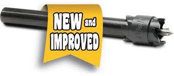

I like the spot weld cutters like this

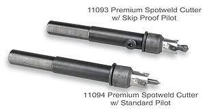

or this
I do not like this style
A little oil helps. Be careful with the bit corners, they are brittle and easily damaged. Constant pressure helps. The carbide or specialty coated ones last a lot longer.
