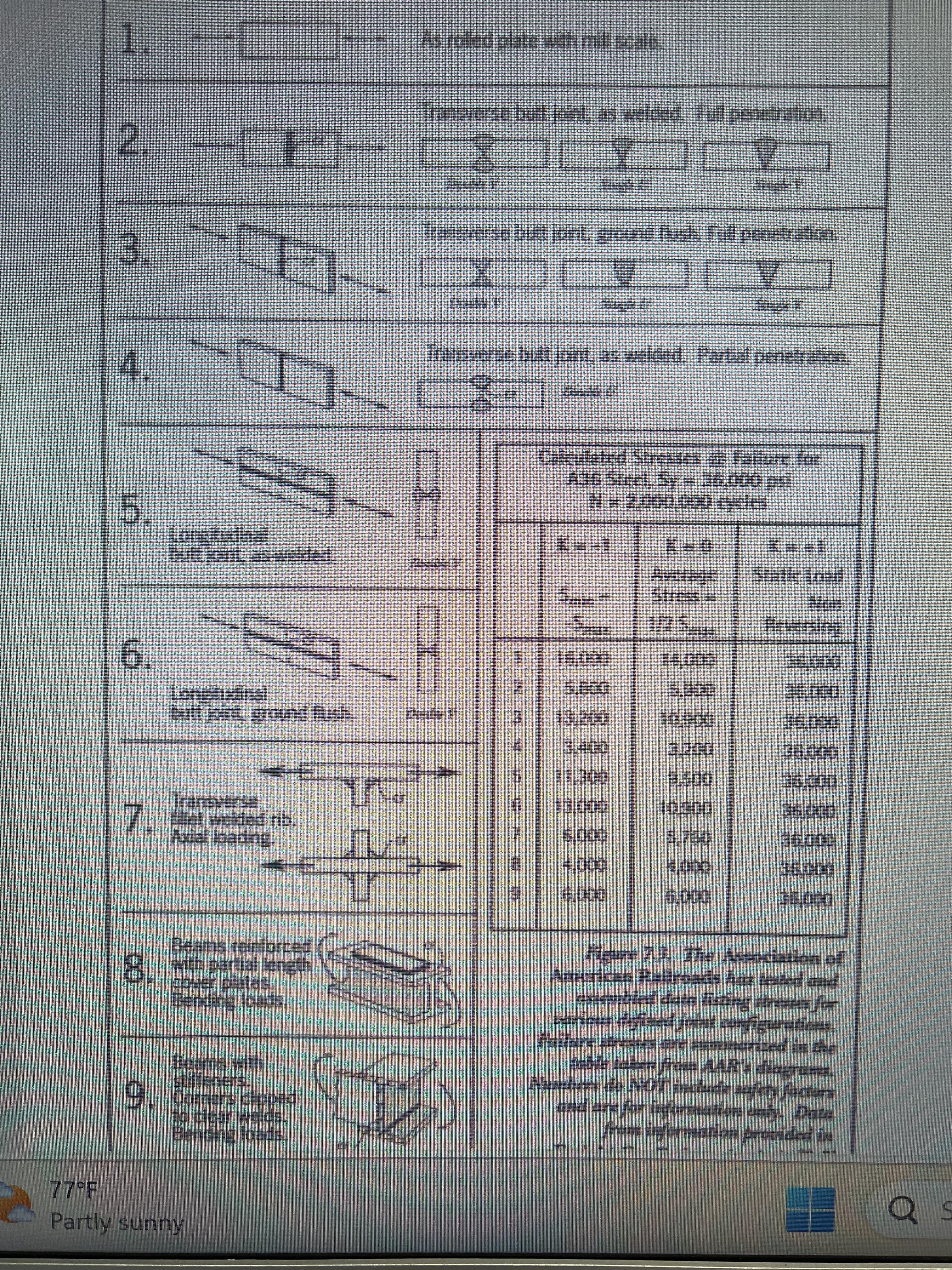

      Looking at this chart, that may or may not be applicable, it would seem a properly butt welded/ground smooth joint retains 65-75% of its original strength??5FF1A78E-F01F-4EE3-AE05-370191FF6B94.jpeg

Given the critically of the shock tower, and stresses of suspension, I’d go with plug welding the entire tower over butt welding the upper and lower pieces. Just my 2 cents..
Agree. Those weld failure numbers appear to be premised on the joining of thick panels ('plate'), where lateral alignment of the joined edges isn't terribly critical.  For thin automotive sheet metal, it will be difficult to achieve good panel alignment along the entire length of the seam.  Even a brief segment with poor alignment will become the weak point that invites failure.  There's also the potential for low-level burn-through, again resulting in weak point(s).
Those published failure numbers are also premised on a steady separation load ('pull').  The weld in the shock tower will be taking variable loads (combination of spring load and shock absorber loads) that include the potential for big peaks if/when the spring bottoms out (the load curve will be high-amplitude and brief in duration, so quite demanding for the structure).

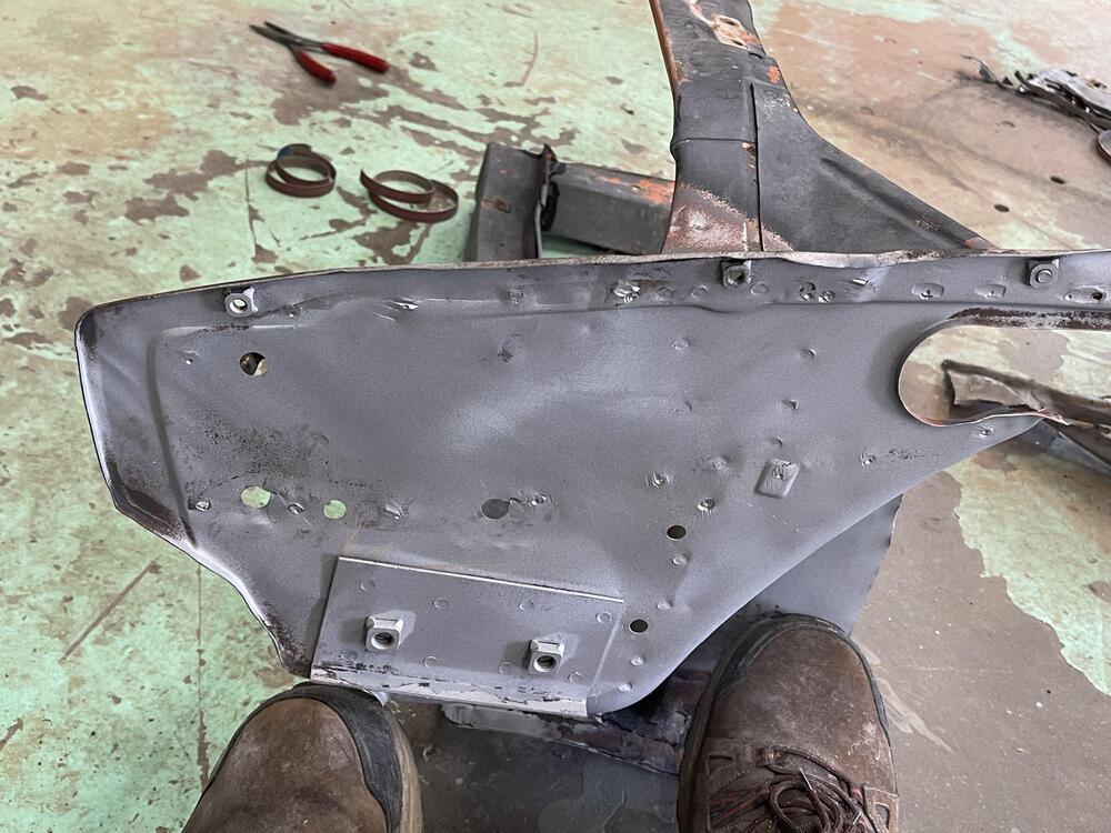

     Before abandoning the original metal work, I’m heating/dolly the metal to try and get back to original shape, first run through, smoothed out virtually all of the “marks” in the inner fender…..   fortunately, I have access to a nice “tip of inner fender, “?    The section that is adjacent to headlight “scoop”.1495F7A2-AE80-4BEE-B133-12D6536B79FF.jpeg6051A480-3CD3-4800-835D-65840B94F483.jpeg
Looks like I’ve found a nice doner peice for the left side inner fender extension?  Where both bumper and headlight buckets attach.
   Will continue to for now avoiding the entire front F7BB3669-BDD6-423F-8346-36AB00CF05C6.jpegclip replacement

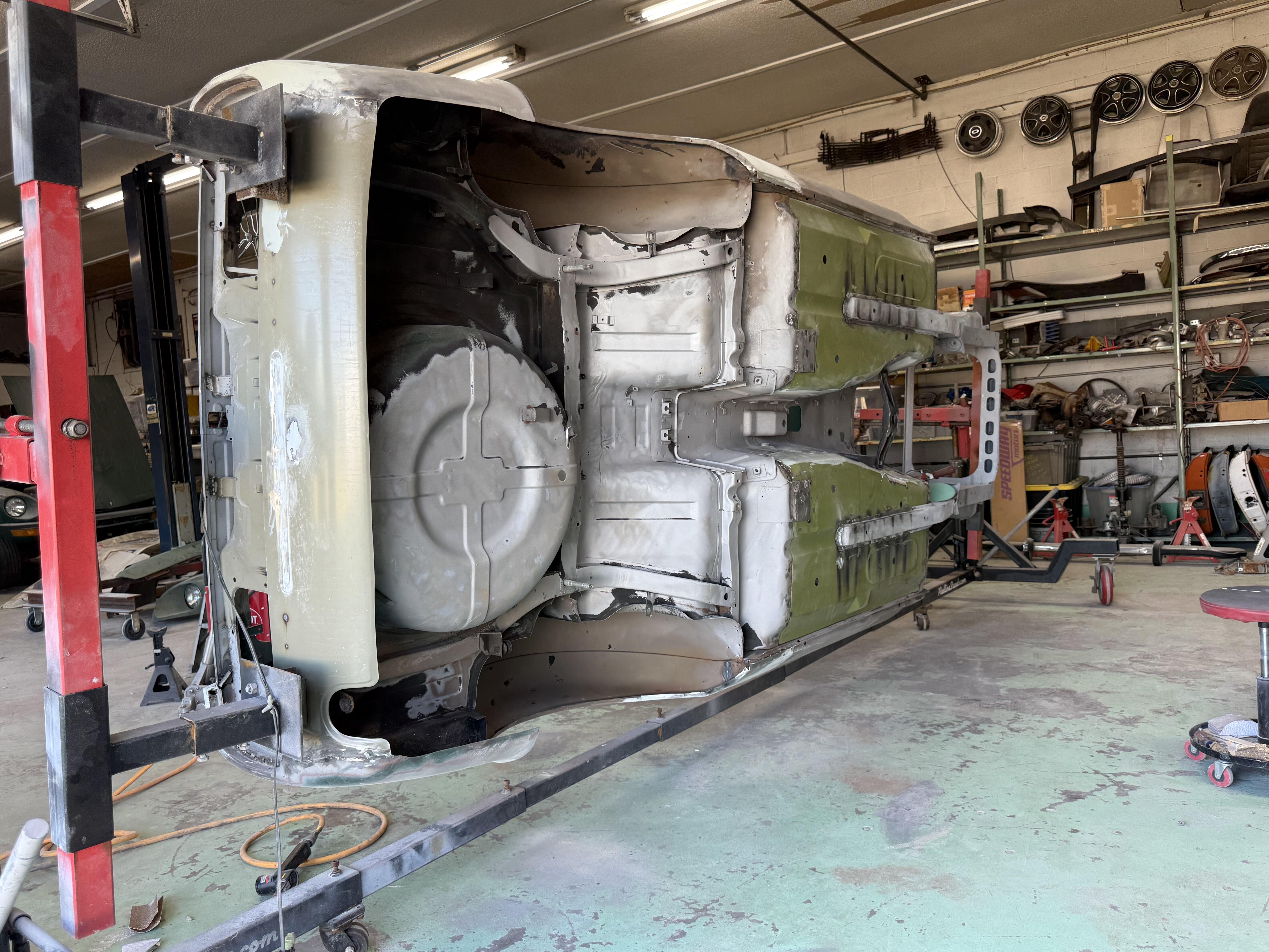

IMG_0088.jpegProgress finally being made on 51, up on rotisserie with new rails, floors, front clip, rear valance, dog legs, sections roof, and roof rail replaced, repaired.  3 weeks in with a couple of retired body men, that are definitely up to the task!!

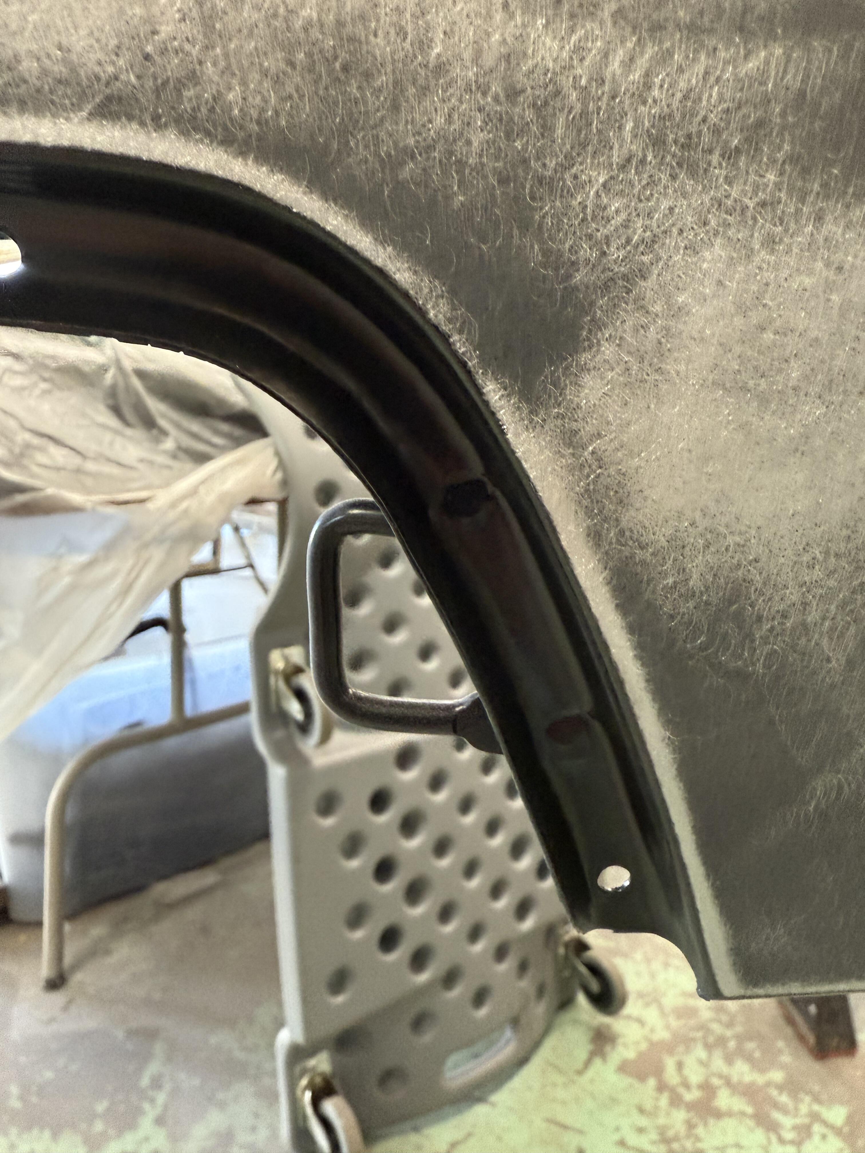

IMG_0085.jpegIMG_0087.jpegEarly fenders inspection lid tabs are slightly different with metal versus plastic clips.
     I’m sure most know of this, but I simply had not noticed that and other differences in “early 69-72”?    Fenders, nos fenders will have to be made right, but definitely another  3-4 steps to take for each fender to be right….”look” right.
