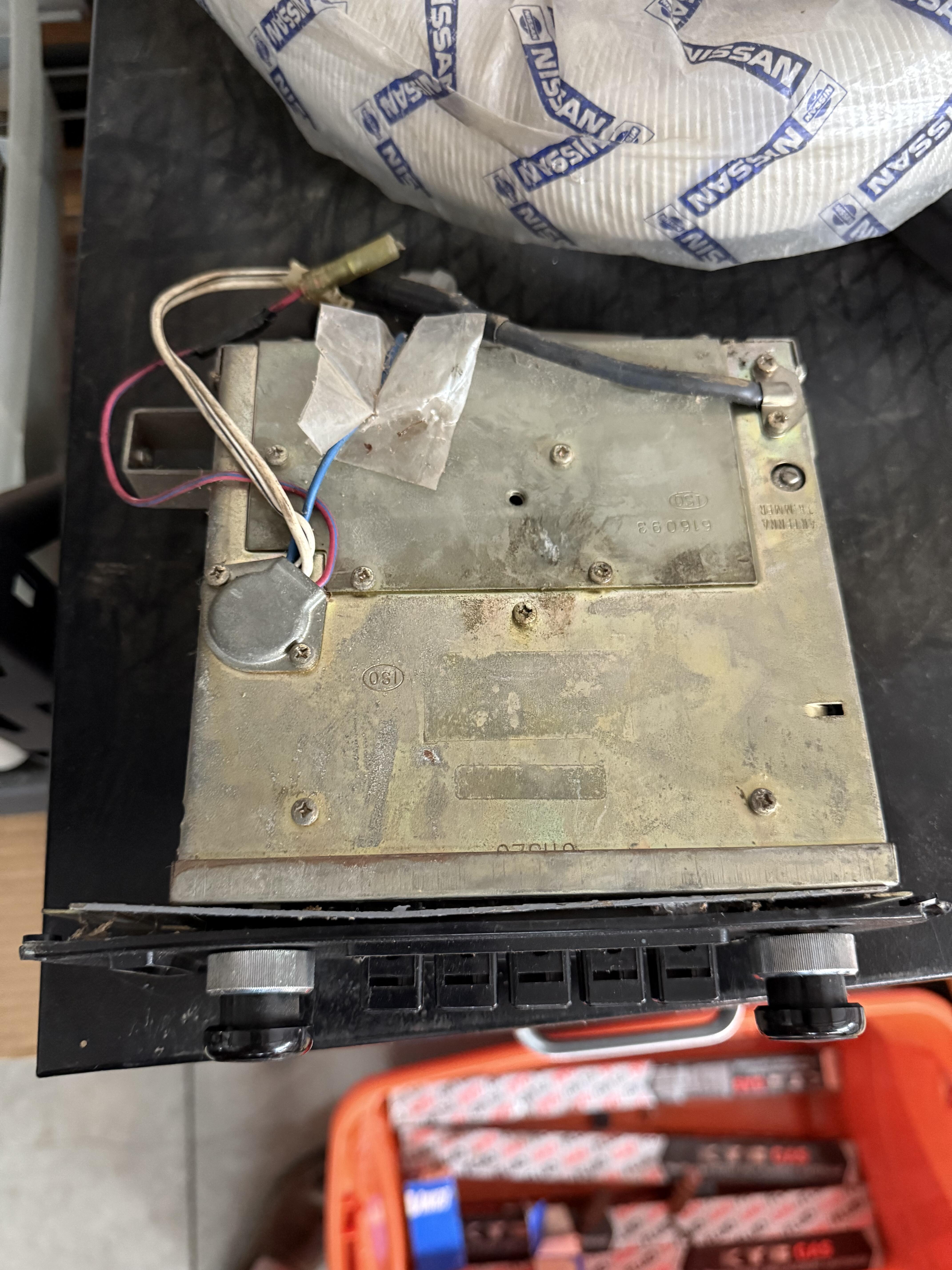

And back to radios and red dots. I have about 10 early AM radios I collected over the years, 9 of them have the green dot, and 1 of them has the red dot. I recall @katsand I discussed the red dot and what it meant, but I don't think we ever came to a solid conclusion. My guess is that my red dot radio (which I got off eBay North America) was from an early 69 build 240z, but I have no way to validate that.
Thank you for that information Gavin,  digesting evidence and coming up with Nissan intentions for a “press car” without written records is hard to make it make sense 50 years later….
       The combination of the red dot radio,and the captured nut for the flat hood bumper at first glance to me was a glaring contradiction.   Was there a red dot rear view mirror on the hs30-00004 car.    But all of these items could have been added or modified in the past 50 years as well.
         It is a special car no matter what….

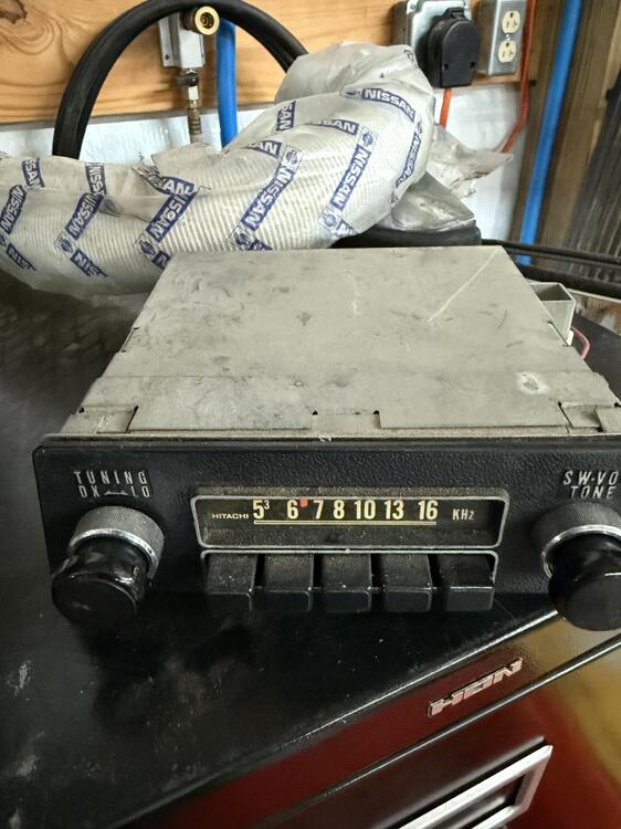

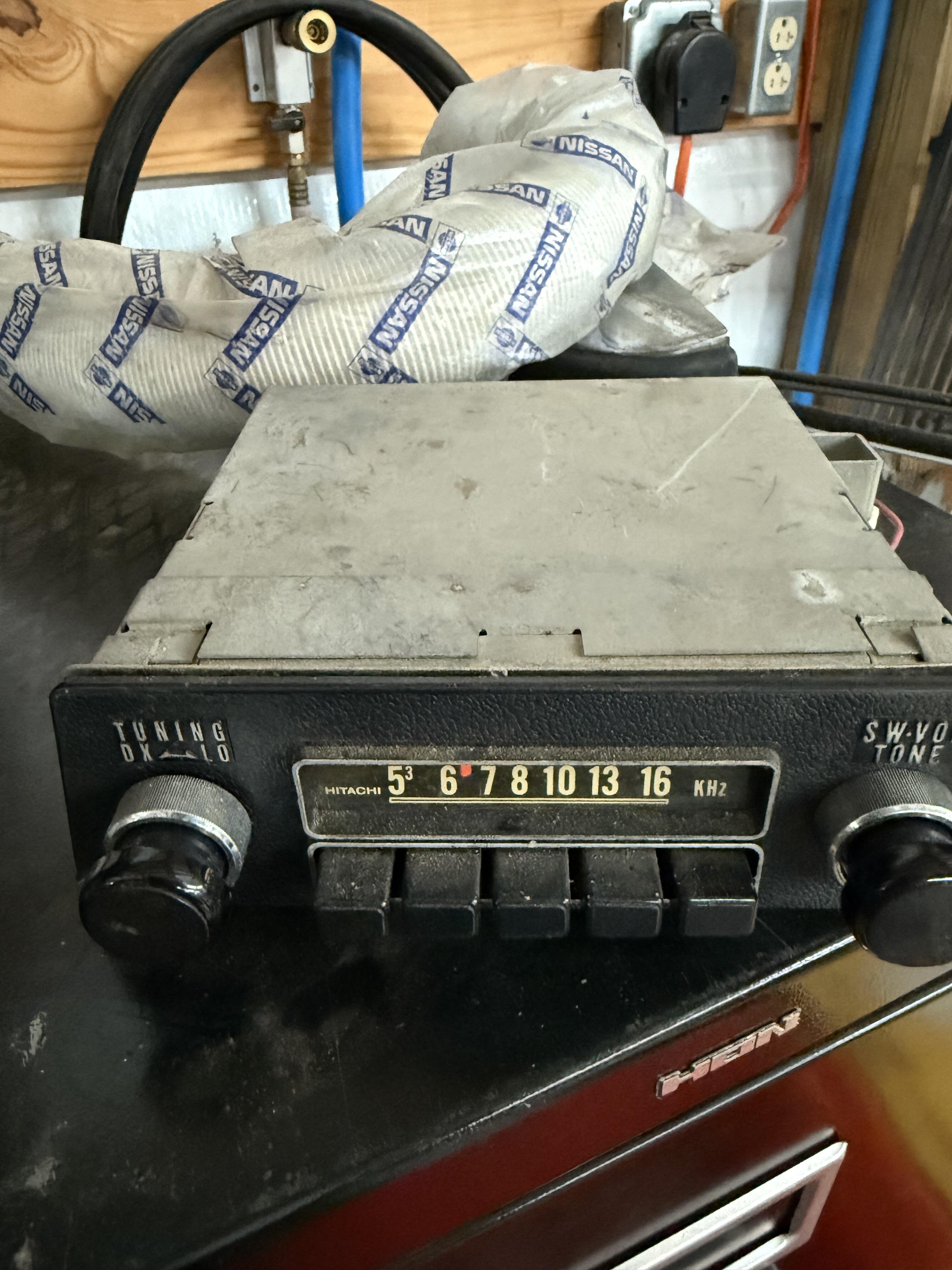

A known z parts specialist nudged me gently,asking me if my hls30-00051 had the proper red dot radio…. Well, just not familiar with the early RDR.       Looking through my am radios 1 of 5 happened to have red dot instead of the green dot……    Surprised to have this “rare” item in my stash.     IMG_0157.jpegIMG_0161.jpegIMG_0160.jpeg

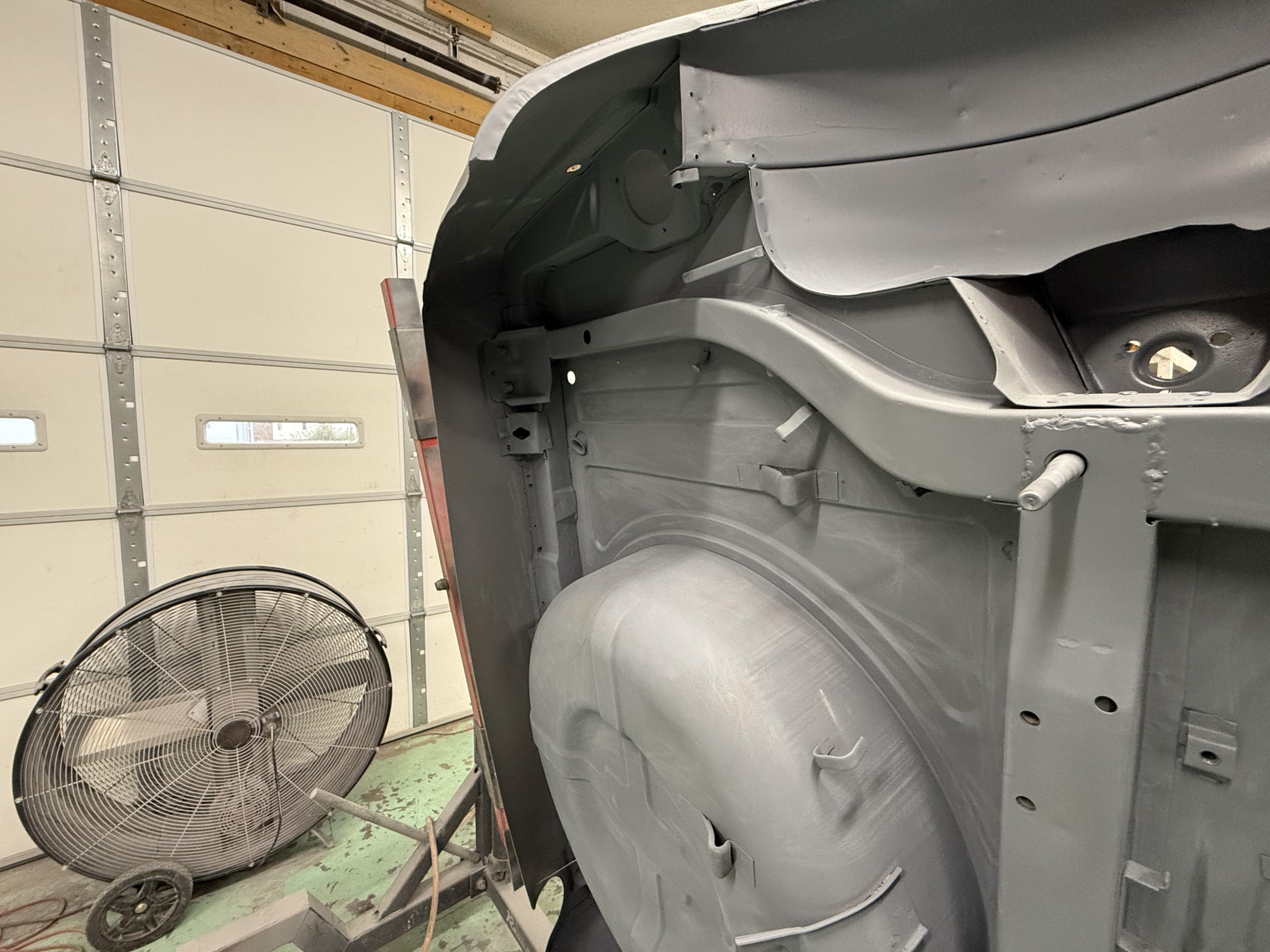

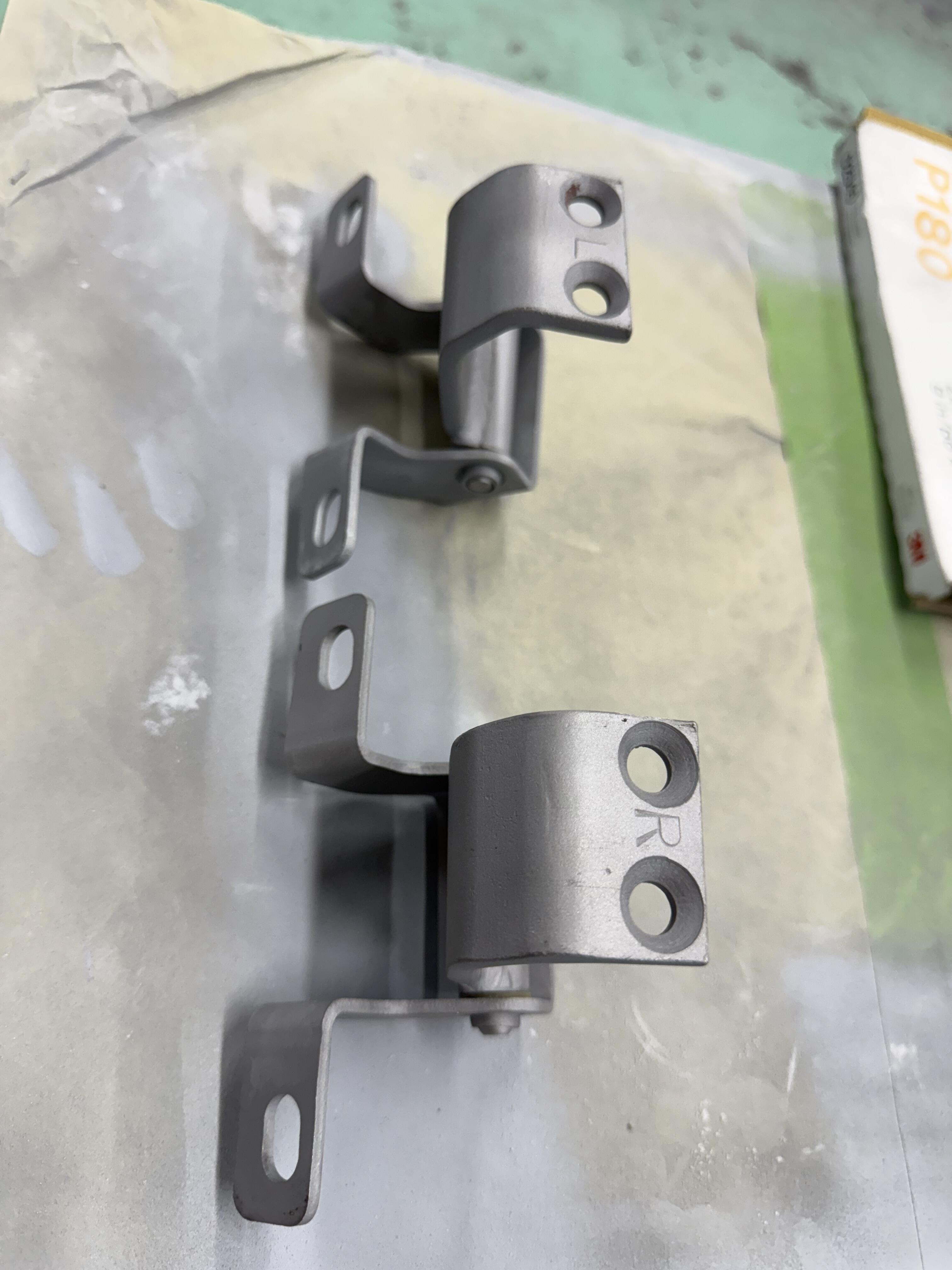

Sanding and blocking still happening. Getting slick…..  After a frantic search  found my somewhat fragile hand throttle cable bracket that had been knocked off when pulling a part the dash/ steering column.
Cleaning and blasting a few parts,while the body work/prep continues.   Hinges and latches etc…… hatch hinges turned out  virtually perfect.     Assuming these hinges are original to car because as mentioned earlier, hatch with old gasket contained the 9/69 dated clear glass.

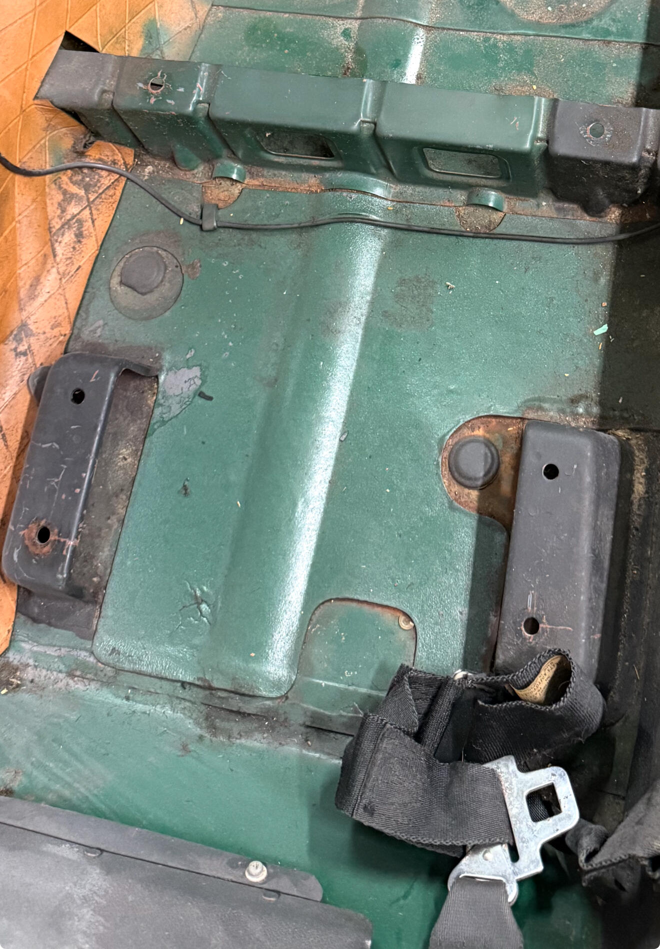

Seat brackets appear to be hand painted, wavy lines, thick black gloss?  Brushed, but no bristle lines…..??  No overspray .
       This is in 3/70 car , I’m hoping  same paint pattern applies to August/september 69 car.

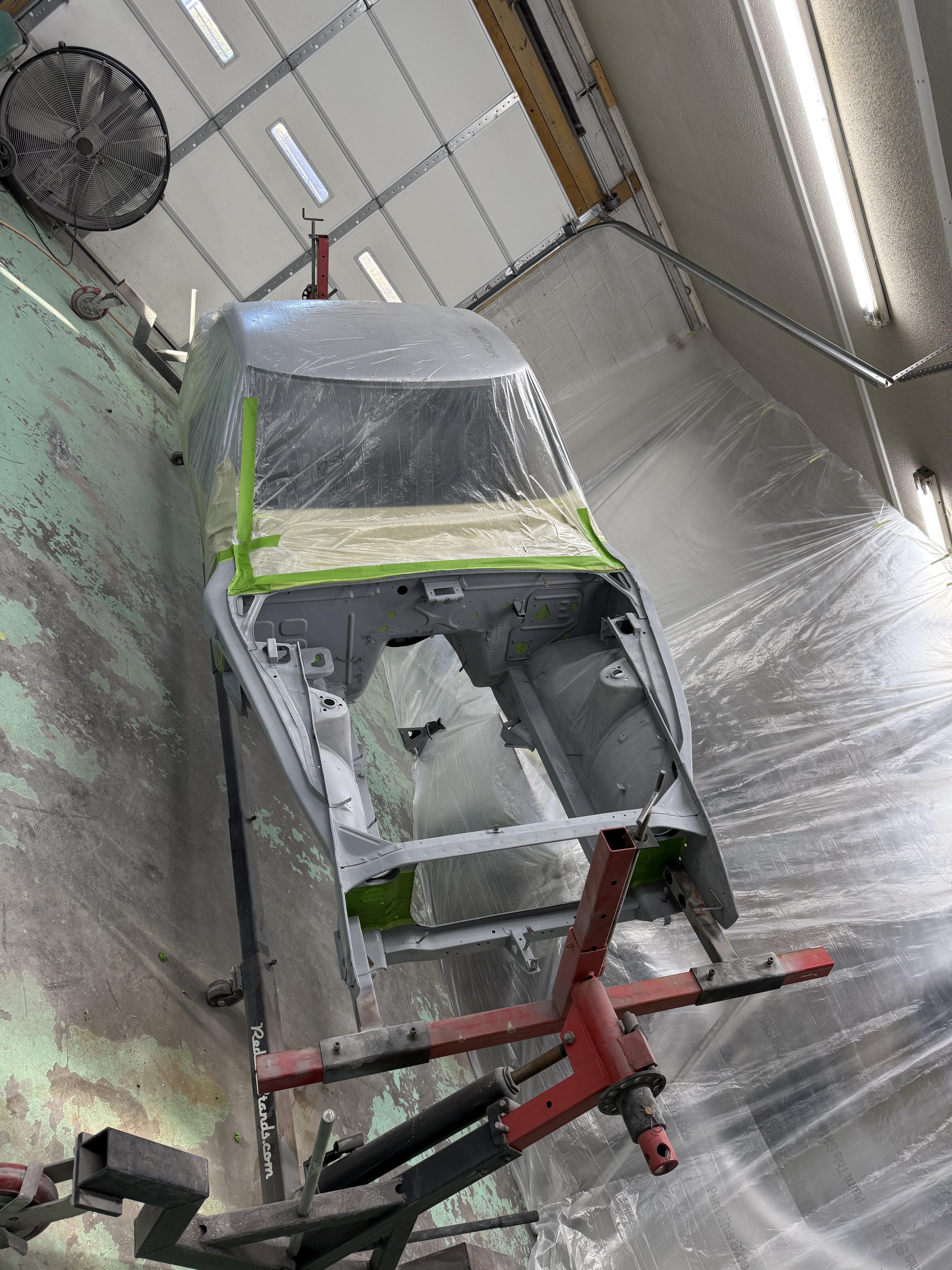

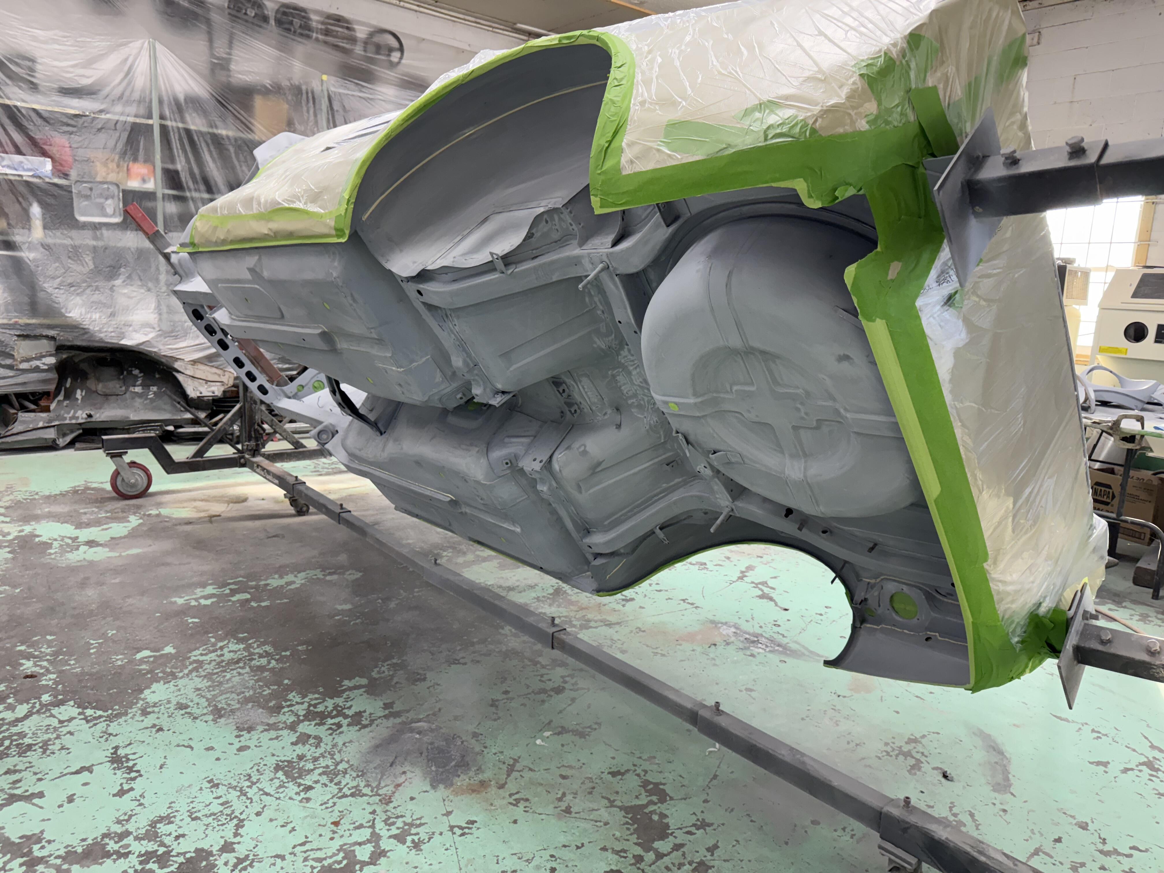

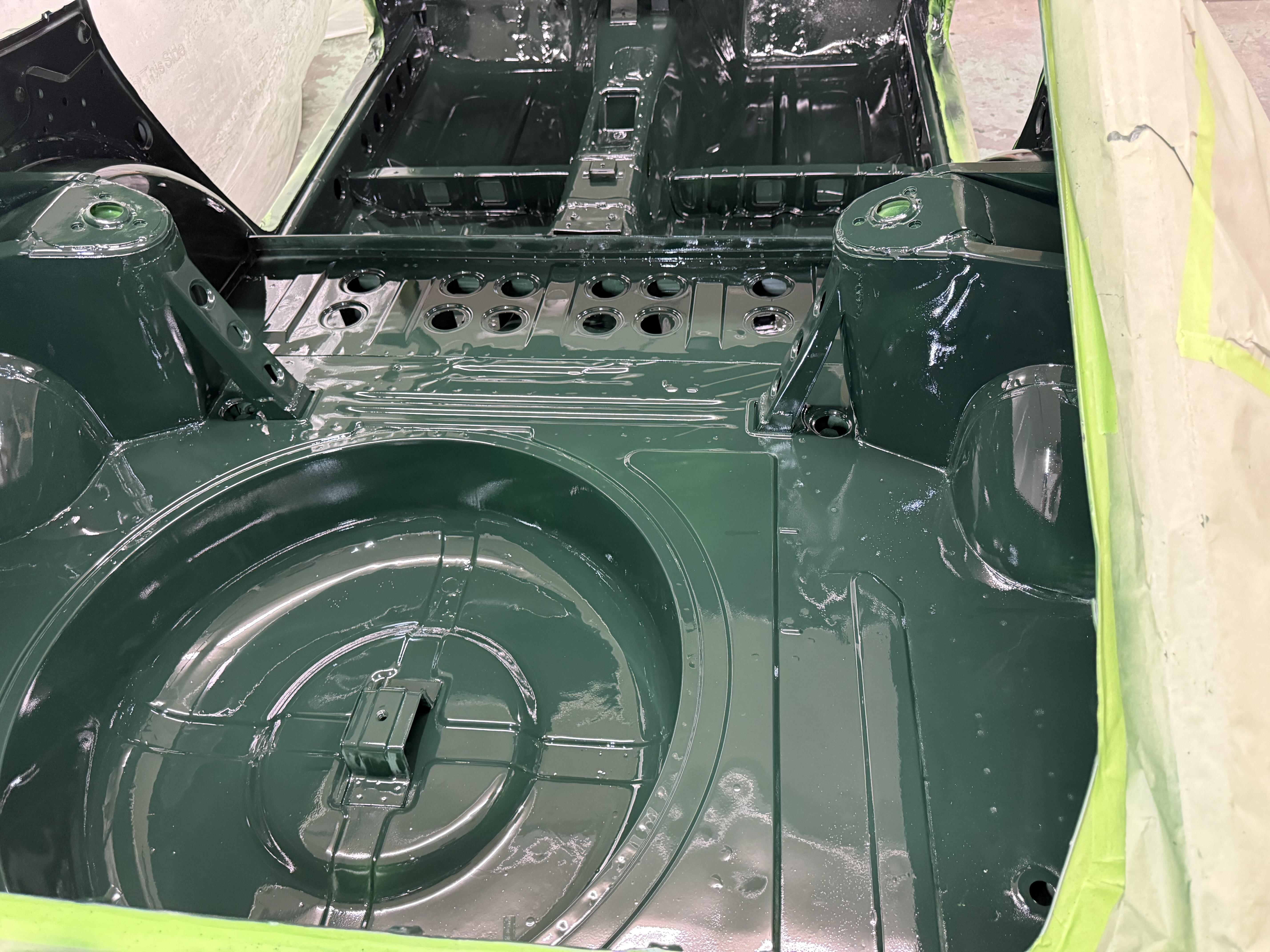

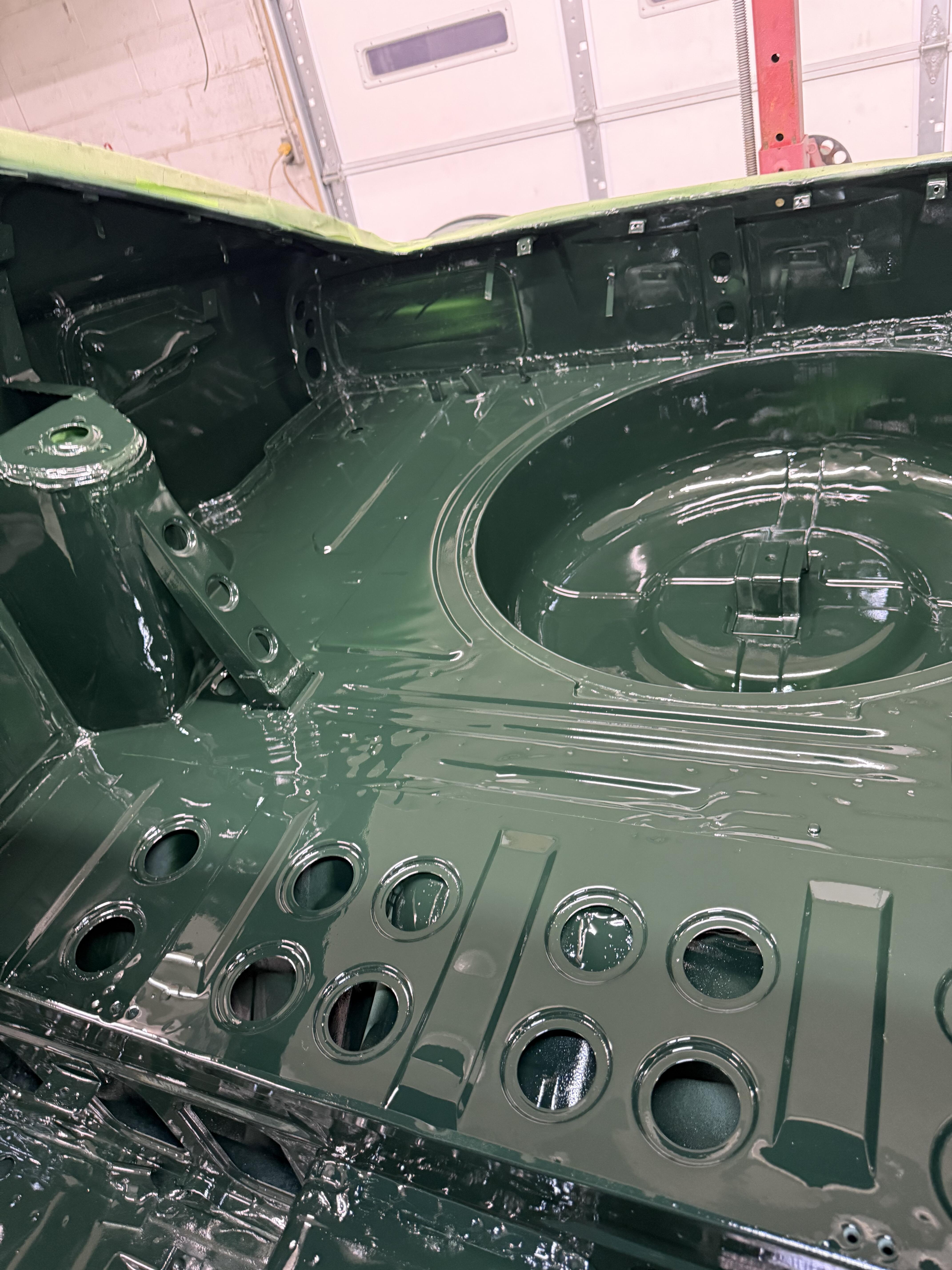

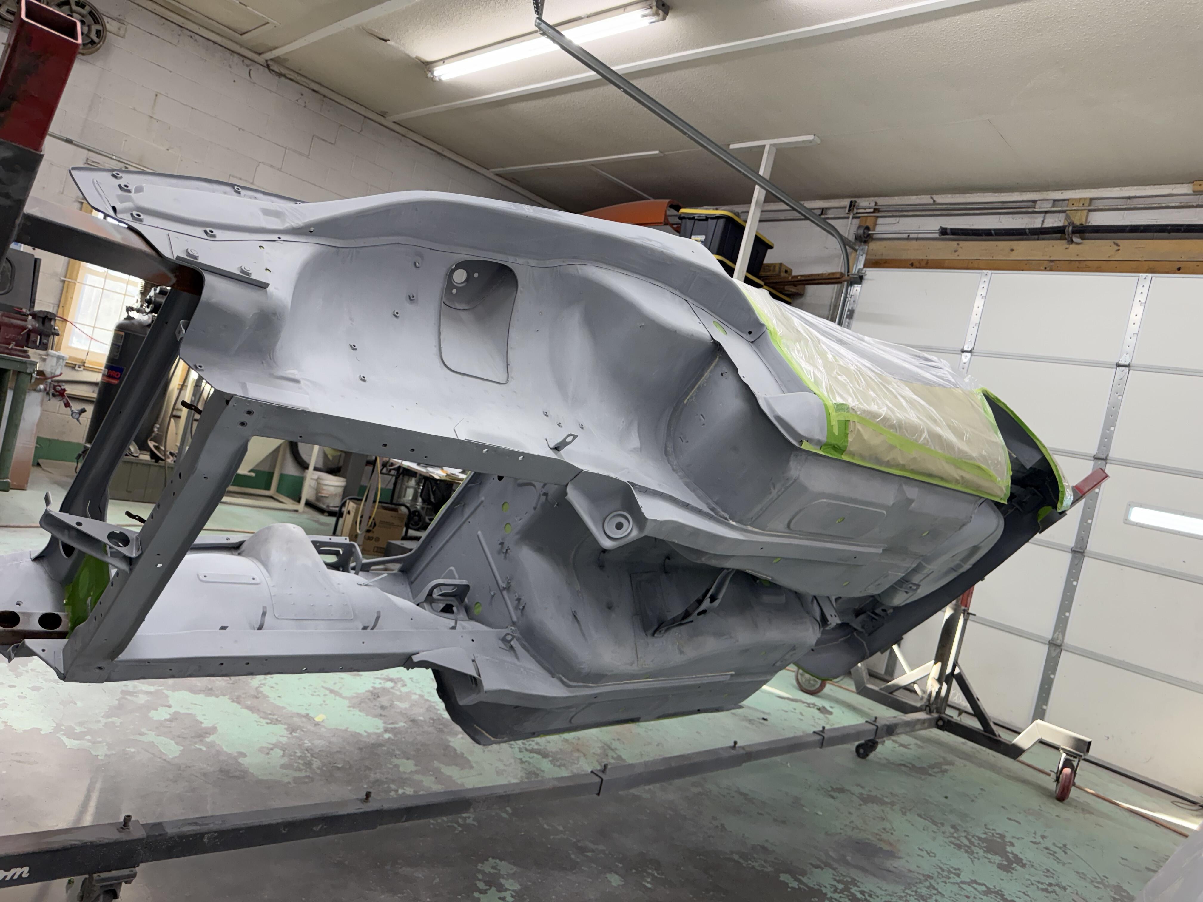

    Plans are to do paint only on underside of car.  Will evaluate cosmetics once paint dries…..

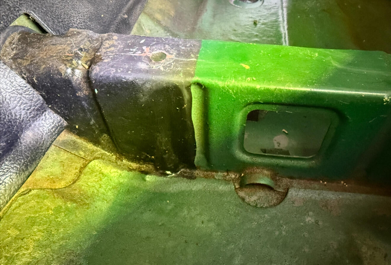

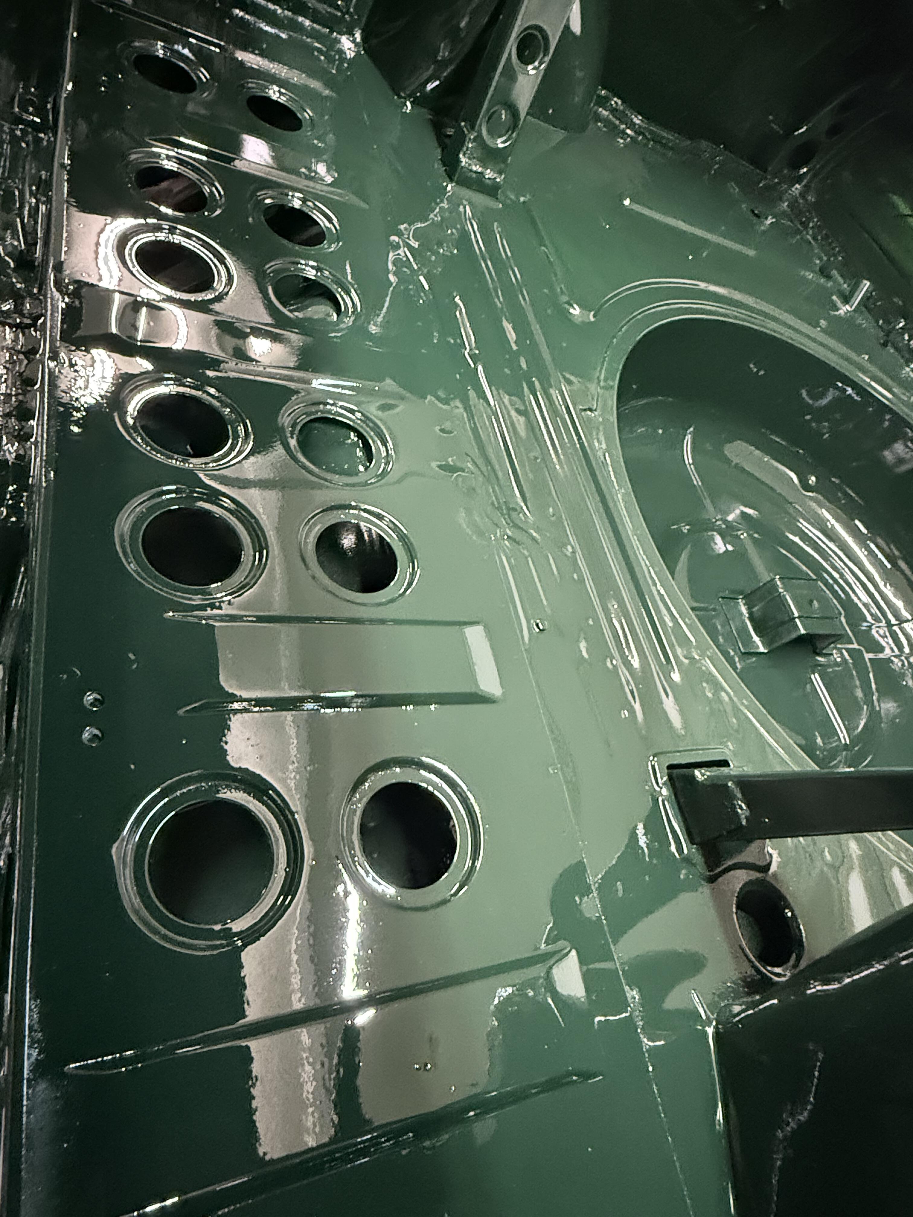

Such a dark green in contrast with thick undercoatingIMG_0277.jpegIMG_0278.jpegIMG_0275.jpegIMG_0273.jpeg from before.
     Looks much darker then anticipated, but poor lighting I believe is causing darkness….
     Have a few places to touch up, maybe another coat or two, couple of runs, couple of trashy spots in the paint to sand out and re-shoot….   Still spectacular in my book…. Not perfect by any means… but sweet to see the bottom side in color.!!IMG_0270.jpegIMG_0269.jpegIMG_0266.jpegIMG_0263.jpegIMG_0261.jpeg

    She’s looking better with a couple more coats on, along with some redoing of trashy spots….. Still not perfect, but so sweet to compare how far she’s come…  many moons ahead…..left to wander.
