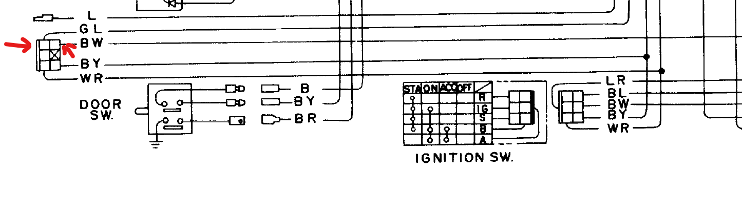

Wondering what, if any, issues I may have with this swap electrically. I've done this many times for 240Zs I've owned, but am unsure what other functions the ECU manages on a 280Z that I'll have to work around. I plan to manage fuel pressure with an inline regulator to compensate for the difference from 3-5 lbs. (carbs) to +30 lbs. (injection). Thanks for your help/thoughts.

Jumper these two wires together by using an inertia switch. Mount the switch securely to the dash. That will provide power to the fuel pump at key ON. The switch should cut power if you have an accident.
I think the 6 pin connector is different from the one sold at Vintage Connections. I used some that I purchase on Mouser.com. Sorry, part number for the connector isn't readily available.
If you want to get an non-generic inertia switch, you could get this: https://www.rockauto.com/en/moreinfo.php?pk=3970509&cc=1427576&pt=10756 and pair it with this connector: https://www.clipsandfasteners.com/Inertia-Fuel-Shut-Off-Switch-Harness-Connector-p/a23180.htm?gad_source=1&gclid=CjwKCAjwz42xBhB9EiwA48pT73NwDLlIv8yJGuM8TKHISt7fAUw23HCsEvFF2M9k7Fhdvmvwe0MfPhoCoIgQAvD_BwE
You would want to fashion a bracket for it, though. Since it has normally open and normally closed contacts, you could wire it to a light to tell you if you need to reset the switch if it has been activated.
