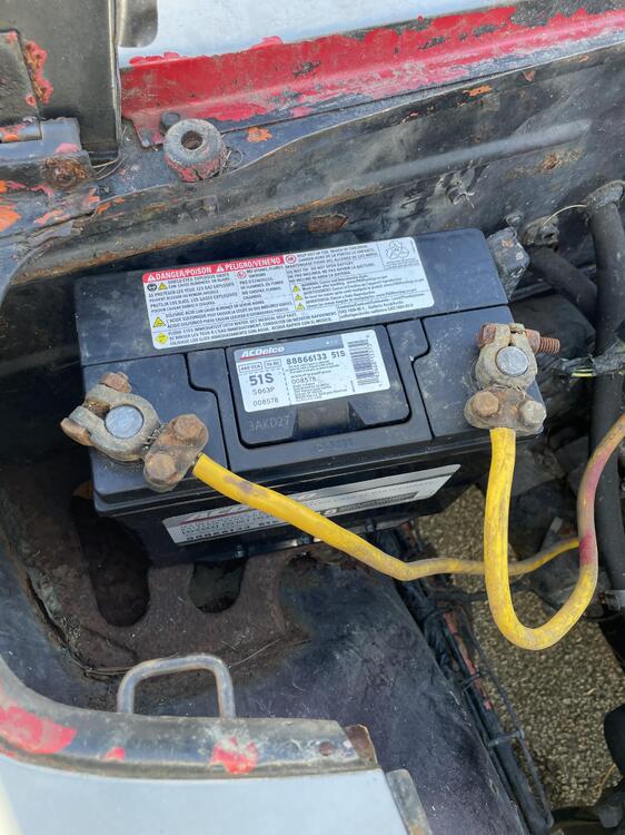

My thoughts were that I don't see a chassis ground off your battery. Negative should go to that bolt in the firewall behind the battery. Cleaned up of course.

Does the battery need to be grounded on the firewall? I have one ground going to engine block.  As seen.
Second line in my post. The motor and transmission are rubber mounted.
  • Agree 2
Yes for all the lights and other things to work that need a chassis ground, but not for your problem, the ignition system grounds though the engine block. Which brings up a good point, if you don’t have that firewall ground connected and are measuring for power your ground for the meter must be connected to the motor somewhere.
