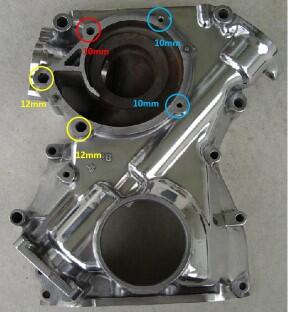

6 hours ago, Patcon said:
The toughest part of doing the water pump is getting the old bolts out without breaking them. Some of them are long and skinny. A little corrosion makes them difficult to get out.
Recommend that you use an impact driver* to free up the bolts.  To gain the required access, you'll need to drain the cooling system and remove the radiator.
(* Do not use an electric or pneumatic impact driver.  Use the good-old-fashioned, hammer-blow type.  It may take a bit more time and effort, but it prevents overpowering the bolts.  A high-torque power impact driver will snap those long bolts just as surely as you leaning on them too hard with a wrench.)
Here's a picture of what you'll be working with.  The numbers refer to the wrench size...
S30 Engine - Water Pump Bolts.jpgx
The pump is secured by a total of five bolts.  Three of these also help to secure the Timing Cover to the front of the engine block.
  • The small-head bolts at 1 o’clock and 4 o’clock are short and  thread into the cover – M6 (10mm wrench)
  • The large-head bolts at 7 o’clock and 9 o’clock are long and fat and thread into the block – M8 (12mm wrench)
  • The small-head bolt at 11 o’clock is long and skinny and also threads into the block – M6 (10mm wrench)
The long, skinny bolt @ 11 o'clock is usually the one that snaps off when removing or tightening.  The rad, pulley, pump, and the timing cover will all have to come off to get the access needed to extract the remains.  Removing and reinstalling the timing cover will open up the potential for oil leaks where it meets the oil pan.
In other words, there's going to be a high price to pay if you snap off one of these water pump bolts.  It doesn't need to happen... but it very well may if you try to rush the job and use too much tool and not enough caution.
