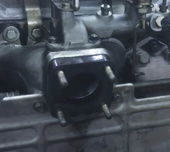

This guy put a whole Youtube video guide together and apparently the nuts are so easy to remove it's not worth showing.  7:45 they're there, 7:50 they're not.
Yo yo yo dude, the mounting holes are in the same spot on the manifold.  Nut on a stud, hex head screw, whatever.  Put an open end wrench on it and turn it.  Counterclockwise.  Just like the guy in the video.  Word.

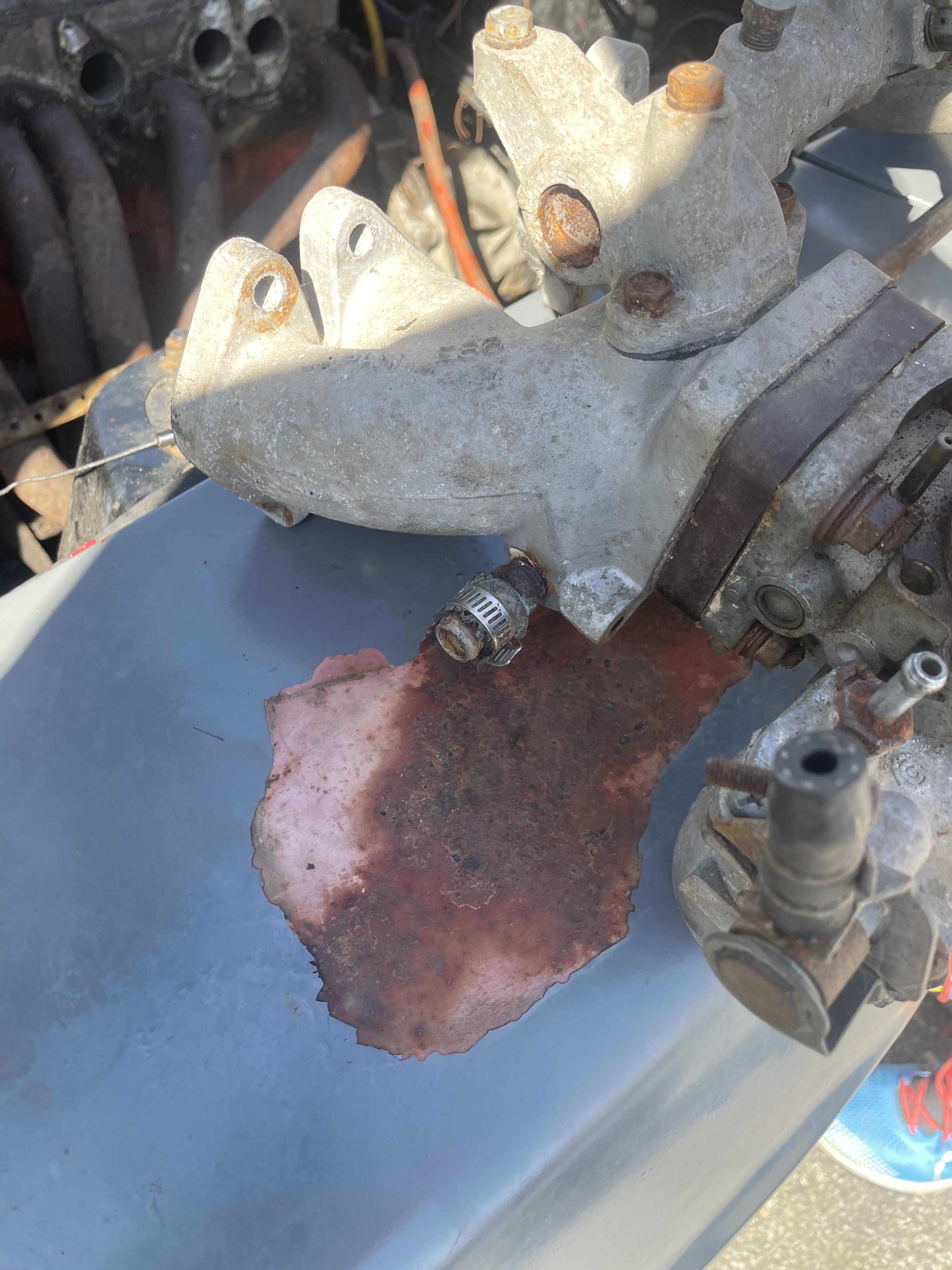

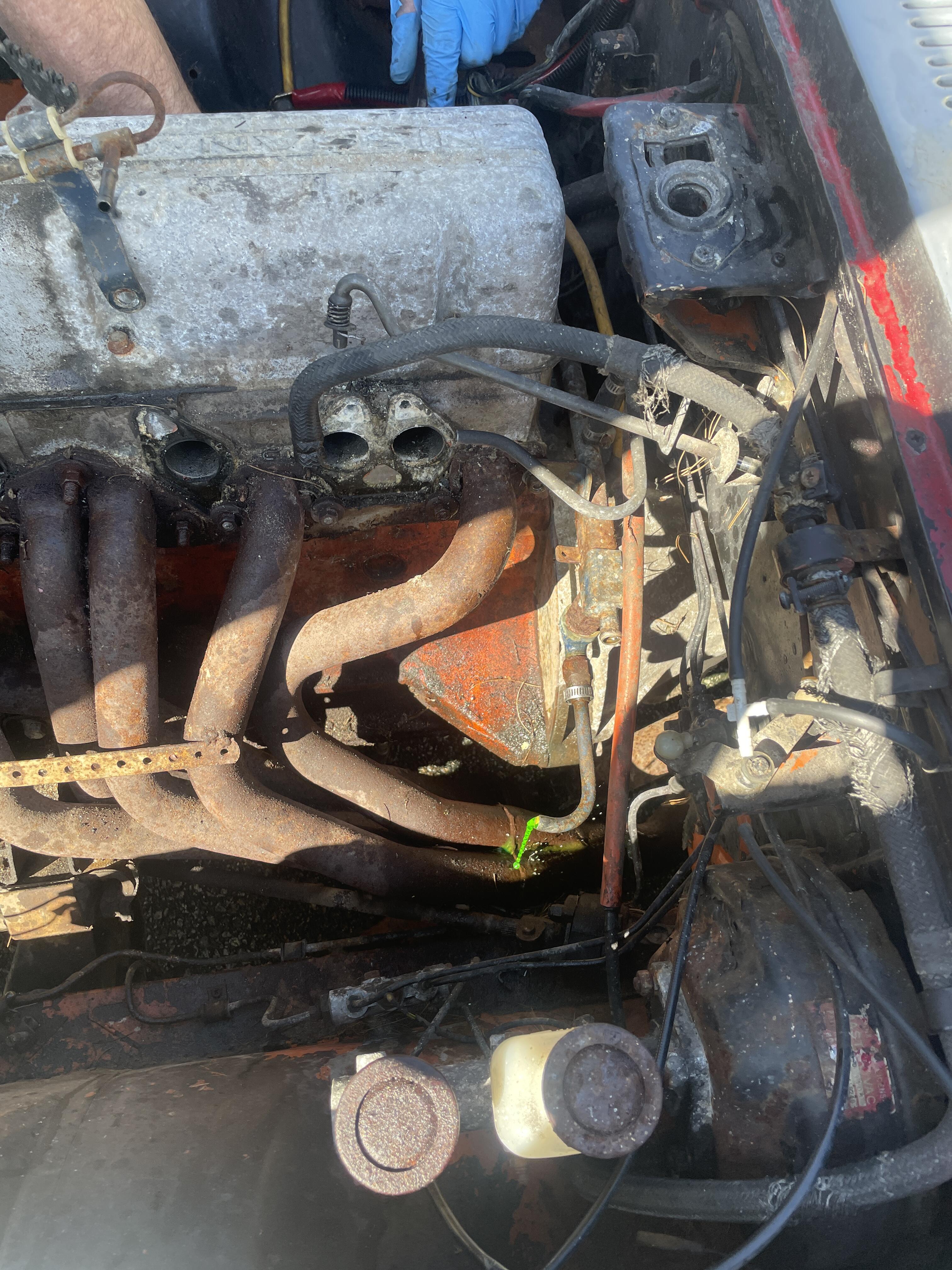

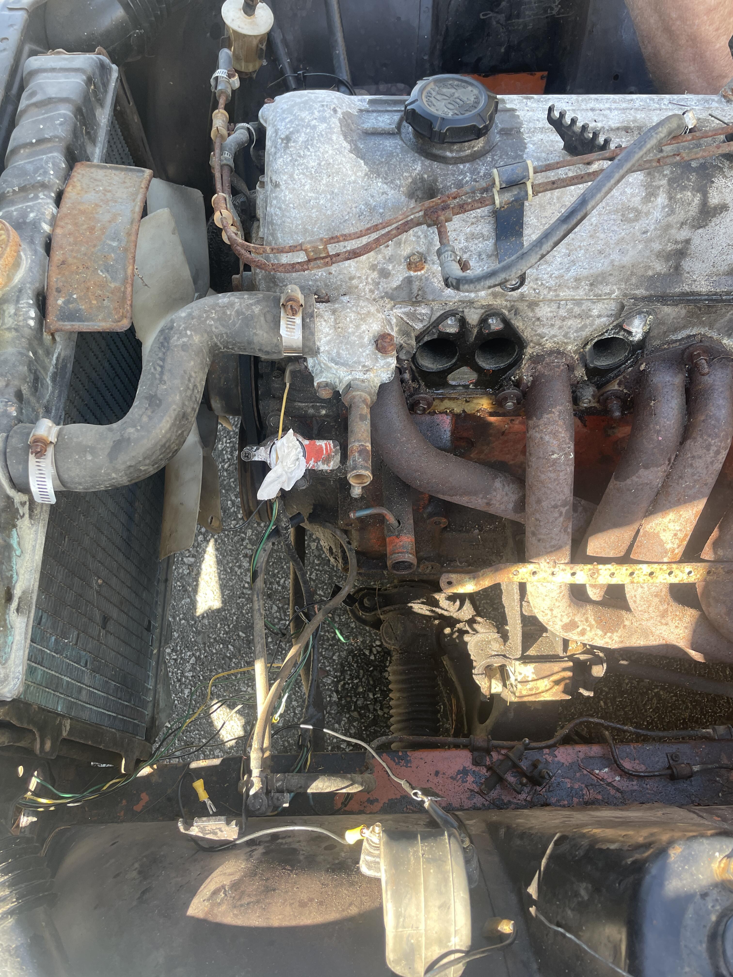

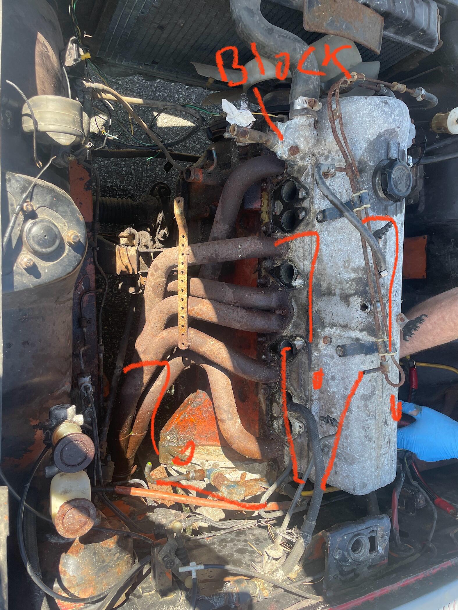

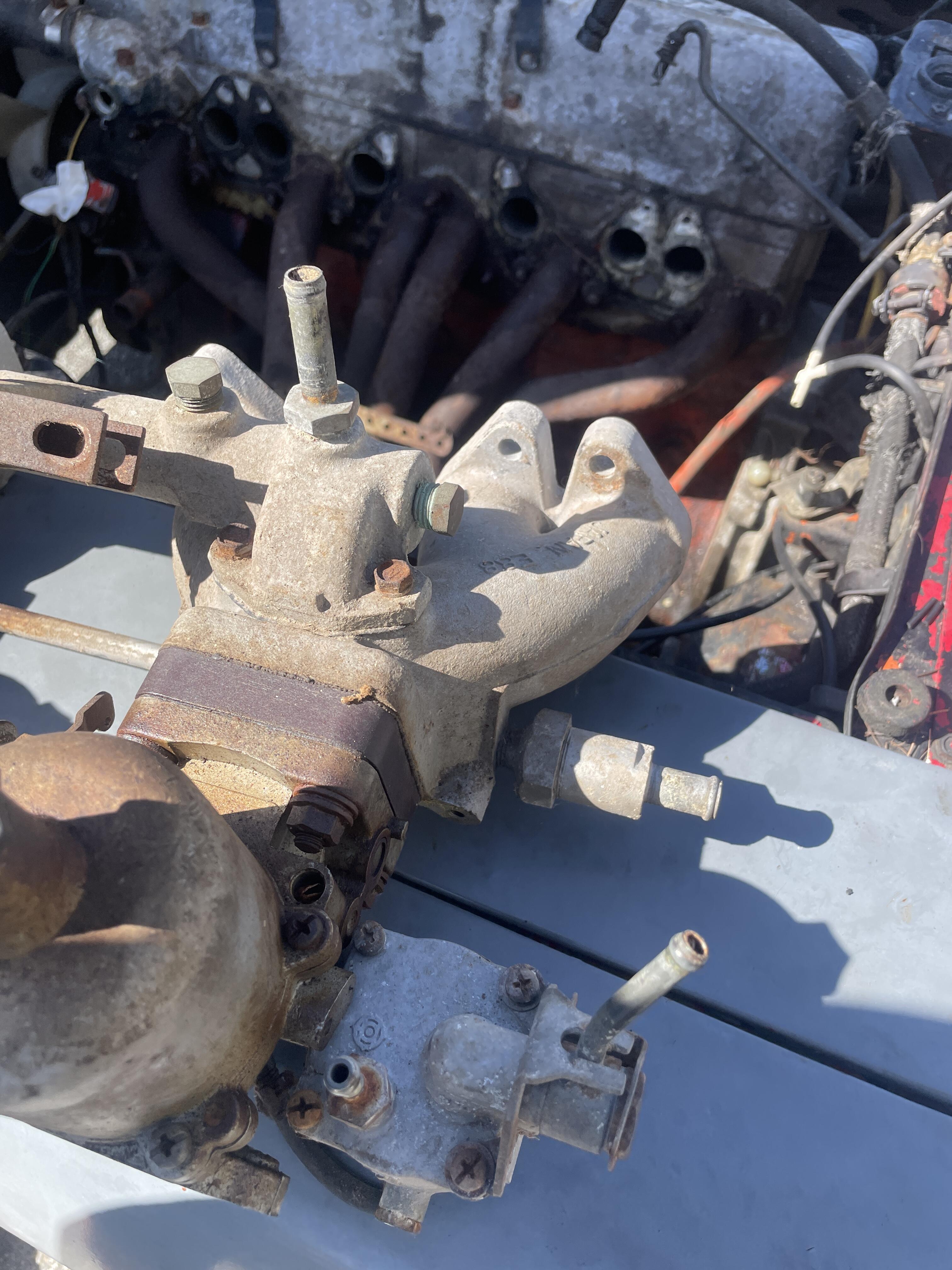

We have now removed the flat top carbs. We literally would not have been able to get them out unless we ground off several bars and pipes. They are now pit as seen in photo.  We just need to know what we have to plug now and what has to go back.  We are putting in the standard su round top carbs.
