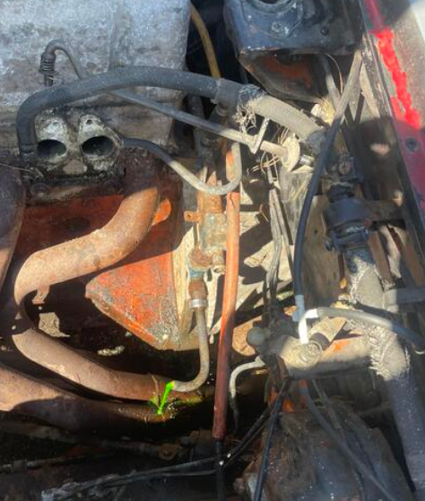

Yes. We have another manifold attached to the round top carbs. We will just put the whole new manifold on.  The last carbs were dine and most people say to go with the round tops. The main questions are which lines can be eliminated.  ??  Can someone point that out in a photo?? Why tons of work. ? The new manifold bolts right on then it’s just the hoses.

Fuel rail has to be hooked up and fuel return line. Brake booster port on manifold connected or capped. Any other vacuum leaks on the manifold need to be sealed or capped. It doesn't even really need coolant in it as long as you run it for only a very short while

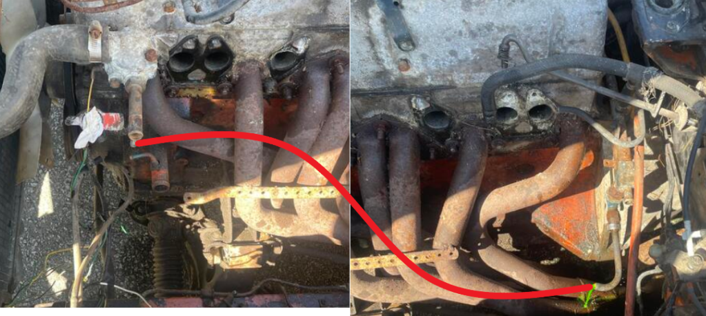

Since this car will never be driven in cold weather, I’m assuming we can block all the waterlines going through the carb? Can someone please point out me on the photo which lines can be blocked in? Which ones have to be reconnected? That would be great thanks.

Thanks zed but your diagram shows more of the engine then the carbs.  Any diagram of the carb like that ?? And how do most block or cap the lines? Put a bolt in the hose and a hose clamp ??I’ve seen some little plastic or rubber nipple caps guys use on the carb side.   Any info there??
There is no how-to guide on blocking coolant lines.  Mechanic's ingenuity is required.
The piece of hose and a bolt is a roadside fix.  Temporary and unreliable.  (Oops, site posted at the same time.  No offense intended Cliff!  Double oops.  Cliff fixed it at the end (I don't read good).  We are in agreement.)
Follow whatever line you're trying to block back to its source.  Choose the approariate blockage method.  Here are some samples.
These are pretty good.  You'll need to measure.
https://www.mcmaster.com/products/compression-fittings/shape~cap-and-plug/
These are good if there's a fitting.  BSPT is the thread type.
https://www.mcmaster.com/products/plugs/pipe-plugs~/?s=brass+plugs+bspt
For the carb lines you could just bypass the carbs.  Just connect the two ends together.  You'll lose some cooling power since the fluid won't be passing through the radiator.  I'm not 100% on inlet and outlet but I think that it's these two ends.  Maybe somebody will correct me if I'm wrong.
