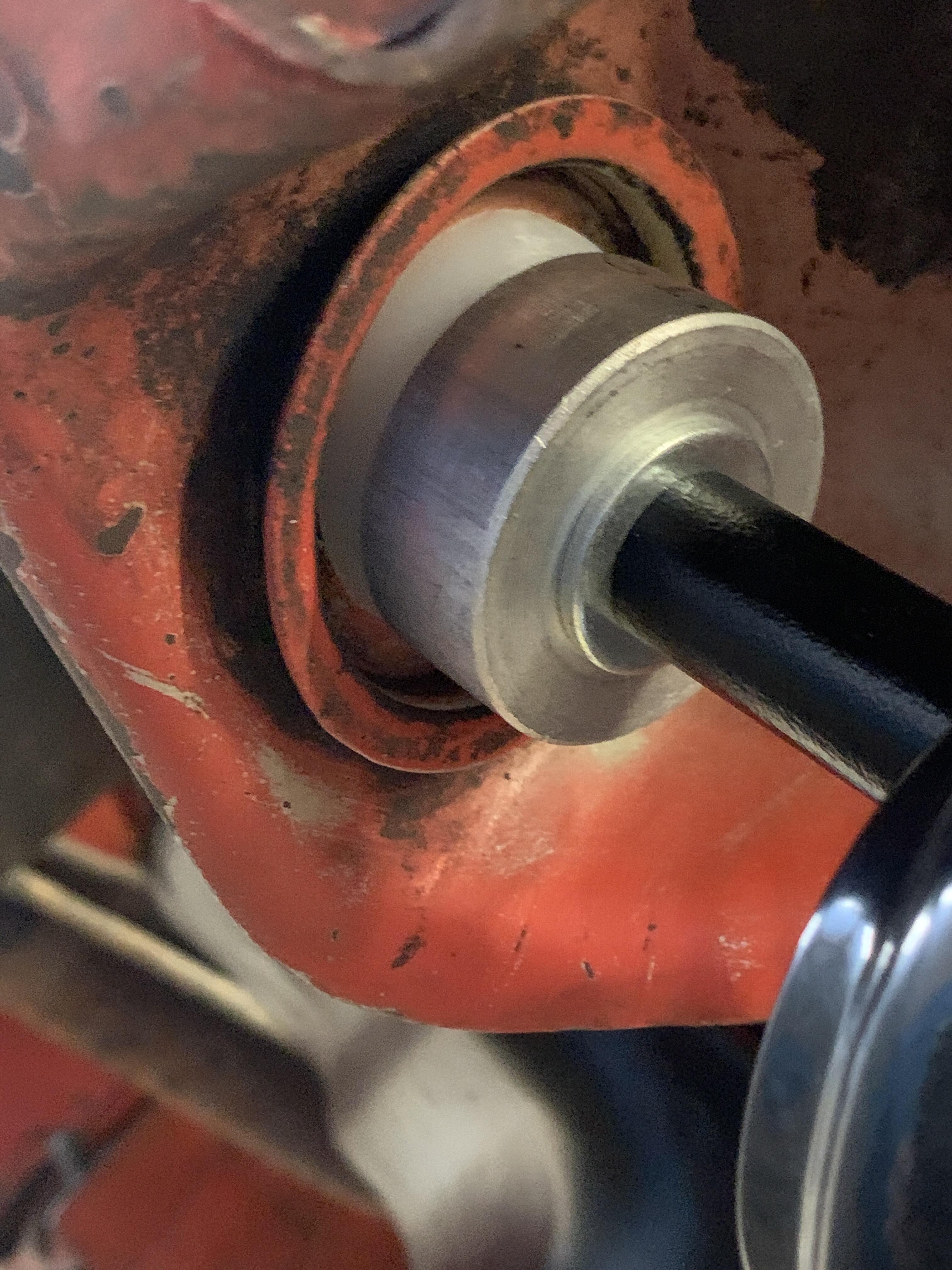

KenFirch Posted July 2, 2024 Share #76 Posted July 2, 2024 I had the same problem with the tension rod bushings splitting. This MSA kit works much better: https://www.thezstore.com/datsun-240z-1973/product/6551/tension-rod-t-c-kit-70-8-87-240z-260z-280z-280zx-300zx Link to comment https://www.classiczcars.com/topic/68969-75-280z-5-speed-swap-from-81-280zx-any-catches-i-should-be-aware-of/?page=7#findComment-666986 Share on other sites More sharing options...

HusseinHolland Posted July 2, 2024 Author Share #78 Posted July 2, 2024 5 hours ago, KenFirch said: I had the same problem with the tension rod bushings splitting. This MSA kit works much better: https://www.thezstore.com/datsun-240z-1973/product/6551/tension-rod-t-c-kit-70-8-87-240z-260z-280z-280zx-300zx Interesting! Do you have any pics of it installed? They don't have any directions or install pics I can find on their website. I have seen a couple of cars at the Carlisle Import Show in PA that had steering rack Tie rods modded to fit also. Link to comment https://www.classiczcars.com/topic/68969-75-280z-5-speed-swap-from-81-280zx-any-catches-i-should-be-aware-of/?page=7#findComment-666988 Share on other sites More sharing options...

KenFirch Posted July 2, 2024 Share #82 Posted July 2, 2024 3 hours ago, HusseinHolland said: Interesting! Do you have any pics of it installed? They don't have any directions or install pics I can find on their website. I have seen a couple of cars at the Carlisle Import Show in PA that had steering rack Tie rods modded to fit also. Here's a pic and instructions. You'll still need a rubber bushing on the rearward side. TensionRodKit.pdf 1 Link to comment https://www.classiczcars.com/topic/68969-75-280z-5-speed-swap-from-81-280zx-any-catches-i-should-be-aware-of/?page=7#findComment-666996 Share on other sites More sharing options...

HusseinHolland Posted July 2, 2024 Author Share #84 Posted July 2, 2024 2 hours ago, KenFirch said: Here's a pic and instructions. You'll still need a rubber bushing on the rearward side. TensionRodKit.pdf 115.28 kB · 2 downloads I've ordered a set 1 Link to comment https://www.classiczcars.com/topic/68969-75-280z-5-speed-swap-from-81-280zx-any-catches-i-should-be-aware-of/?page=7#findComment-666998 Share on other sites More sharing options...
