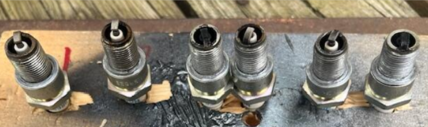

Four of your plugs look great and two look terrible.  The fact that your pressure numbers look good but you're losing oil and have two dirty cylinders suggests that the oil scraper rings in those two cylinders are damaged, or the intake valve seals on those two cylinders aren't working.  Valve seals is the easiest place to start.  Changing oil won't help.

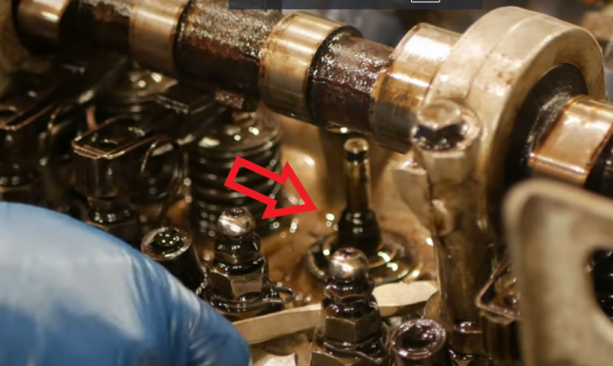

You might be able to see by eye if the intake valve seals on those two cylinders are different than the others.  Worth a look.
I wouldn't be surprised if the engine is only firing on four or five cylinders.  Those plugs are filthy.

You'll have to look very carefully through the valve spring.  Bright light, magnifying glass, or camera with close-up shot.
Here's a shot of an exposed one and link to the guy's video.  No idea who it is, found it by Google.
p.s. since you only have two bad cylinders it might be worth the time to just replace valve seals on those two.  If it was mine I'd probably just do the two intake valves.  Why mess with the others that appear to be just fine?

New question...In the following photo of the plugs today. Plugs 3 and 6 are still dark compared to the others where the ceramic still is white. All the plugs were changed at the last oil change so I assume I have a second issue of imbalanced air/fuel mixture. There has always been carbon buildup on the back bumper. Is this an injector issue? They are Standard brand and all new. Would a temperature range change on those two spark plugs be a thought? All the usual culprits like AFM, Temp Sensor, etc. would seem to be across the board items not individual cylinders but what do I know.. Any thoughts would be great. Right now I'm just thrilled that the oil problem seems to be fixed.
