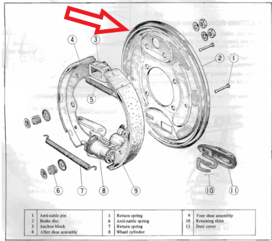

On 7/9/2024 at 6:48 PM, grannyknot said:
remove the wheels and and spin the hubs, could just be the drums rubbing against the backing plate.
This is the most likely cause.  It would be unaffected by the shoe change.  Very common.  Somebody on the forum just had a similar problem.
The drum is a close fit around the perimeter of the backing plate, see red arrow.  Any slight bend will cause rubbing, and the plate material is not that strong.  The plate itself acts like an amplifier of the sound.  Some finesse with a hammer will fix it.  Usually you can see a shiny spot where the drum rubs.
