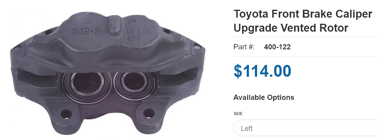

I looked up this caliper and rotor set on Rock Auto and I'll just replace both sides. Any comments on my selection? The master cylinder seems to be working with the 4-piston unit I have so I'm assuming there won't be a problem. My current rotors are non-vented so this will be an upgrade.
https://www.rockauto.com/en/moreinfo.php?pk=14177489&cc=1277502&pt=13824&jsn=1318
https://www.rockauto.com/en/moreinfo.php?pk=9744168&cc=1277502&pt=1704&jsn=1250

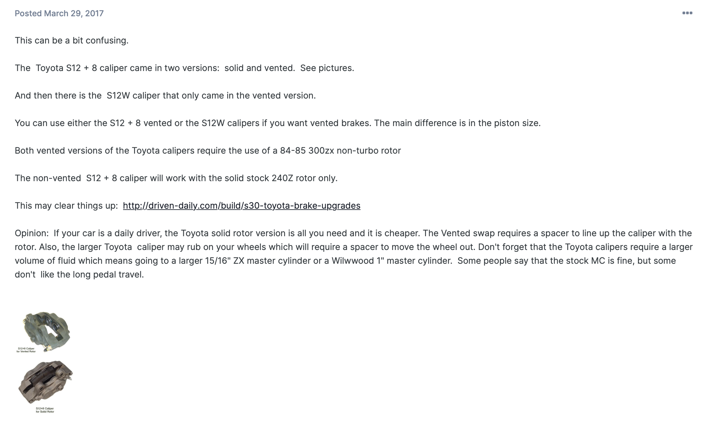

I installed the S12W calipers on my 78. Used 300zx rotors from stop tech. You need the Techno Toy spacer kit. You also have the nibble off a piece of the backing plate for caliper clearance. The S12W has two large pistons where the S12+8 solid rotor style has one large and one small Piston.

I usually look for an upgrade when I replace items so this seems like a good time to install better brakes. I'm not going to go the S12W route since that would be two steps up and complete overkill. The wide opening S12 + 8 with vented disks will help dissipate heat better than the solid rotors I have now.

Almost everyone says you need a ZX 15/16" master or a Wilwood BUT I use the stock 7/8" and have since I did the vented rotor / S12W swap several years ago. My youngest son did the same swap at the same time but used the ZX master. I can tell a slight difference between the two. This was after a NASA weekend on stock brakes... I first tried the 4-piston swap on my stock rotors. MINOR upgrade which I was disappointed with. That led to the vented rotor swap which led to Porterfield friction front and rear. I do quite a bit of mountain driving. The turbo Z is uphill monster and these brakes don't fade on the downhill partly because of the rotors, mostly because of the improved pads and shoes.
If you use 300ZX vented rotors, a spacer for the rotor is unavoidable as are the vented rotor calipers.
The simplest route would be new stock rotors and Toyota 4-Pistons for solid rotors with some decent pads...

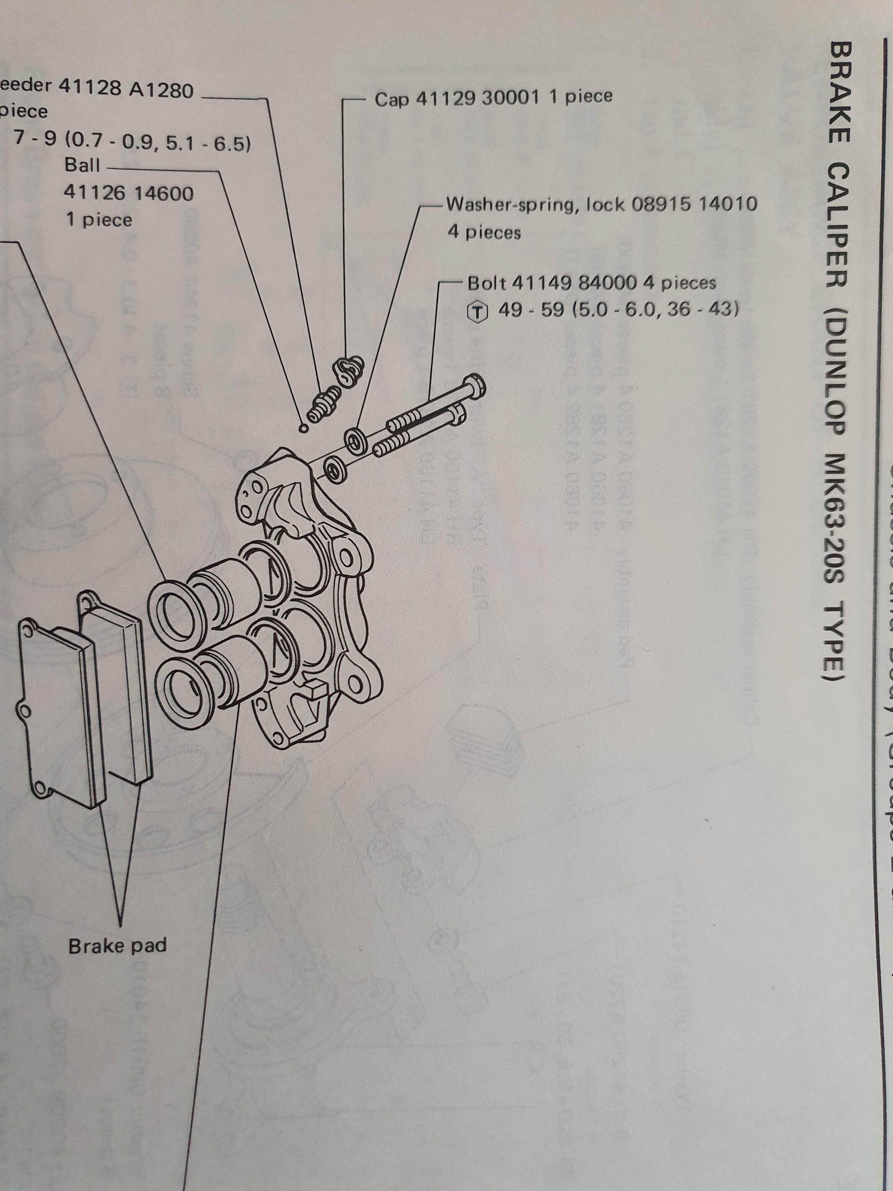

On 7/24/2024 at 4:45 PM, Jeff Berk said:
When I removed it I found that the threading was damaged and the seat on the valve was chewed up. I tried a new M10 1.0 valve and it would not seal.
Your early Sumitomo MK63s use the Dunlop style ball-bearing bleed nipples (the bleed nipple 'squashes' a small BB against a small hole in the caliper to seal it) and there's a reverse dome on the end of the nipple to assist this. Swapping in an ordinary M10 1.0 valve won't do.
