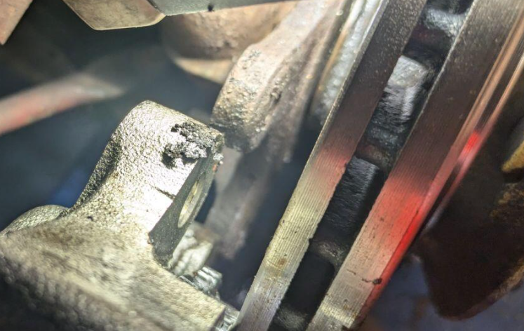

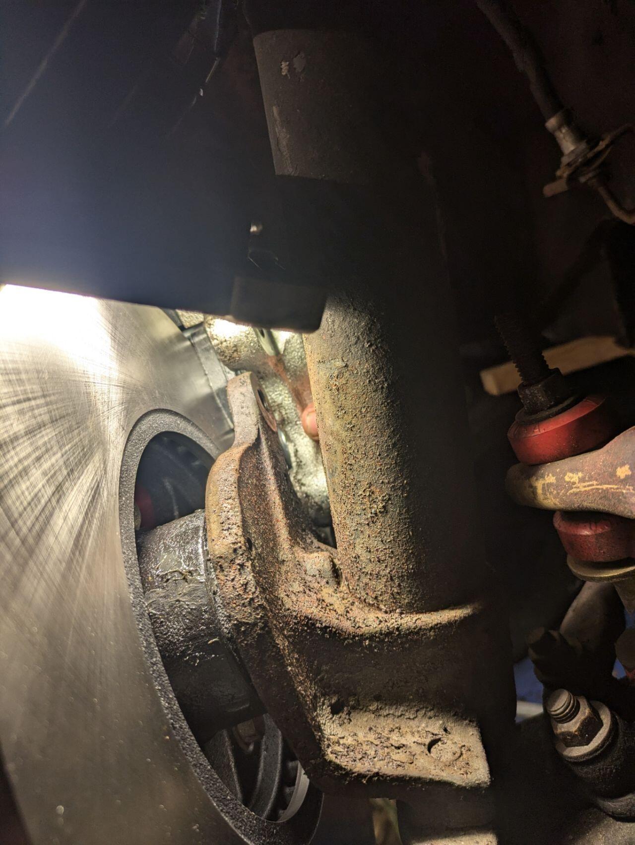

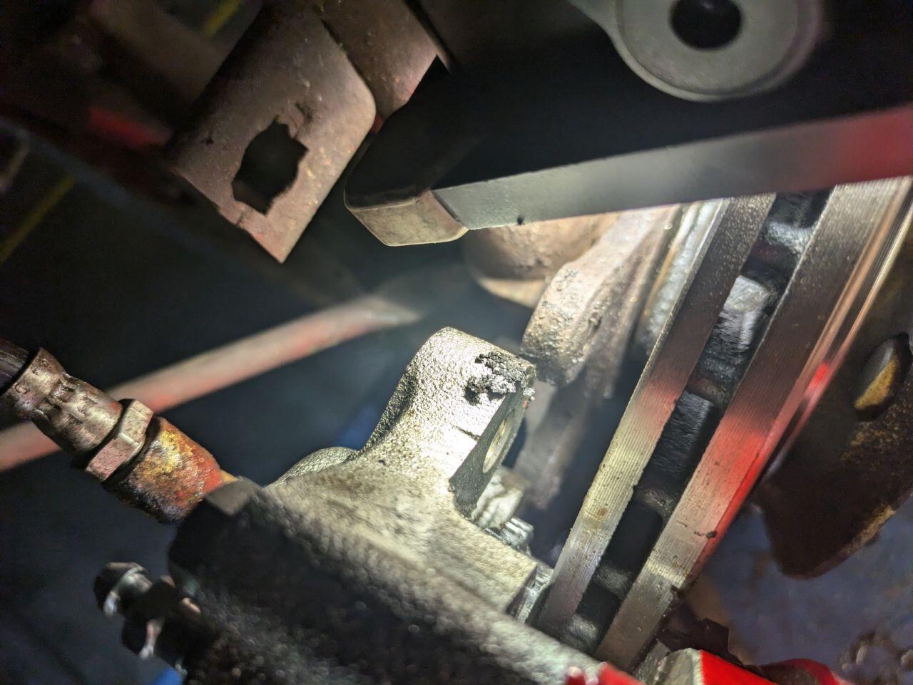

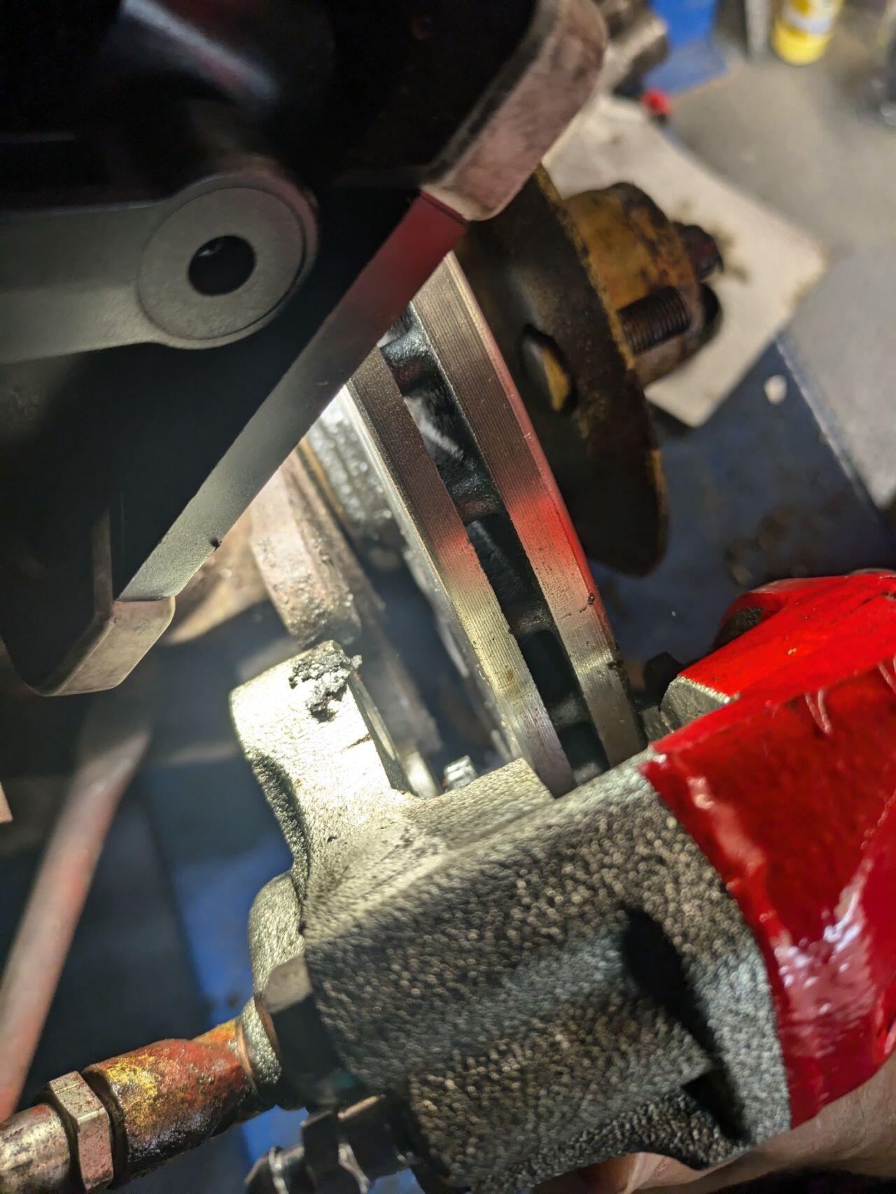

Here's a few more pictures of my Toyota installation problem. I tried reseating the hub but that didn't help. It looks like the hub is fulling seated.
You need that spacer from T3. The spacer mounts to the hub then the rotor to the spacer. Should correct your problem. Never tried it without the spacer.

The brake caliper flange is not threaded so the caliper needs to move inward then the bolt will go through the caliper flange and into the threaded attachment point. If I install the spacer, I think that will move the rotor outward and move the caliper in the wrong direction.

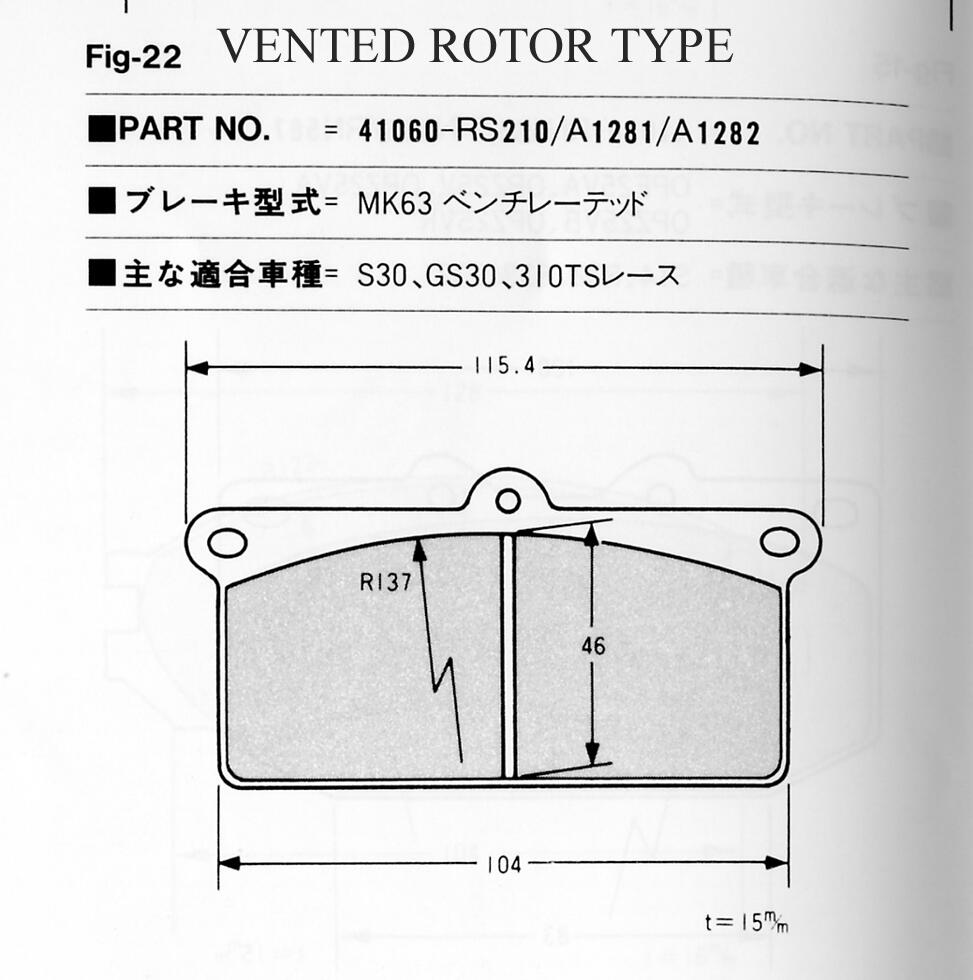

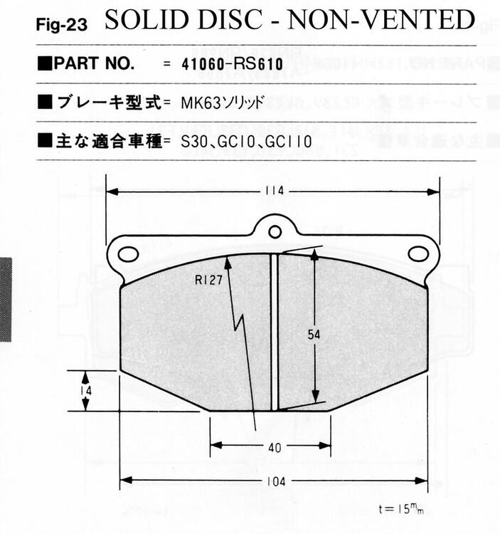

Here's the pad data. You have the NON-VENTED (solid rotor, narrow caliper) type with the cutaway shape. I have a vague recollection that there's a Ford pad (Capri?) which is very close and only requires a little trimming around the edges to fit and work safely. Worth asking your brake supplier if they can come up with something that has these dimensions.
I'll include the VENTED rotor type data for completeness, but the pads are not interchangeable.
HS30-H
Thank you for the diagram. The thickness (15mm) was something I was missing if I wanted to go ahead with using the mk63's. I still hope to figure out what I'm missing on the Toyota conversion. I also need to verify the mk63's are in usable condition.

I agree with @Yarb the T3 spacers fit between the hub and the rotor. Thereby spacing the rotor back in to the car. This will move the caliper back to the spot where it will clear the strut housing bracket. Do install the correct pads too.
Can't you just use washers or shims (fender shims can be swapped with the bolts in place) as spacers and try them in different spots until things fit right?  Then take the measurement and get the right spacer in the right spot?
Even after T3 tells you something you still won't really know until you try it.
