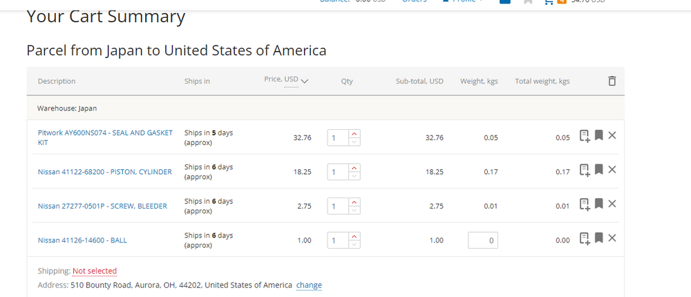

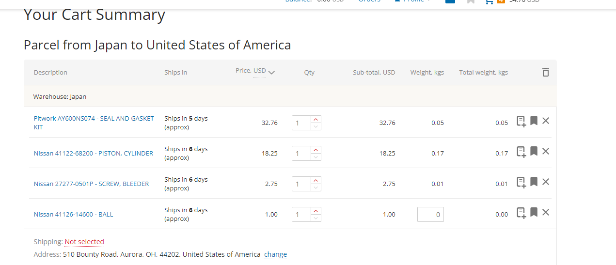

I don't know how safe a site they are, but I found everything I needed (except the pads) at Amayama.com. I'm still tearing down the brakes and so far I only need one piston and possibly one bleeder valve replaced. Unfortunately, my 260 will be down for a few weeks waiting on the parts.
I ordered the parts, the above items from Amayama excluding the bleed screws and ball that were NLA. The brake pads are coming from Jauce. I'm getting the balls for the bleeders from McMaster for about $8.50 for 100 and some washers for mating the two caliper halves. The measurements of the balls and the washers appear to be closer to inch than metric dimensions.
