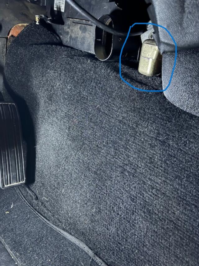

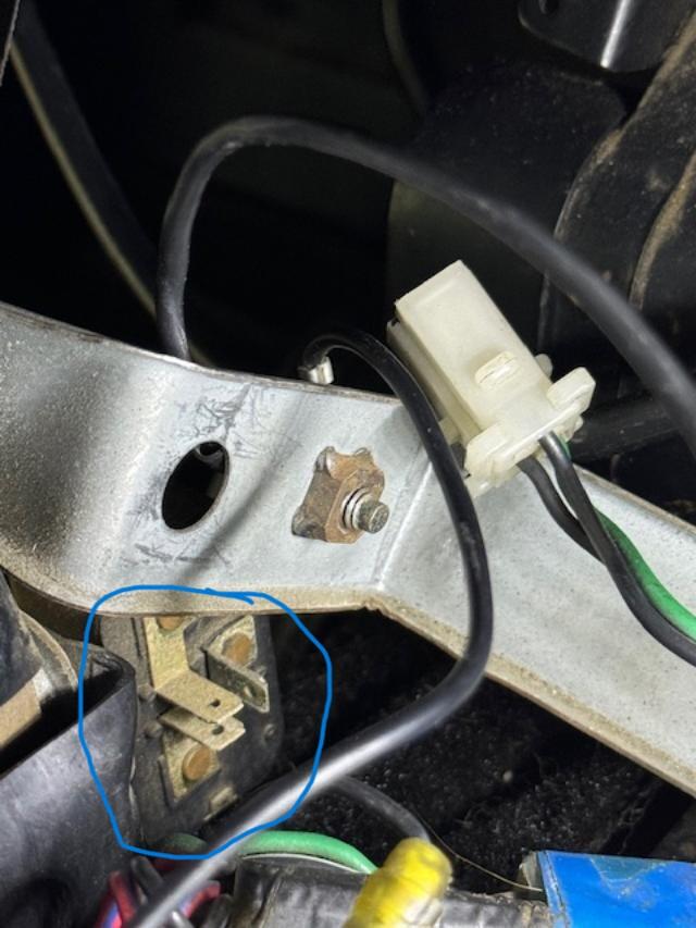

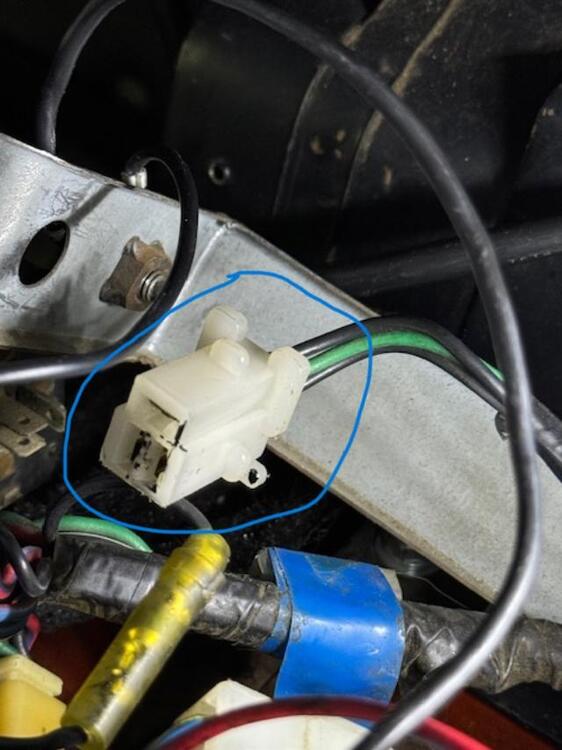

Can anyone identify what this is and the purpose? 1973 240z-See photos. It's attached to the console under the dash near gas pedal. It has three prongs out the back. There is a three prong plug that may go to it, as it's just sitting there unattached for at least ten yrs. Wires are 2 black and one green. There was a dealer installed Ac that was removed and an aftermarket radio that PO had installed and butchered the wires. I have been slowly fixing them.

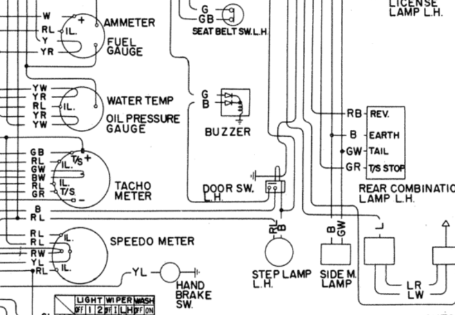

15 hours ago, KenFirch said:
I had that connector marked as the buzzer on an old wiring harness I removed from my late 73.
Factory buzzer sounded kinda like this, which is why it's not connected.
That was all part of the 70s effort to annoy people into wearing seat belts. It got even worse in 74 as everybody was required to integrate seatbelt interlocks with the starter circuit. People got very perturbed that a bag of groceries in the passenger seat kept you from starting the car until the groceries were safely buckled in. You can even still see interlock in the 75 wiring diagram though the NHTSA rescinded the requirement and every automaker immediately ditched it.
