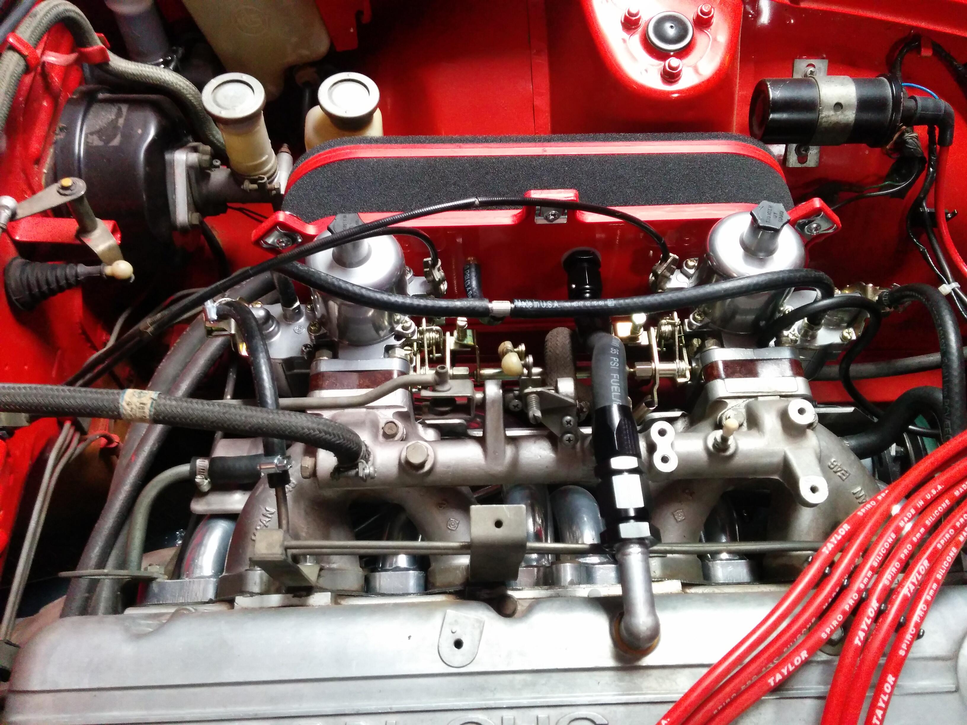

You don't need to go with the euro balance tube initially, but it is something I'll probably do down the road too. I've removed all the air pump smog stuff currently and kept the PCV and valve cover vent hose. I did go with an ITG air filter and drilled the back plate of the air filter for the carb vent hoses (I T'd the carb float bowl vent hoses so I only had to have one hole for the float vents in the back plate of the air filter) and also did AN fittings for the valve cover hose. Here's a picture of what I did.
Nice.  As i start taking this apart it seems like it will be easier than i thought.  One extra question or two as I get through this.  I see the emissions control screw / linkage will now basically be useless and flap in the breeze.  Just leave it like that I guess?  And another real newbie question, because I'm afraid of another slip up, How do you take the "ball joint" link off the balance tube to the throttle linkage?  I definitely dont want to crack that ball joint.
