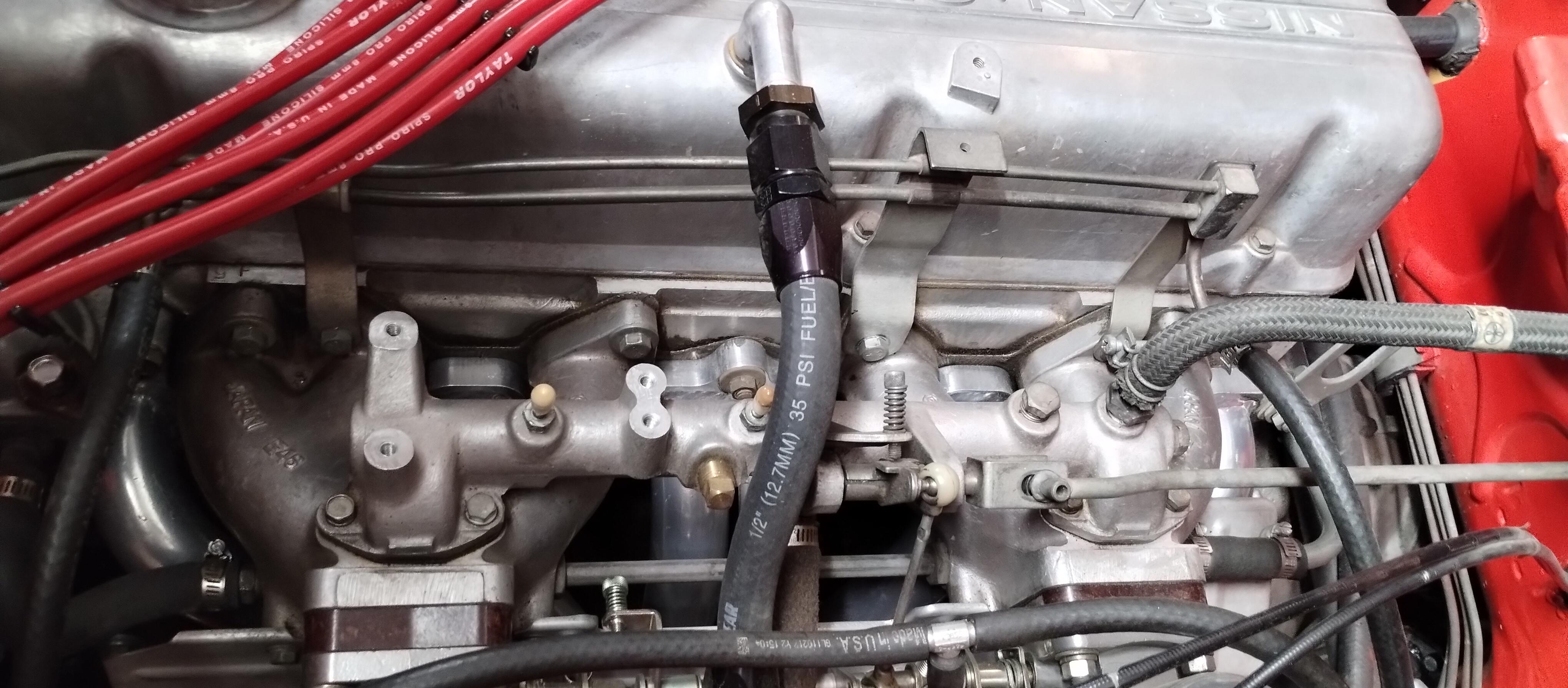

Okay couple of more questions. As I was falling asleep last night I was thinking about the bolts and washers and stuff I took off the block and I started looking around because the previous owner had a bit of a mismatch of various bolt head sizes to deal with taking off the intake. So I started browsing the typical sites to see if I can find some relevant replacement Hardware and some sites seem to sell a set of studs nuts and washers others a mix and match of studs and bolts. I don't have access to the car right now but I'm trying to recall if those studs were the type that can come out or could they have been part of the block? They looked really old and I can't imagine the previous owner leaving them there when he had the engine worked and rebuilt unless they were part of the actual block. the question is should a 71 have studs for the exhaust but bolts for the fuel rail and intake like I had set up? Or should it all be studs?
On my 12/70 built car the top row of the intake manifold, which includes the fuel rail, is all bolts. The common for the exhaust / intake are all studs. I've seen some that say they are all studs, but that's not the way they are on my car. Here's a bad picture but you can see most of the top row of bolts and the one stud in the center on the header. Just make sure you save those special washers that go on the common studs clamping the intake and exhaust, if you do headers you will still need those washers.
Thanks.  Ok so at least my setup was right but i think i still need new bolts because the set on there are annoying with various head sizes from home depot lol.  So are the studs removable, I'm assuming so but I think i'll leave them for now and tackle that with the new header down the road.  I dont want to push my luck again lol.  although i just found this old pic from the PO restoral book and it looks like the studs are intact and maybe he even painted over them when he painted the block.  Either pure lazy or he couldnt get them out and left them

Making progress.  A little ways to go waiting on some gaskets for the carbs and balance tube along with the brake booster hose switched to the top load rather than side valve.
I decided to get all new studs and HW for the block because the previous set was a mess of sizes.  MSA had a decent set all sized and ready to go but it did require me changing out the intake bolts to studs.  I kind of like it only because it made the mounting easier rather than having to hold it in place while i bolted it.
the exhaust manifold arrived already media blasted nicely but not such a great color so i painted it with vht.  I ended up using aluminum to try and match the intake I had already.
then i restored and painted  the intake, polished the coolant tube and fuel rail
Coolant back in and as i wait for the gaskets I'm polishing the linkages as best i can.  i'm contemplating painting the front section of the exhaust pipe its currently a rusty looking brown.  Without a true lift might be a bit of a challenge getting it out the back but i'll see what i can do.  if its not reasonable ill leave it and deal with new pipes anyway down the road with the headers.
