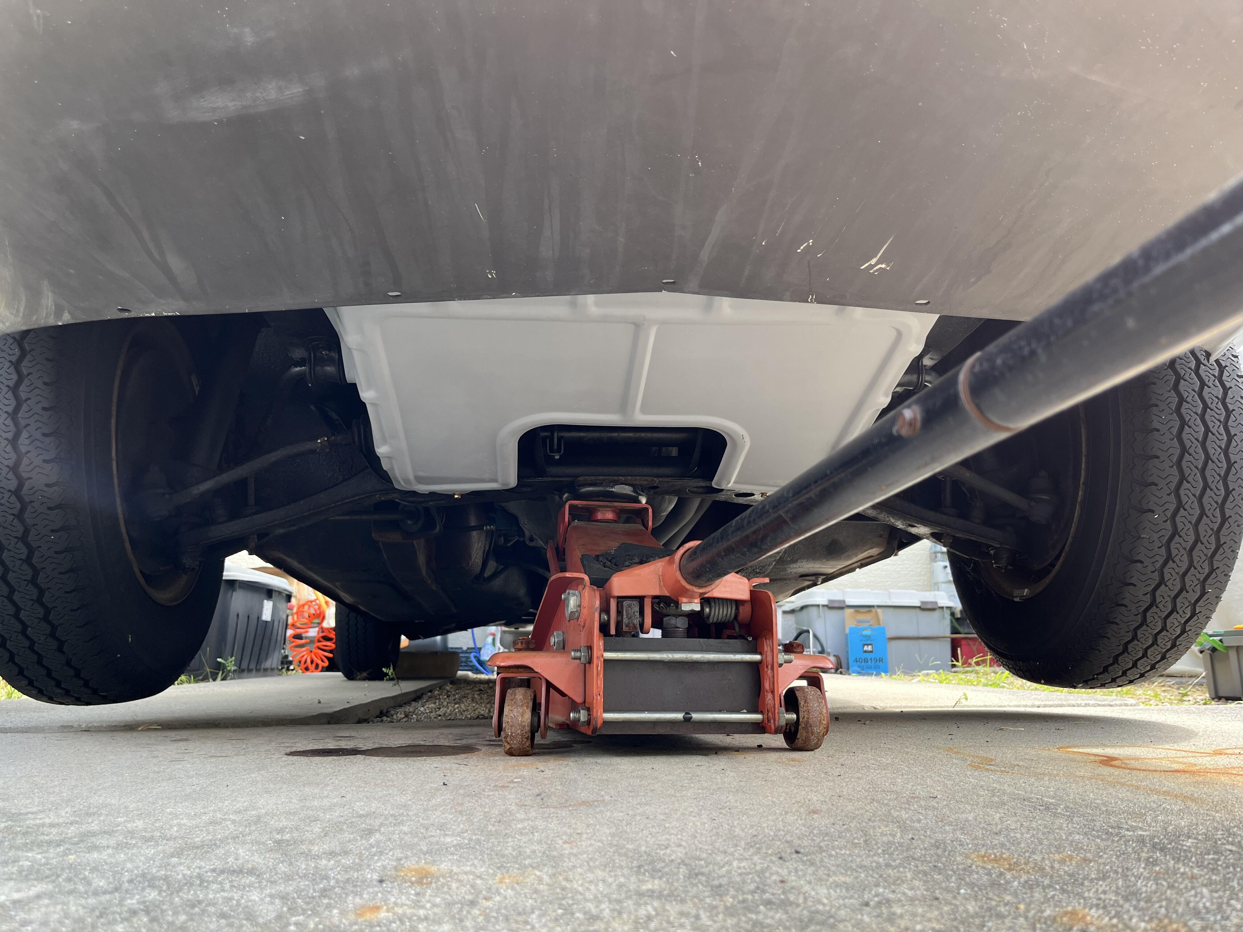

Yours is for the later ‘U shaped’ lower cross members which can be seen on 280Z and Fairlady Z(S31 model).
Just FYI, I recently refurbished my pan for my Z which is the earliest style, no-hole version (late 1969 to late 1972 in Japan).
Kats
Edited by kats
The three that I have are all the early design part (guess that makes sense). Like the pic kats posted - no holes. I don't have the later part to make a comparison with so I can't comment on if the late 260/280 part could be made to fit the earlier Z's.
(But since the "splash-board engine" fastens to the lower core support which changed shape starting with the late 260 AND the radiator also changed size and shape, you'd have to assume the "splash-board engine" requiring a different shape as well. Knowing Nissan, I would also assume that most of the mounting points would remain the same on the frame and cross member.)
