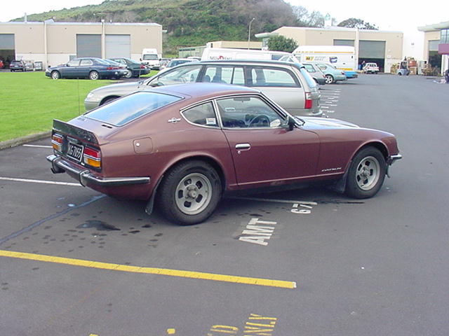

Well here are some pics of the mnoey pit.
Not too sure if the early models had the plastic overriders on the bumpers (if that is what they are called).
Also it has a 5 speed badge on the rear. Not too sure if it has a 4 or not.
Looks like the E31 is also included (has a water leak)...not too sure what is wrong with that. It has a E88 on it now. Take a look at the rocker cover. I think it should be "Datsun" and not "Nissan-OHC"...any ideas.
Anyway....booking a flight tomorrow for Carlos county....yikes.
There is a little rust that I can see on the drivers side sill. Hopefully a easy repair.
Your thoughts?
