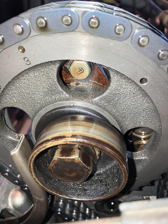

15 minutes ago, Zed Head said:
I think that your cam timing might be off by a tooth.
You may be right.  I did a timing chain stretch adjustment a while back and may have messed up the cam timing.  I'll check that too.  Thanks.  I had a timing chain holding tool, but I lost it over the years.  I think I have a screwdriver that will work per the ZTherapy method.
Edited by BoldUlysses
16 hours ago, BoldUlysses said:
The picture was taken before I rotated the crank to TDC.  Here's the notch & groove:
Wait.... If this pic was taken before the crank was rotated to TDC, then there is nothing to be gleaned from it with regard to valve timing.
Who cares where the cam timing marks are if the engine isn't at TDC?
I had the feeling I was missing something obvious. 😟
I had assumed that the purpose of the notch and groove was known.  Didn't read the accompanying words.  I did get things right on my last suggestion to reset the mark on zero/TDC and see where the notch and groove were.

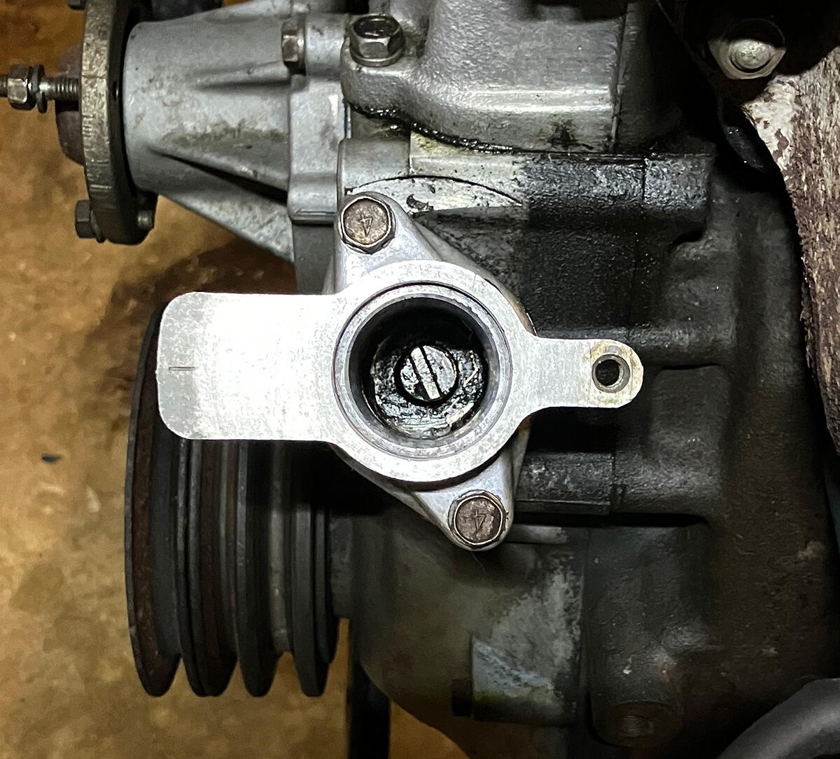

  • I moved the oil pump gear back 1 tooth to where it was before.  The timing bottoms out at ~20° BTDC (the top mark on the pulley) with the distributor (and the extra set screw on the bottom) turned all the way, but I drove it literally thousands of miles pre-restoration with the oil pump gear in this location, so I'm resetting it.

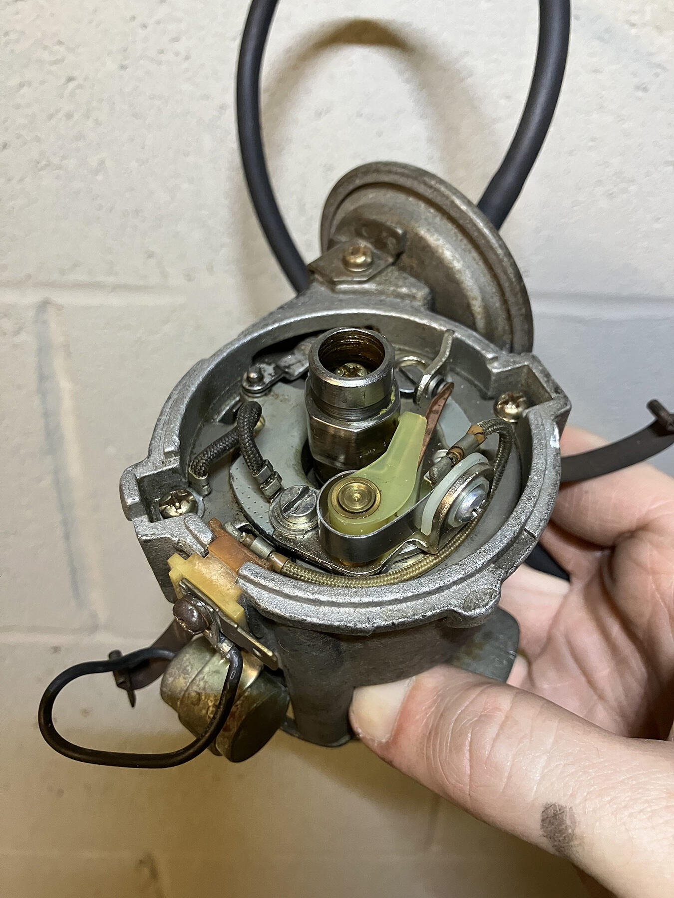

Can you guys check my work here?  Or take a pic of your stock distributor setup (the condenser side)?  It's been a couple years since I had the points on and I forgot the exact wiring.  Dwell set to .020.  The condenser itself is secured to the screw on the dist. body BELOW the plastic piece.
That is all correct.  If absolute accuracy matters to you, the spade for the wire hook up points upwards instead of to the side originally.  Be sure to put the correct lube on the distributor cam if you have not already done so.
  • Agree 1
Awesome, thanks.  I mainly wanted to make sure I had hooked the condenser up correctly.  Dielectric grease OK for the cam?
