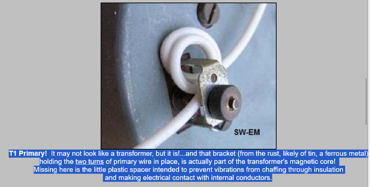

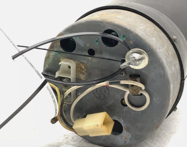

I can't remember the exact details but I know that people have fiffled with the loop of wire on the back of the tach and had good rresults.  I think that they might have removed a loop or made it bigger.  It generates an electromagnetic feild and the electronic igntion boxes apparently overload the current sensing system.  They pass more amps.  As I understood what I had read and barely remember.  I think that you can reach it from underneath without removing the tach.

Well having not messed in depth with the electronics inside the tach, I could be easily convinced that the wave SHAPE and DURATION are also important, not just the peak current.
Point is... I can provide no assurance that the stock tach will be compatible with anything other than points.
If it was mine I'd reach up and wiggle that wire around while the engine is running.  If something changes you'll know there's a possibility.  I might even attach some extraneous metal to the post that the wire encircles.  I don't know what exactly happens as current pulses through that small coil of wire but I imagine that it generates a field in that core that passes in to the body of the tach.  Then magic happens.
