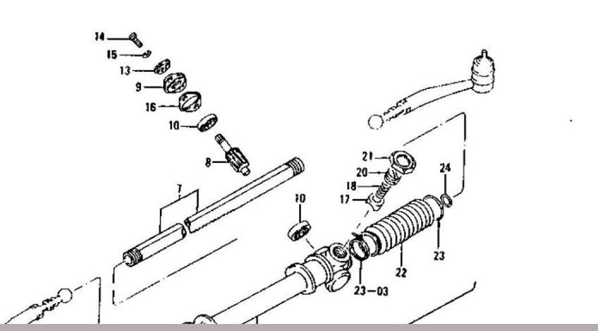

I've never seen the multiple figure pages like that, with the arrow you have to click on to get to the next figure.  Didn't know they existed on the carparts site.  You're right, there's two versions.
Many (some?) people remove parts 17, 18, 20 and 21 and pack grease in there.  On the 2nd figure, Aug 73 and up.  You can tighten it up a bit too, but you have to be sure it doesn't bind at the extremes of travel.
It looks like I stand corrected, moving to figure two with the arrow confirms the grease reservoir was limited to 240Z models and discontinued for the 260Z and later. I too had never noticed the arrow function before - learn something new every day.
