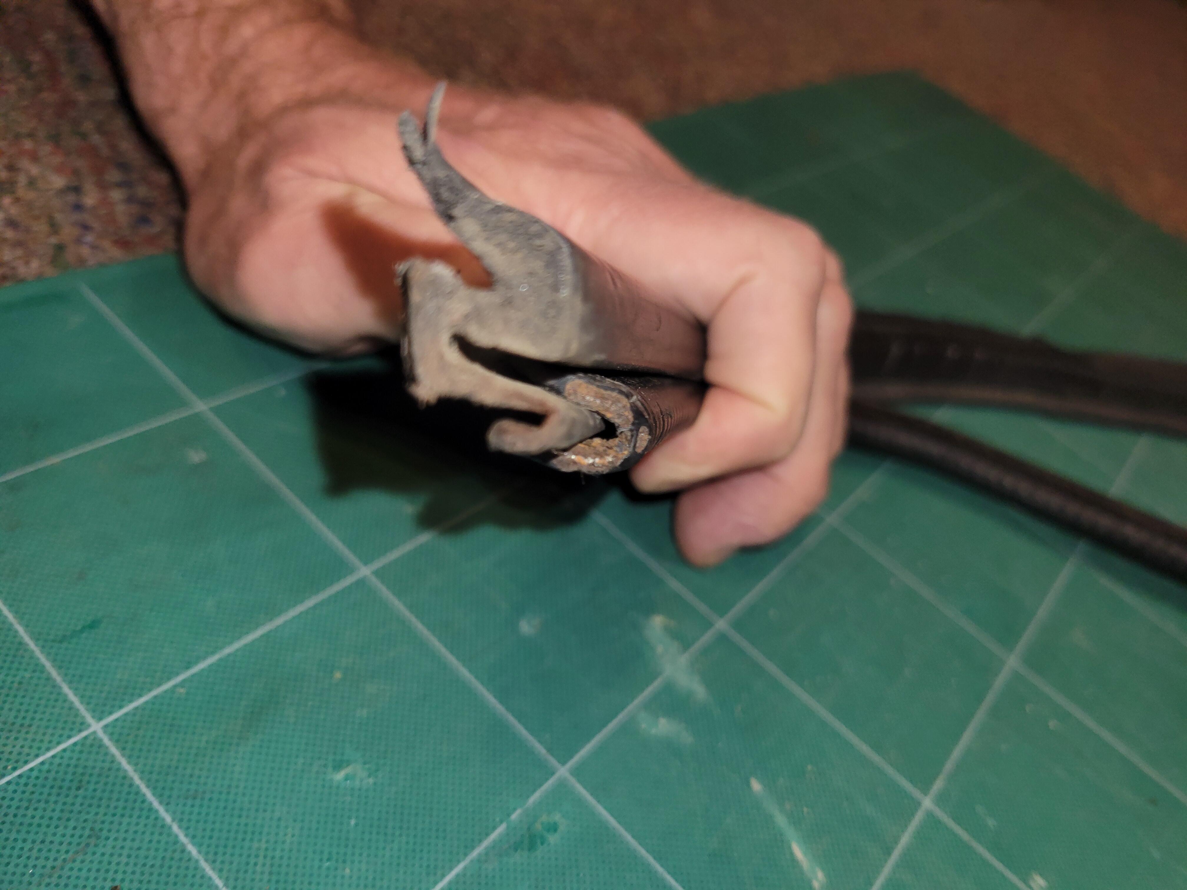

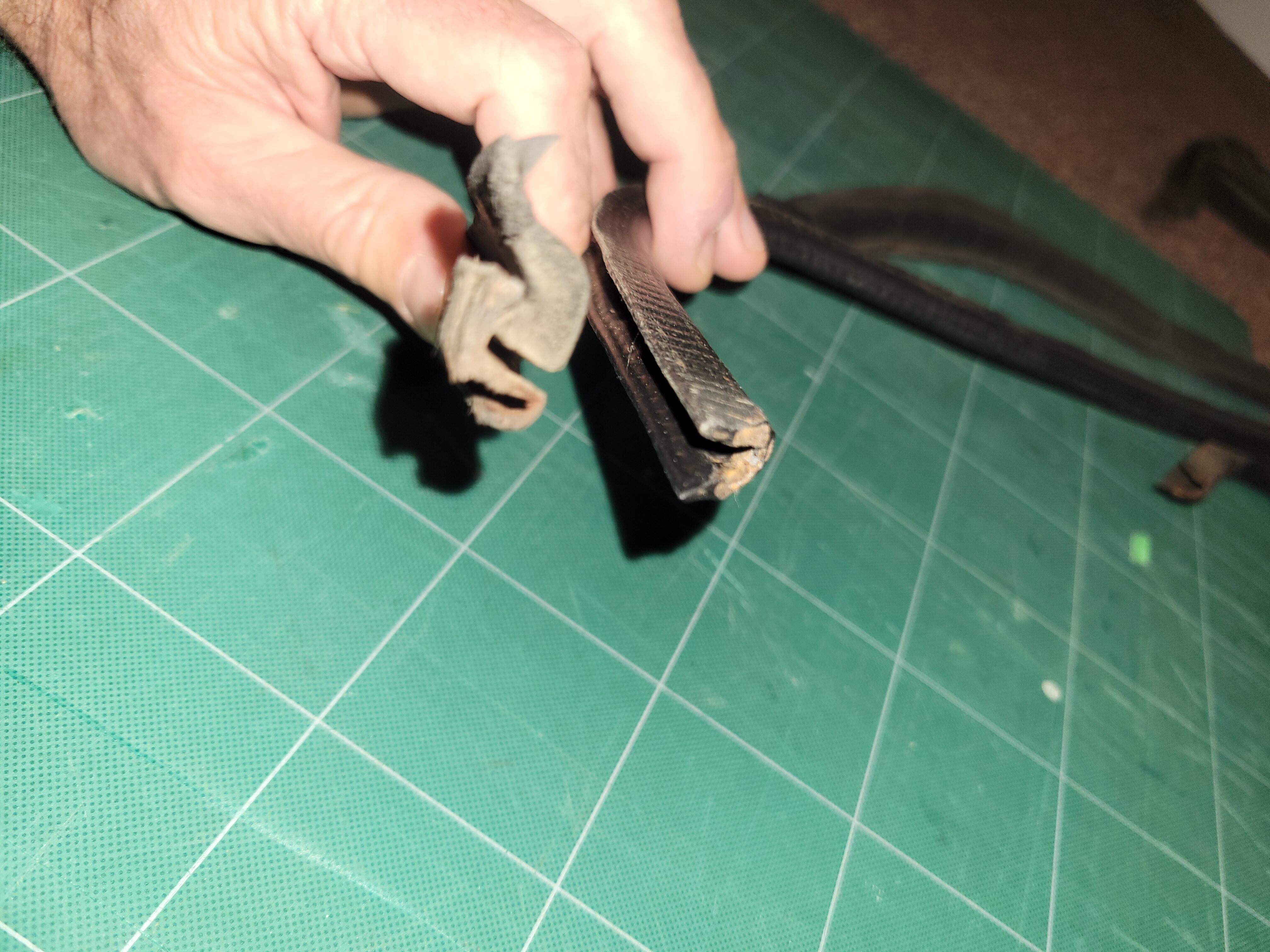

The original E41 design WAS a two-part system. Just look in the factory parts manuals.
The spongey rubber part was the 'Weatherstrip' and the U-shaped 'Welt' clipped over one side of it, sandwiching it onto the body seam. Most people don't notice because they can weld themselves together fairly well over time. The two component parts are also on different pages in the factory literature. Many think that the 76801-E4100 RH and 76802-E4100 LH show a one-piece system, but they are missing that the 76920-E4101 Welt A and 76921-E4101 Welt B parts are shown in a separate diagram for the body side.
With all of the proprietary off-the-shelf/universal seals the main problem in my experience is that the Weatherstrip part is the wrong shape and/or made from a material which does not compress anywhere near as easily as the original. In my experience this is worst at the front vertical edge of the door where the seal is being asked to compress more than anywhere else, and with nowhere to go. The original Weatherstrip is also a 'flap' cross-section rather than a 'bulb'.
The new S30 World versions are the closest to the originals I have seen.

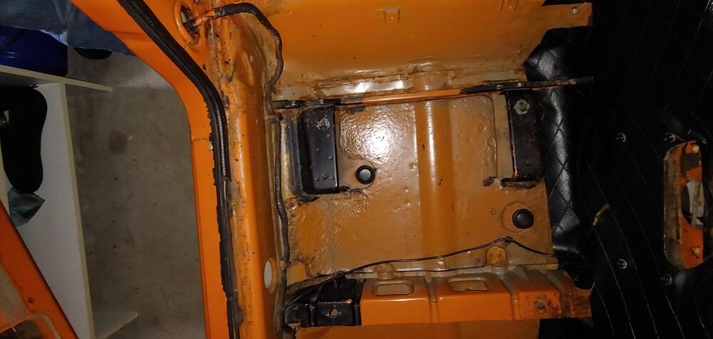

Thanks for taking the time to create and post these photos.  Maybe I'm just getting old*, but Photo #2 is confusing.  Did the rubber really sit under the weatherstrip before both were pushed down over the inch strip?  Looking at the photo, it seems hard to believe that the weatherstrip would be capable of generating enough clamping force.
(* I plead guilty, as I'm sure many others will, of just pulling the rotted old stuff off without giving much thought to how it actually worked.)

You're welcome. Yes the thin half loop on the weatherstrip goes on to the pinch weld first and then the welting goes over the weatherstrip. It's a good tight fit. Believe it or not. Lol
