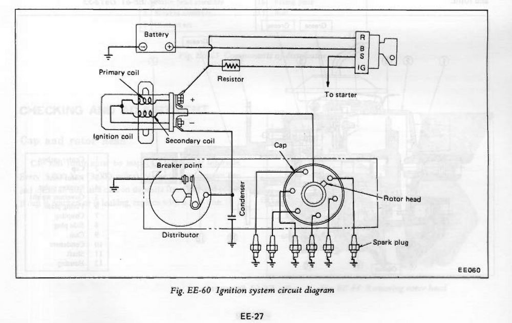

If there's no spark with power directly to the coil then working on the wires under the dash won't help.
Study the diagram and you should see.  Did you test for spark from the coil's main output wire?  The center wire?
  • Agree 1
Thanks for the pic, much cleaner than the one I’ve been referring to.
I get initial spark out of coil wire then nothing, same as before, so my thought is a short. Still have good spark to points.
