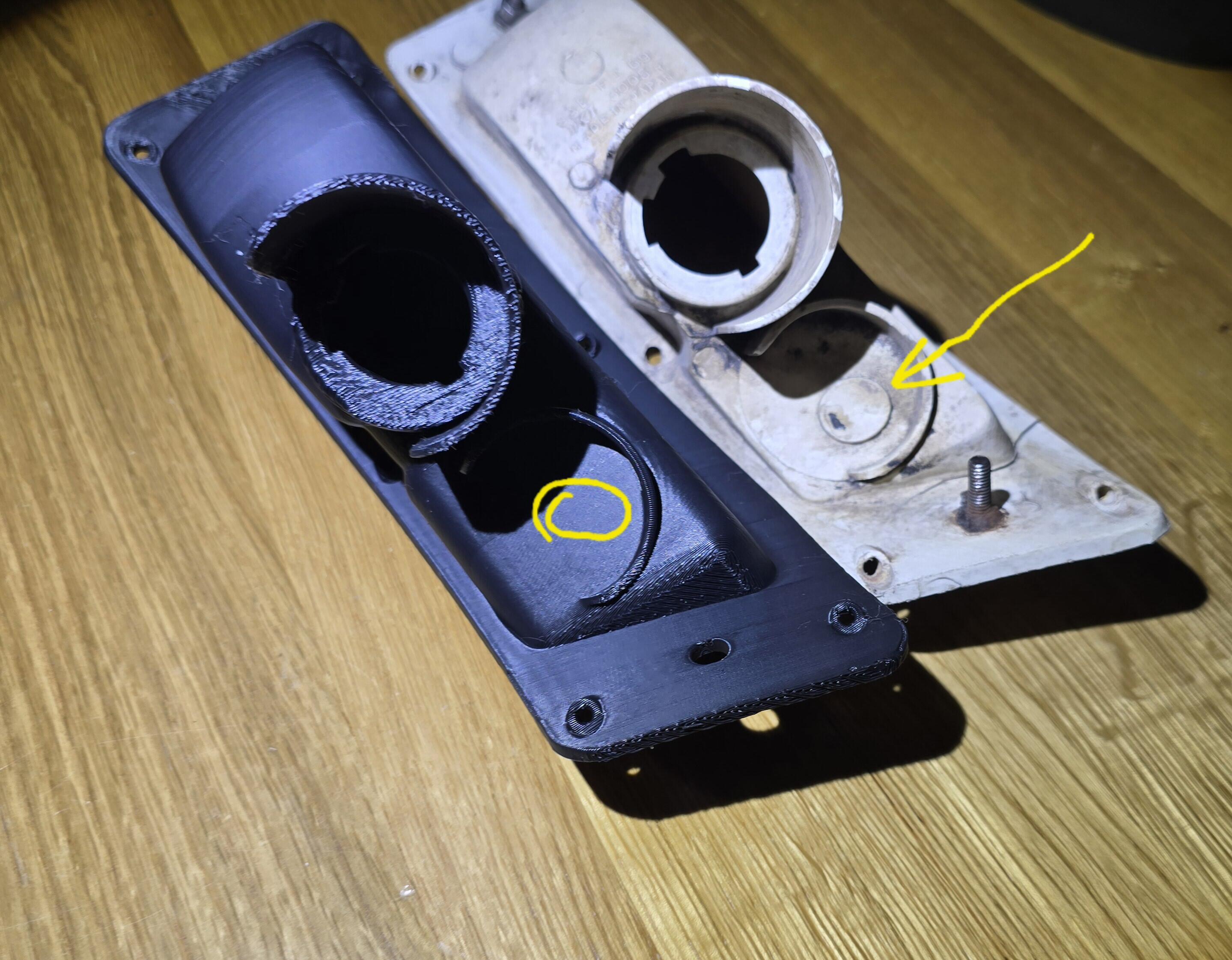

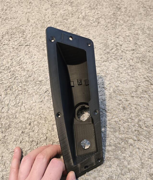

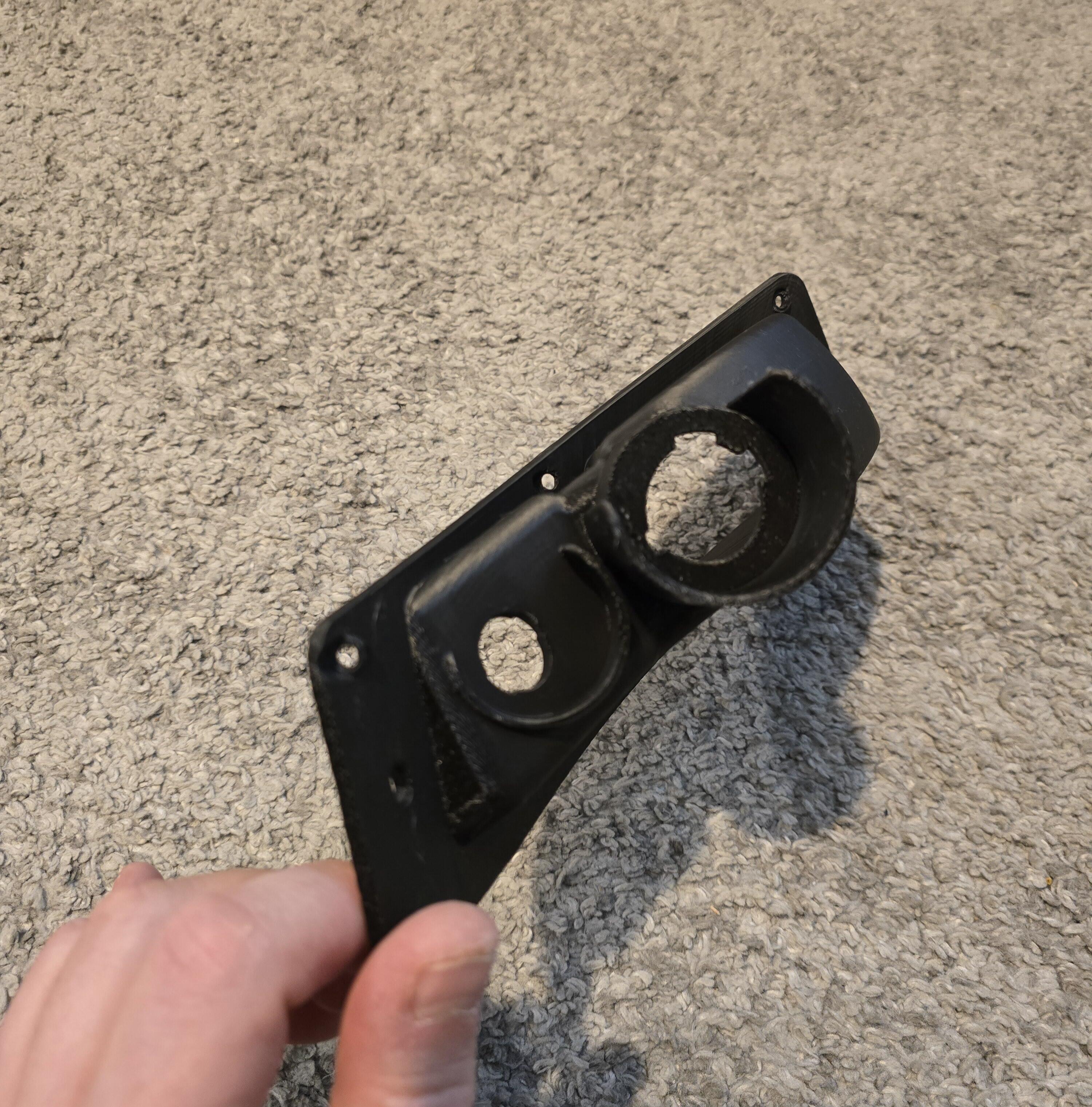

Hi, I've been asked to recreate the 240z front signal casing and wanted to know where the weak points are from the community and any tweaks that would be desirable to make it better.
Any suggestions?
It would be good if someone has a picture of the 2nd light hole in the back so I can design that in.

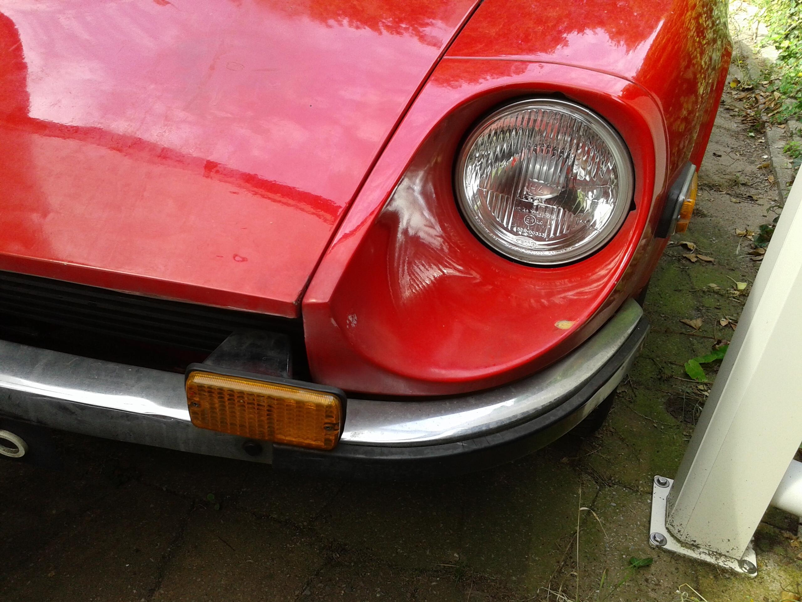

Nice work Chris, (I myself have the euro version signal lights on the bumper) For as far i know these flasher light ornaments/casings only had one bulb in them?
I like the ones that are on the bumper, the disadvantage is the terrible stuff it's made of most part namely Zamac (alu,copper,zinc ??)  It rusts from inside the airbubbles IN the material, so it's always a lost case when you rechrome them it ALWAYS comes back.. terrible stuff..   Maybe you could make them (the main rear part) out of shiny plasic?
