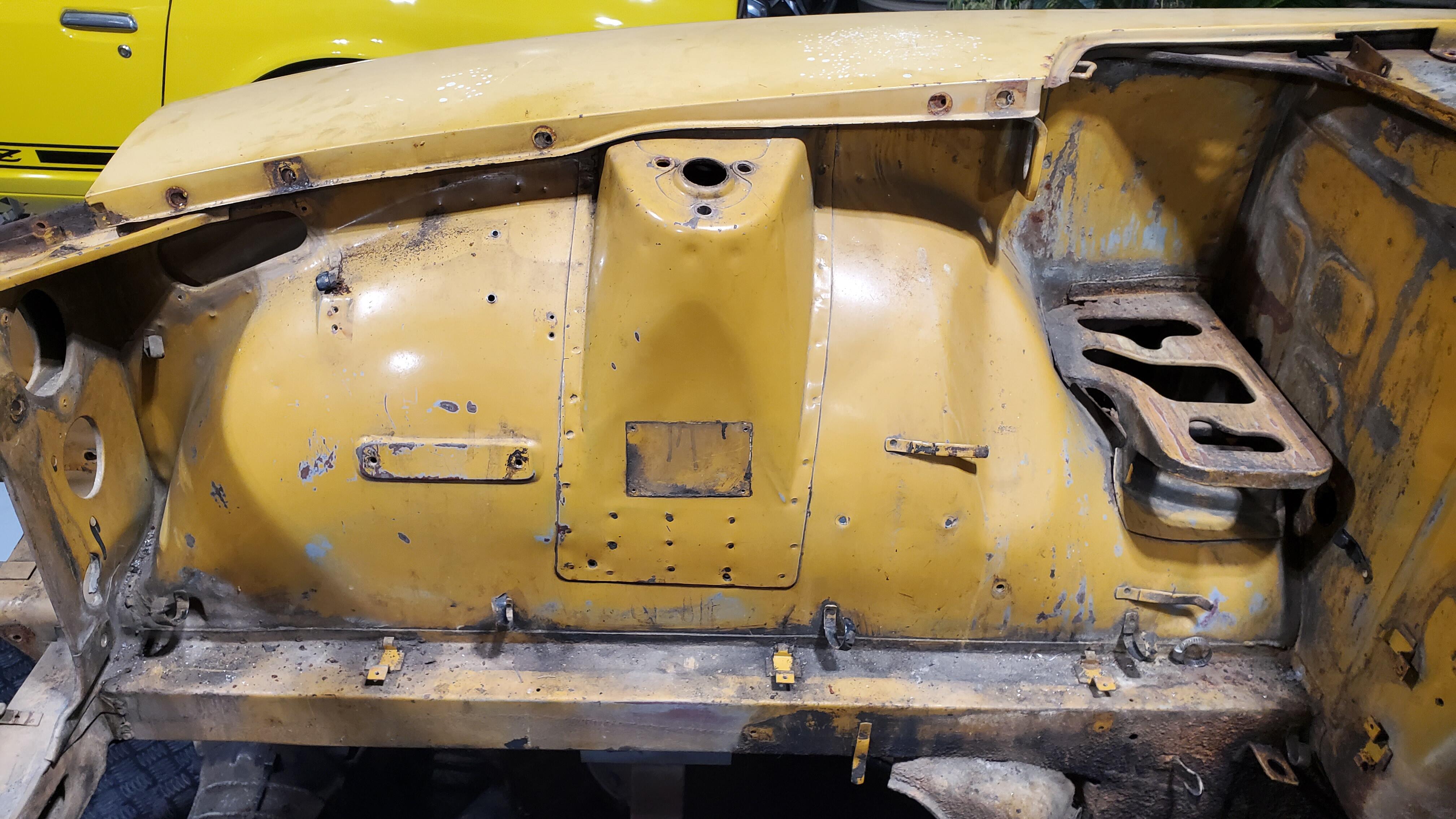

If you have anymore shots of the engine bay from either/ both sides, anything to help review, or  reference for properness……. Thanks..
David

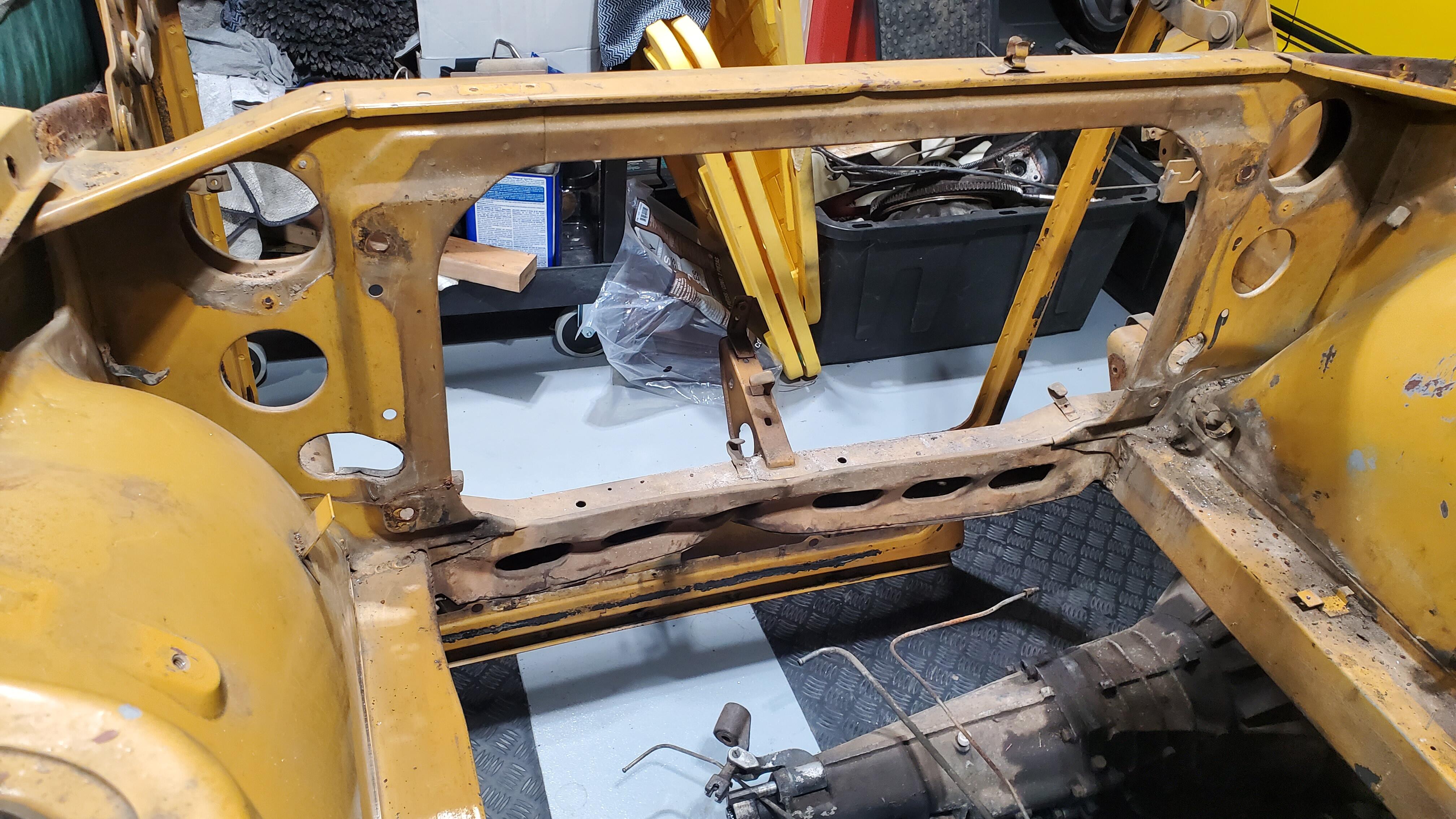

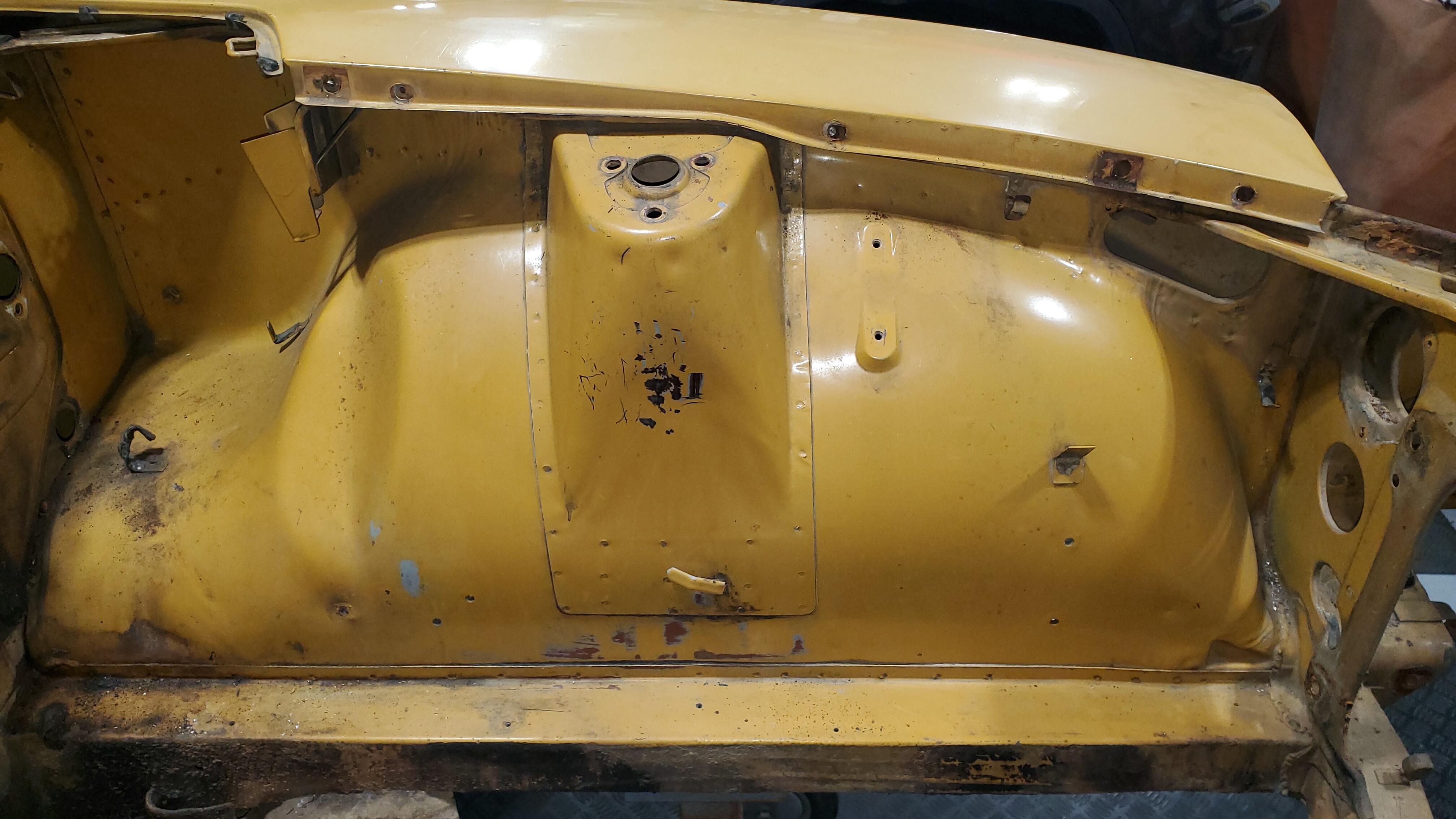

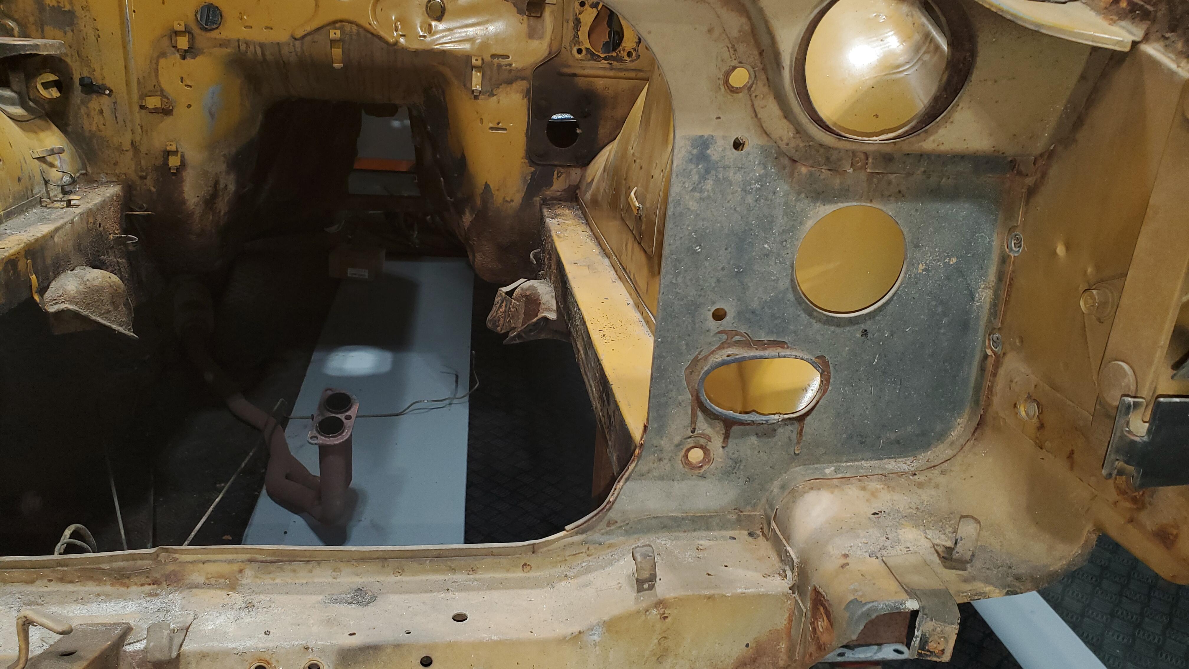

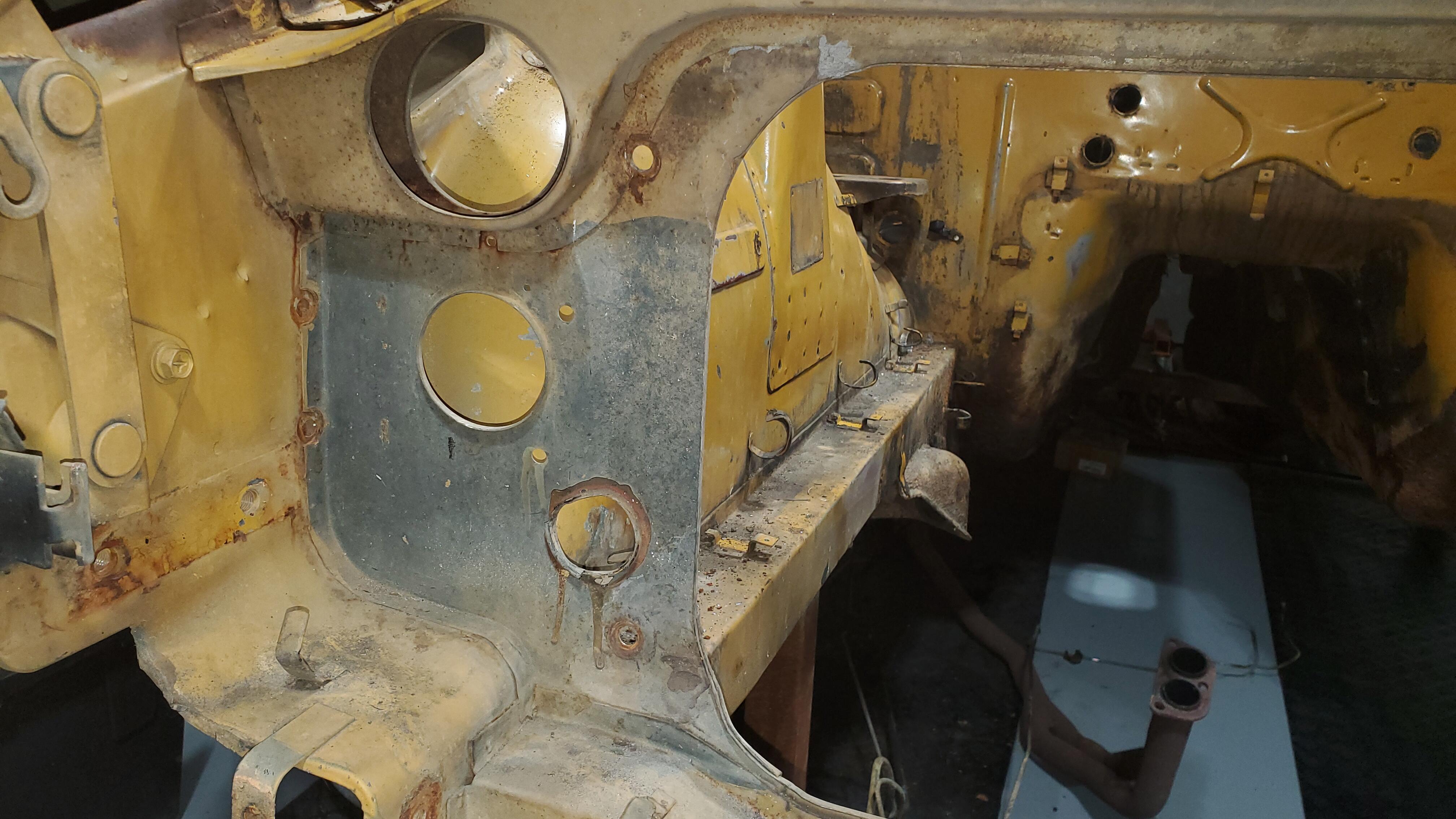

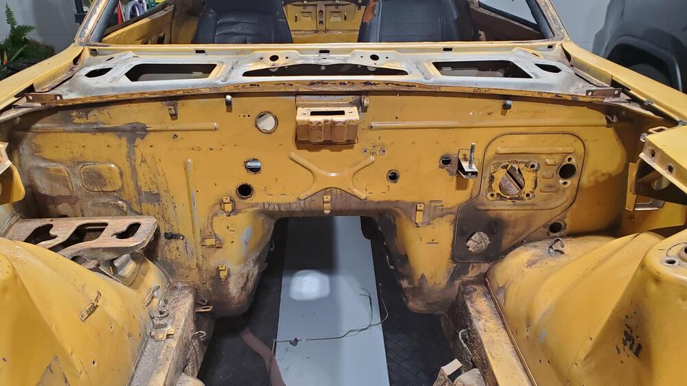

Here are pics of the engine bay.  I can't say that I notice anything unique other than the two hood bumpers.  Later models have threaded nuts for the hood bumpers.  This SN has a sheet metal screw that just threads through the sheet metal, no welded nut underneath
  Thank you for the pictures, exactly what I was looking for.
I have several "later" cars to look at, but have seen very few 3 and 4 digit cars., much less 2 digit cars for reference of amount of stitch welding seen at the firewall / frame rail attachment, and at the radiator core support/frame rail attachment.
    I had a couple of the flexible wire holders missing on frame rails on 51 that I was trying to determine if different then later models.
   Thanks again!!
