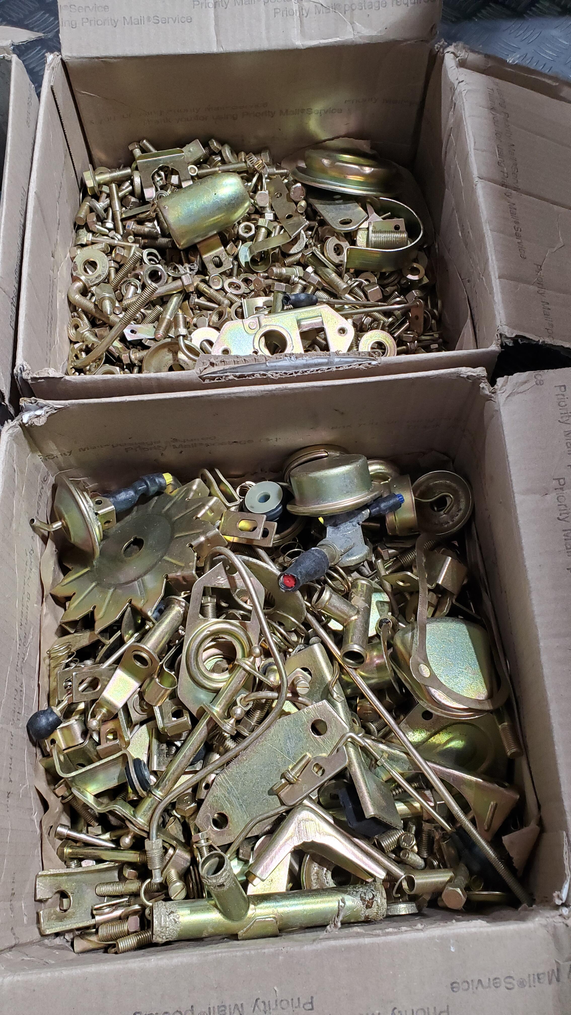

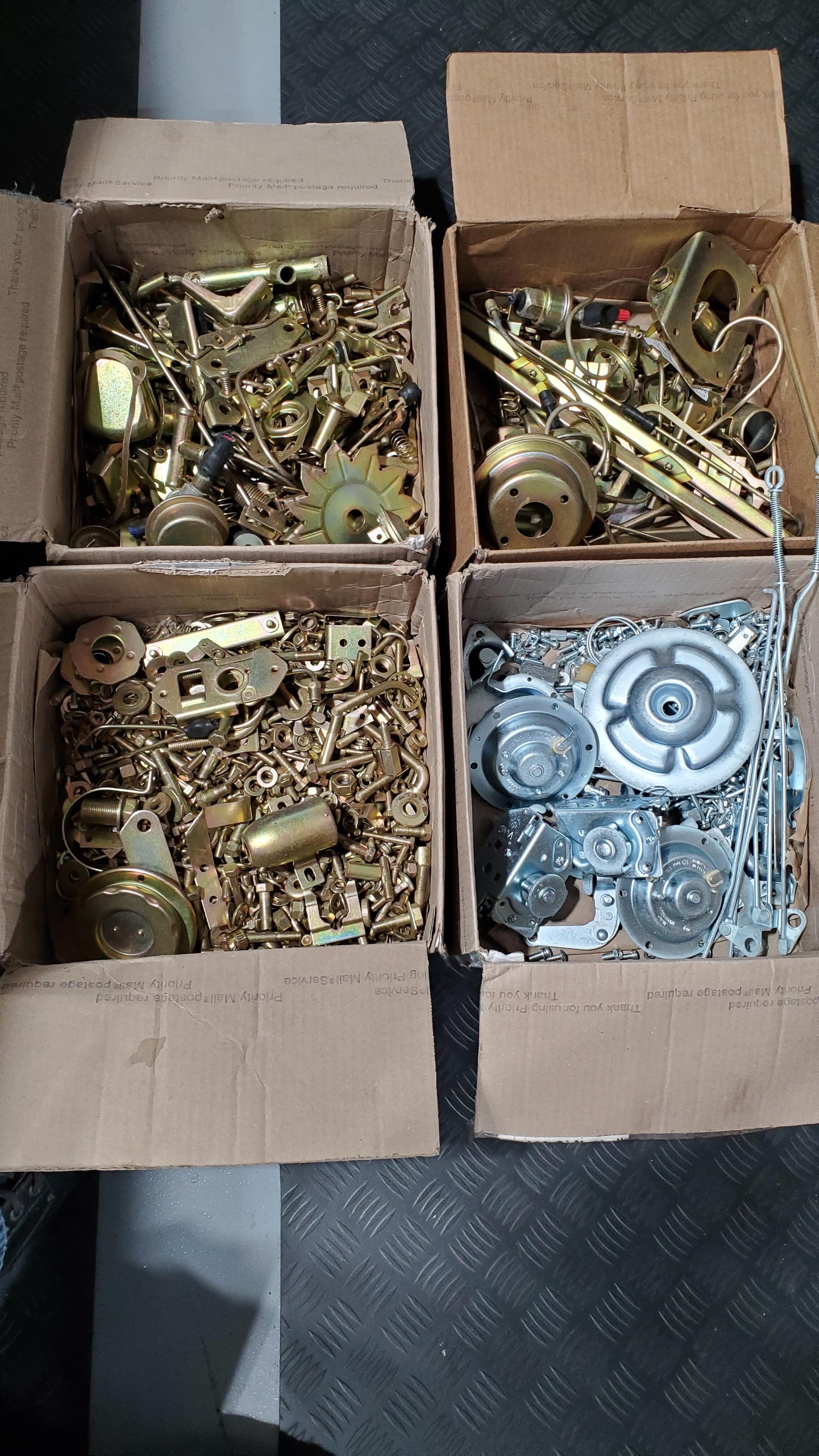

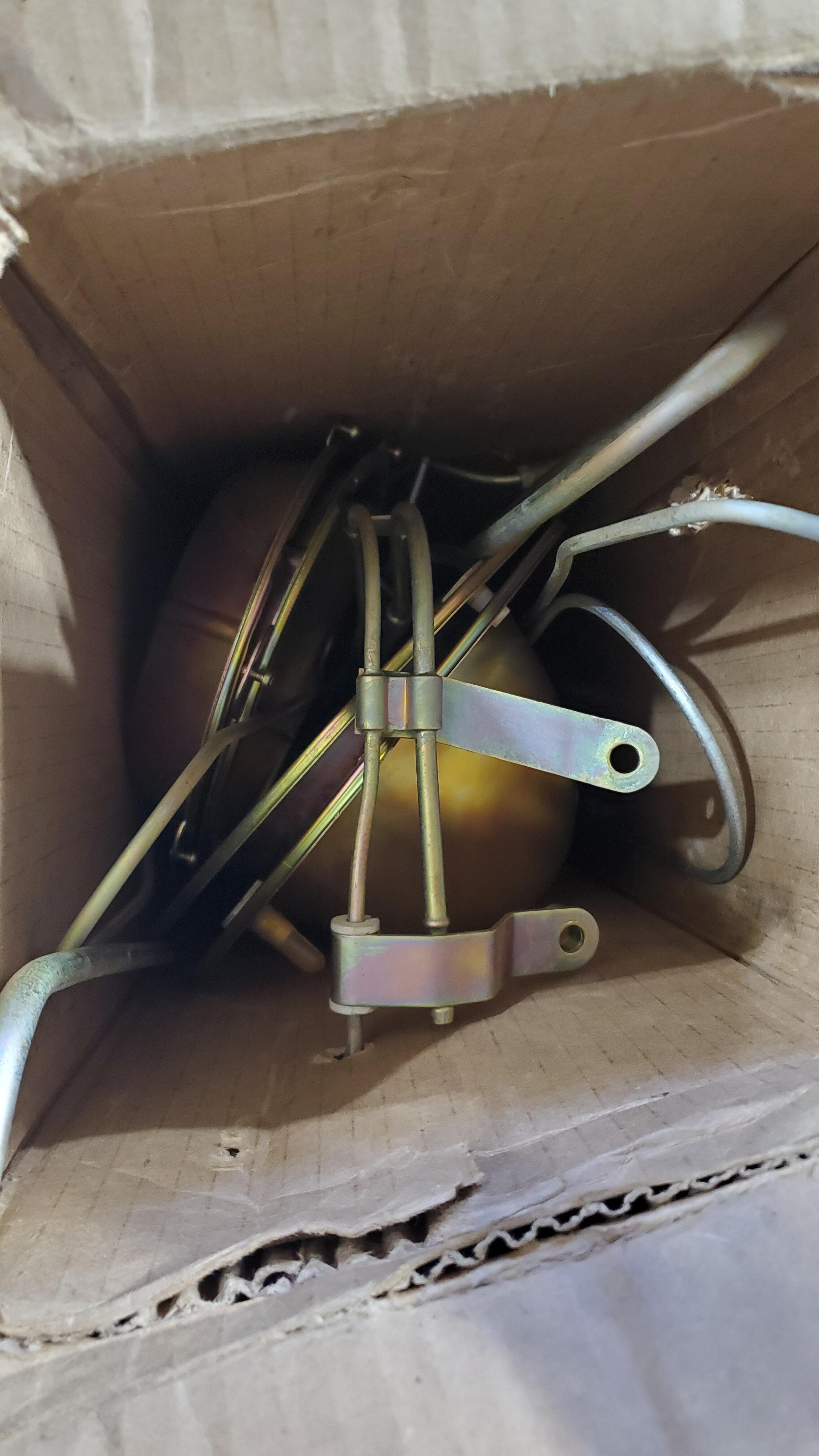

The fuel and brake lines were also sent to Sav-On plating. They were put in the large-long box in the earlier pictures.  They will be rack plated.

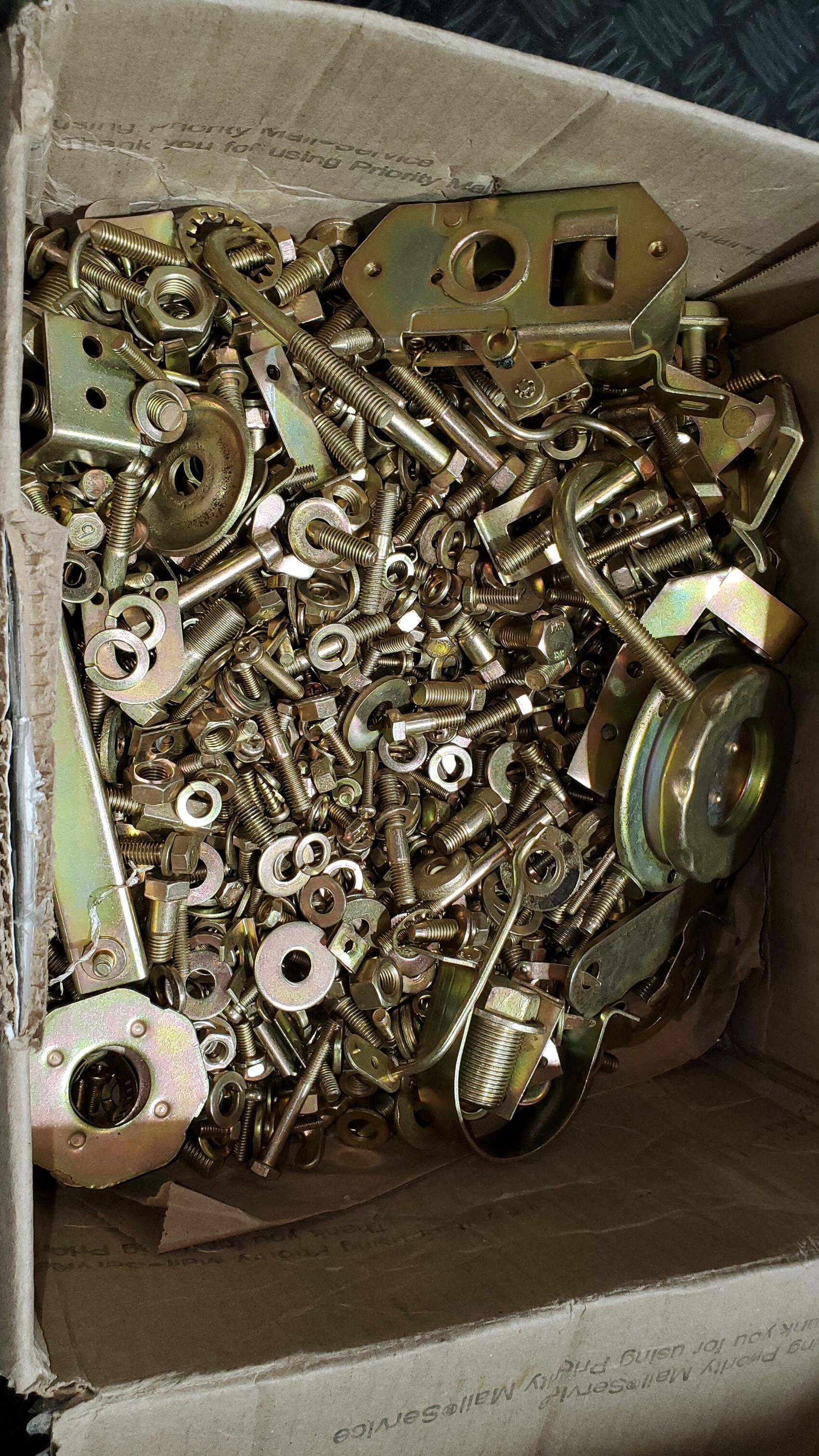

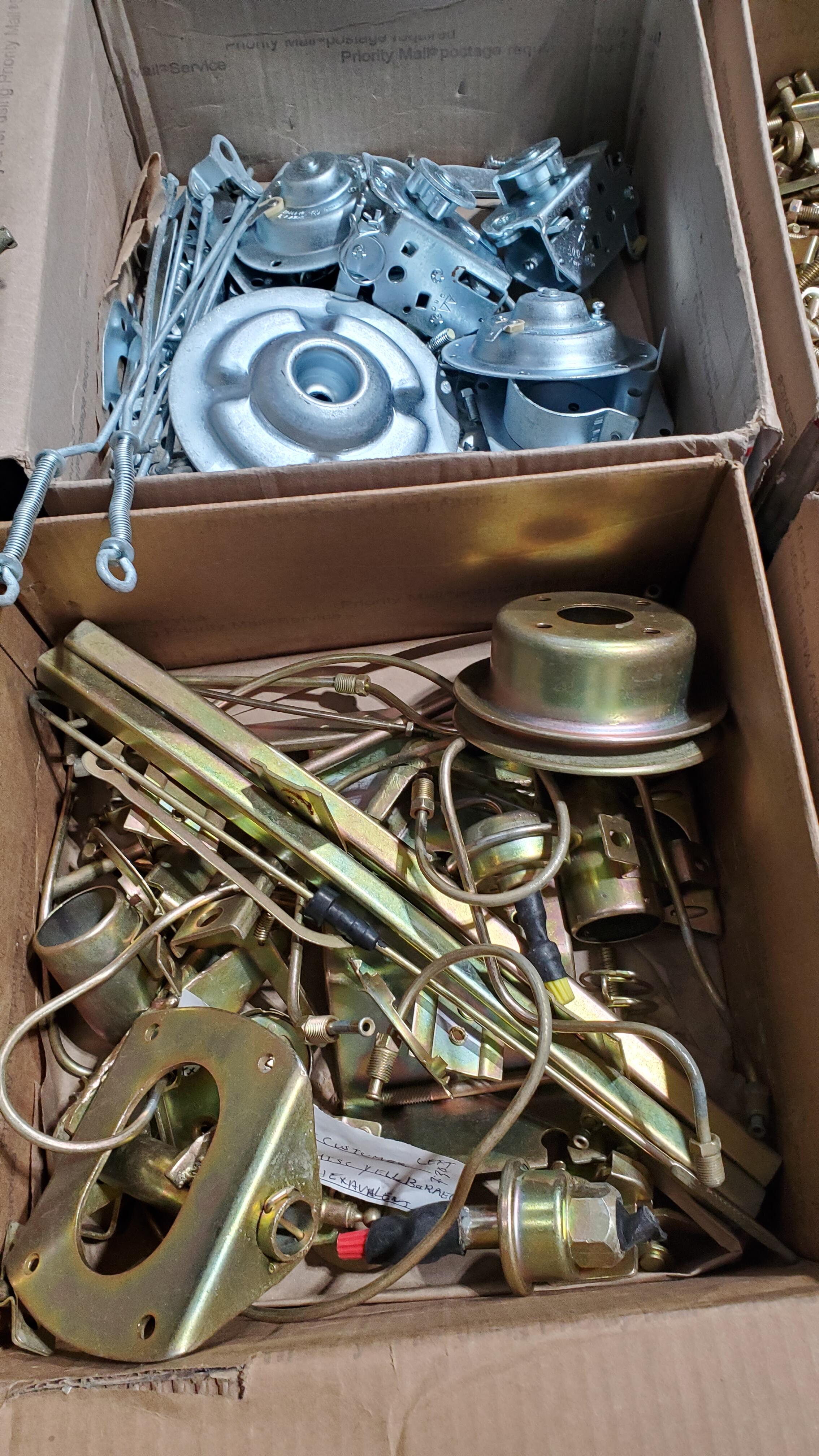

So there will be three plating batches run at the plating shop: one batch of barrel silver/clear zinc, one batch of barrel gold/yellow zinc, and one batch of rack plating gold/yellow zinc for the larger parts. Cost is roughly $250 per batch.

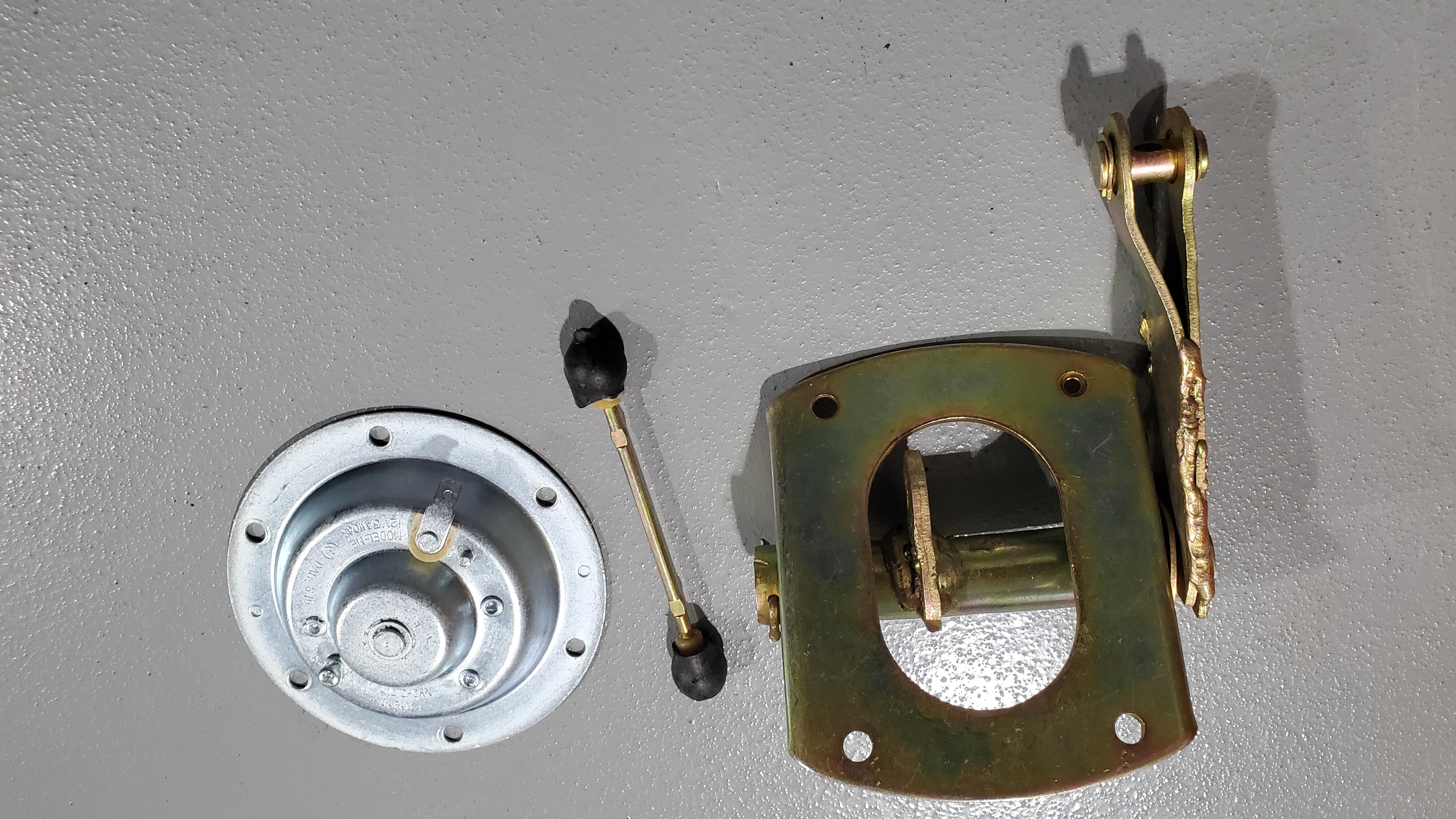

The smaller parts are processed in the 'barrel', and Sav-On does a good job of cleaning these. I  believe they are tumbled together for cleaning, so plastic portions of parts need protection. (I used shrink sleeve on the carb linkages).
Not sure what they do to clean the larger parts and tubing, so I clean these up better using solvents and light sand or steel wool.
Also, any parts with cavities need to be plugged or they will retain processing solvent and leak on your parts during return shipping. (Learned by experience).

No, I just put everything in a zip lock bag as I know the boxes will get beat up in shipping. Also, I do not overpack the bags, but everything fits comfortably, bags are cheap. I also add a little packing material around the bags.  Can't say that I have had any parts lost.  Even the small lock washers do fine and are returned nicely plated.

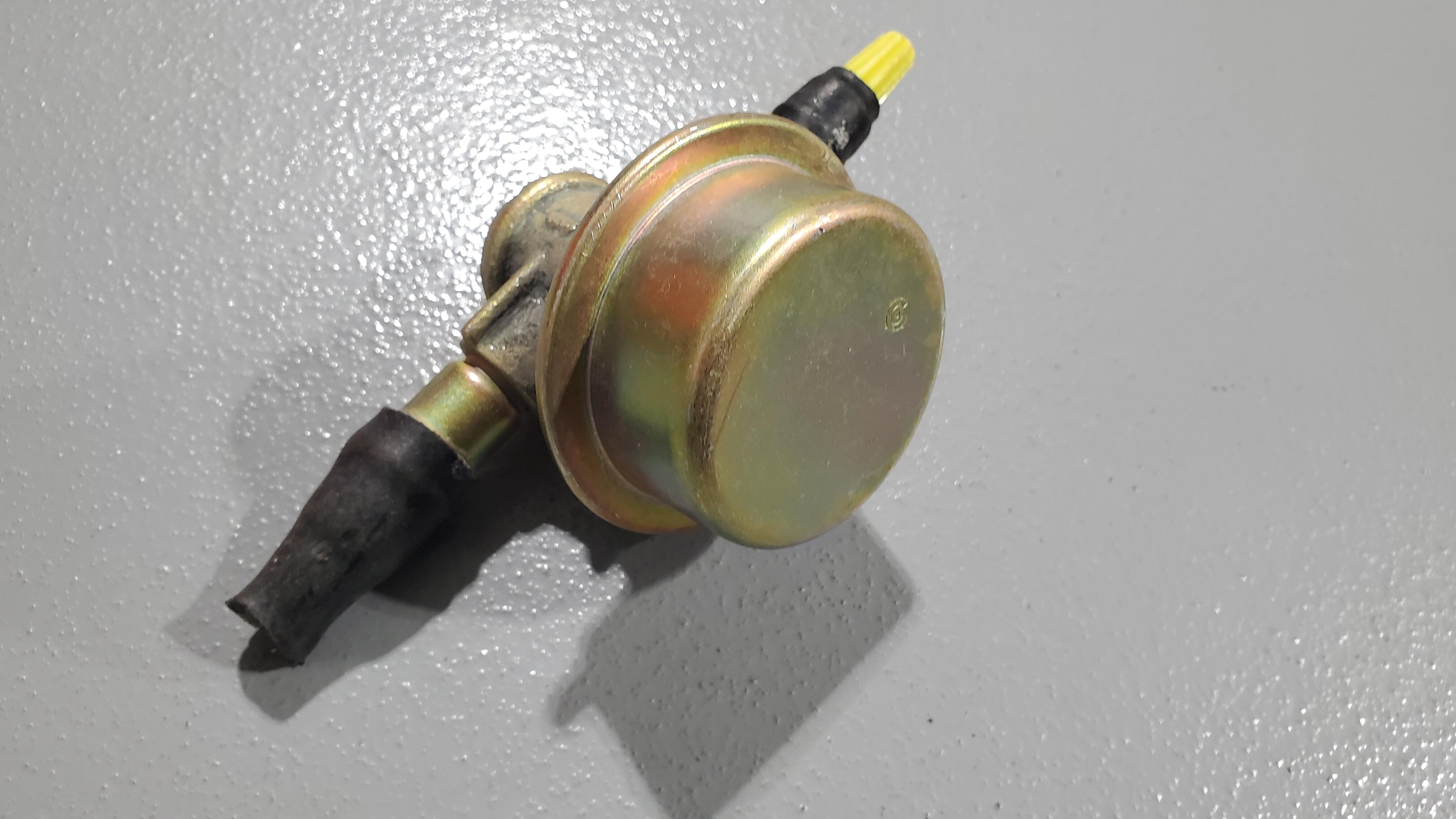

Only issue I ever had was a few leaky parts that dripped onto the batch and stained some of the plating on return shipping. (Smog check valve and distributor vacuum chamber are examples of parts that need to be plugged)
  • Thanks 1

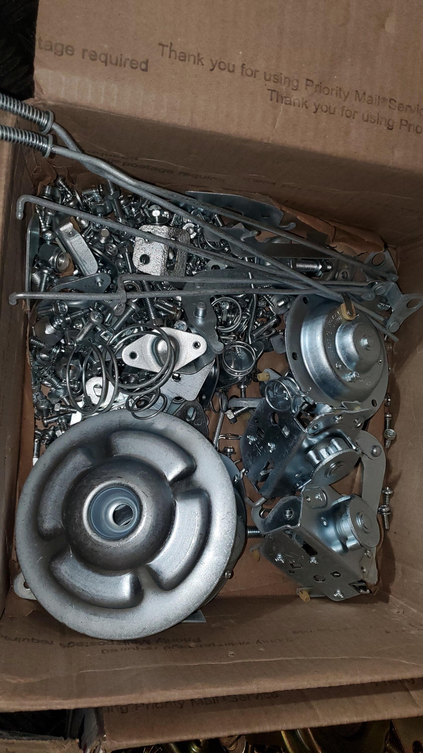

The Zinc parts came back from plating and look great.  Pictures are below.  Also shown are a couple examples of the shrink sleeve used to protect the plastic carb linkage ends and sealing of the cavities of the anti-backfire valve.

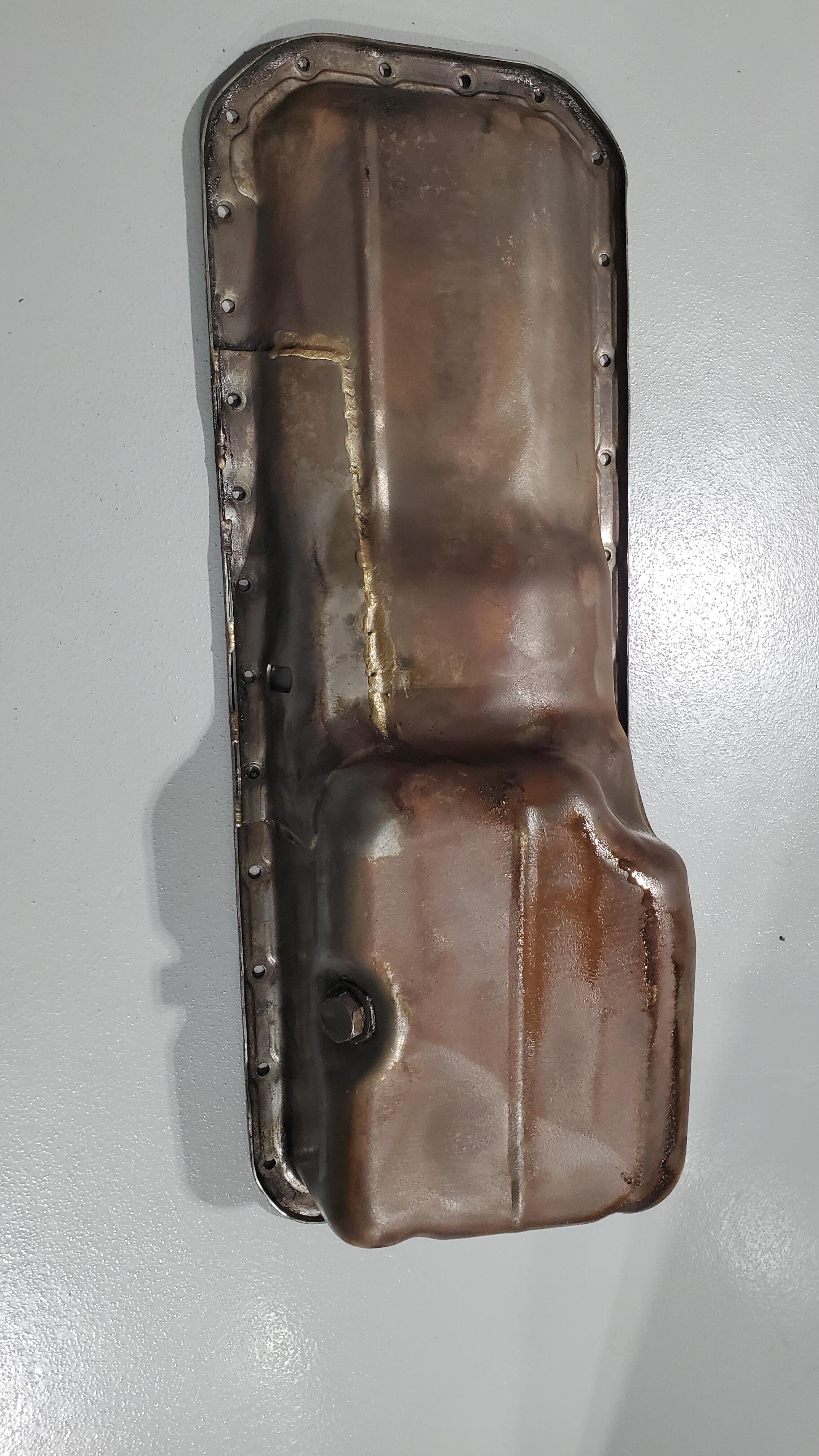

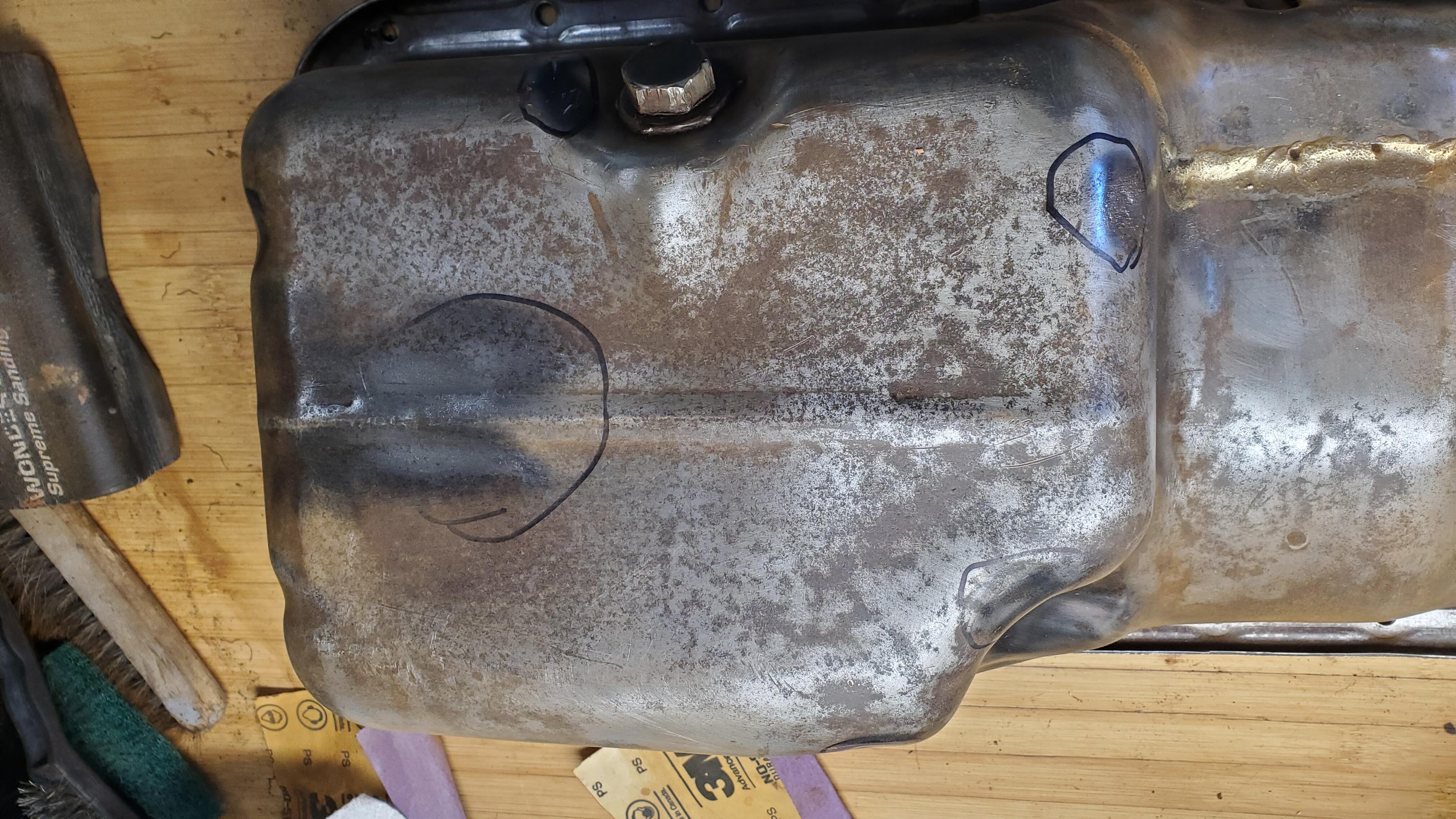

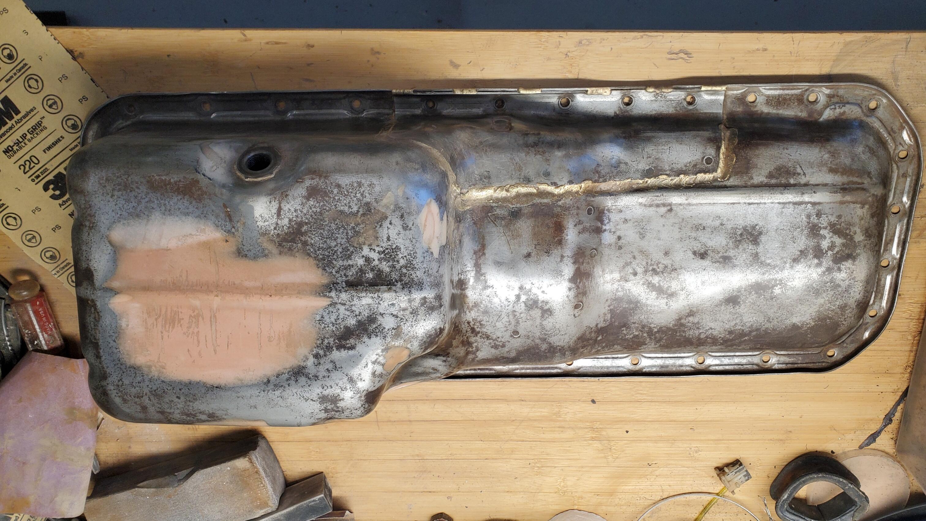

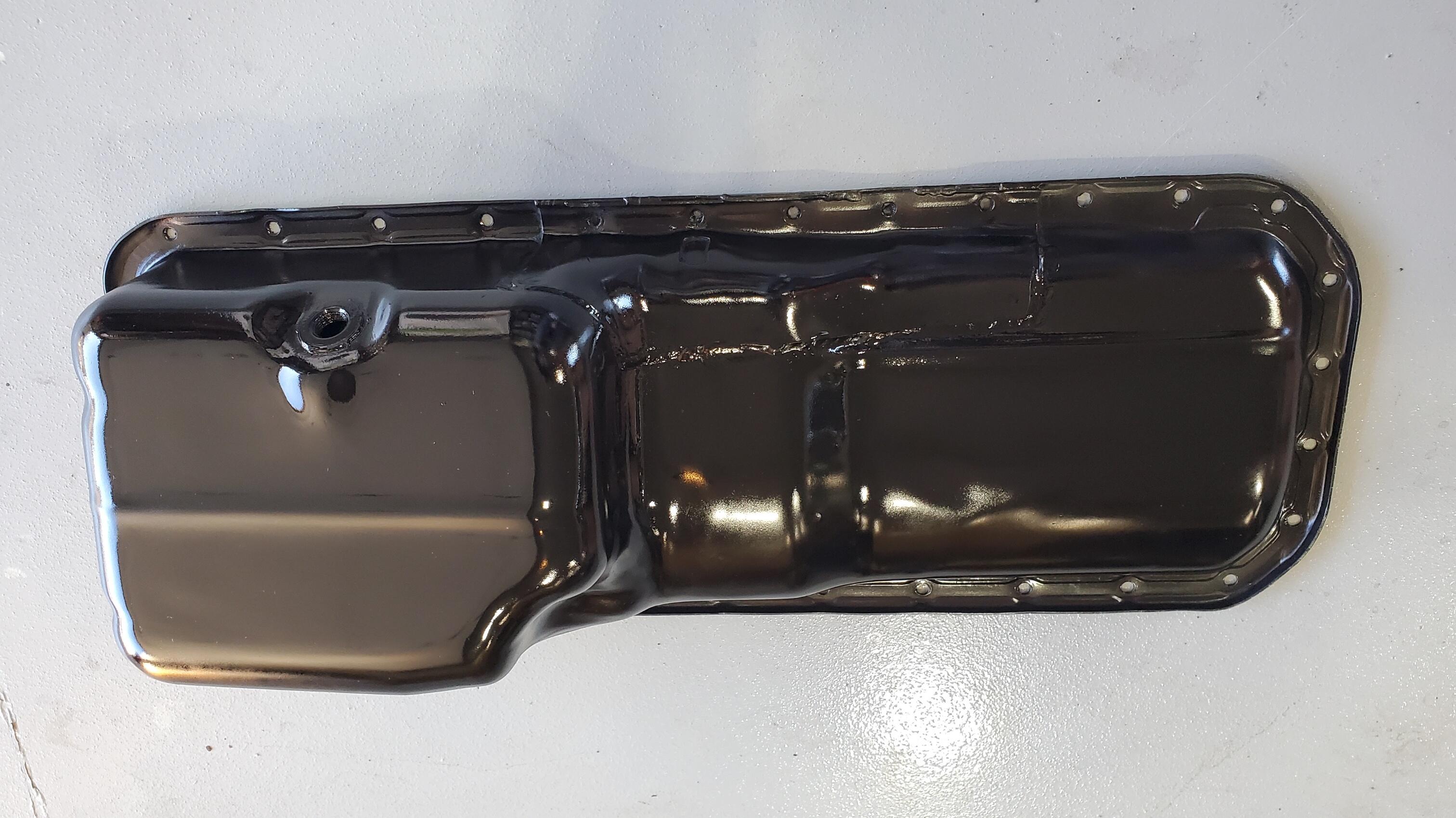

The oil pan had a few dings in it so I used a little bondo to smooth those out prior to paint.

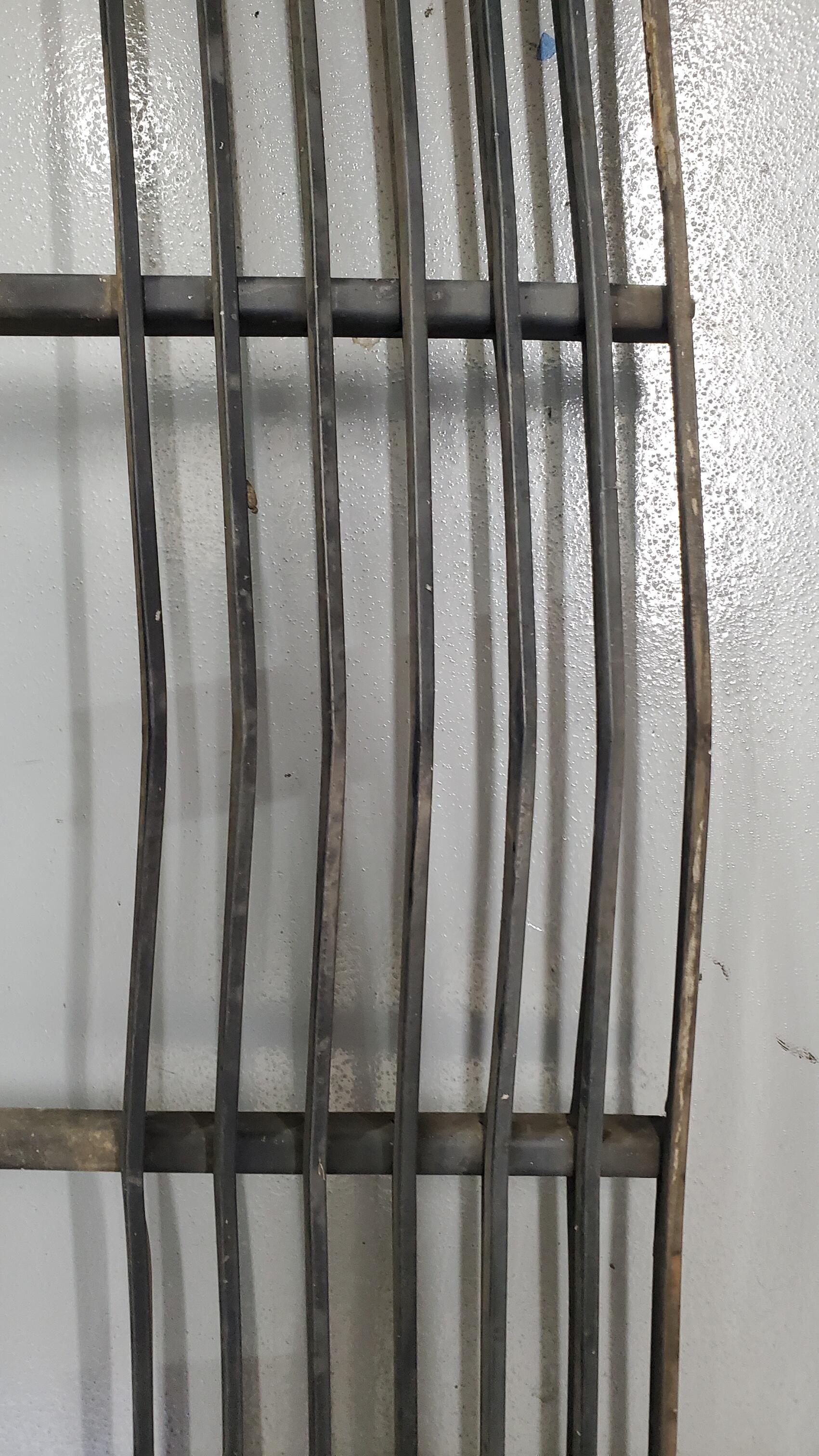

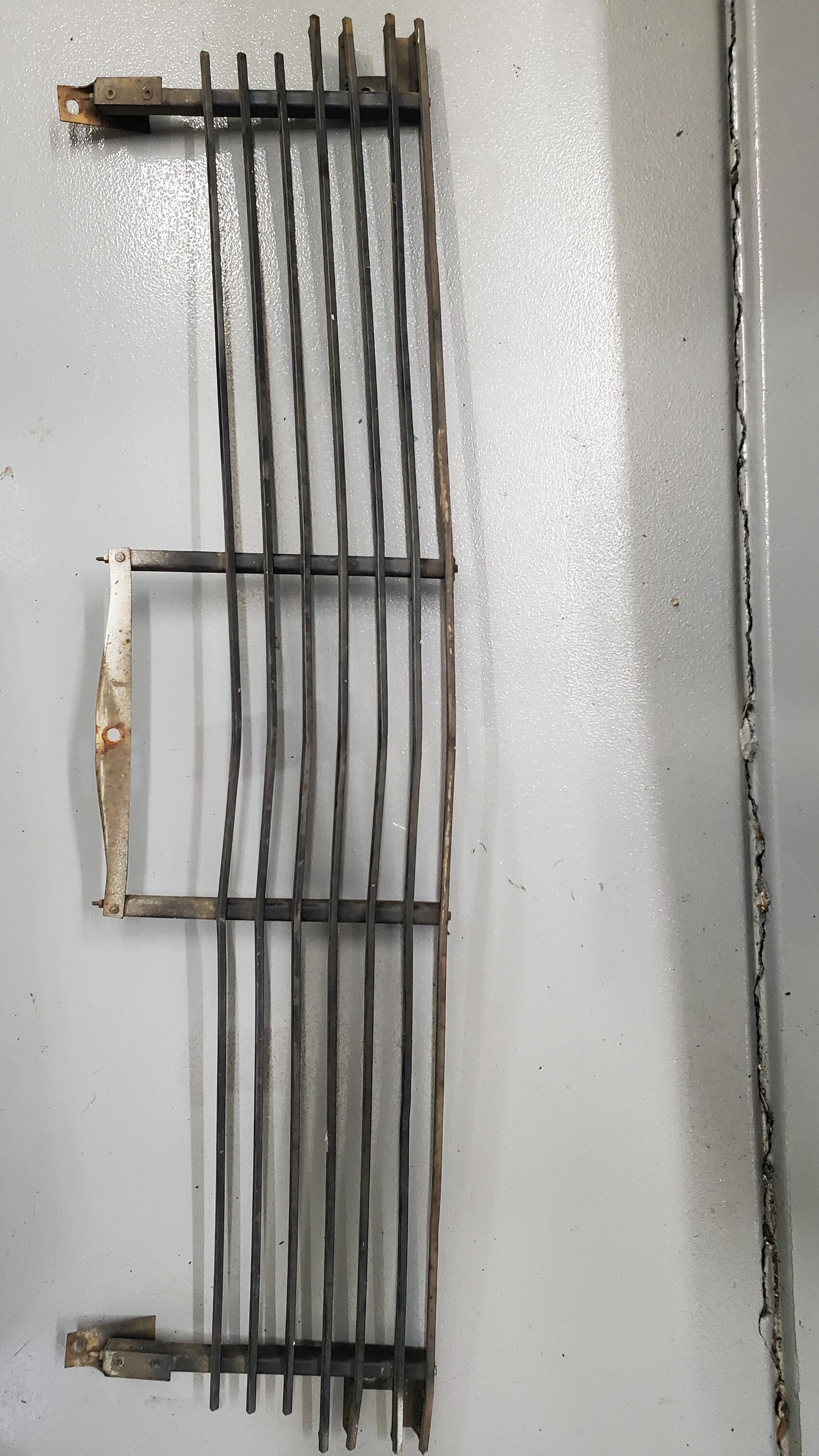

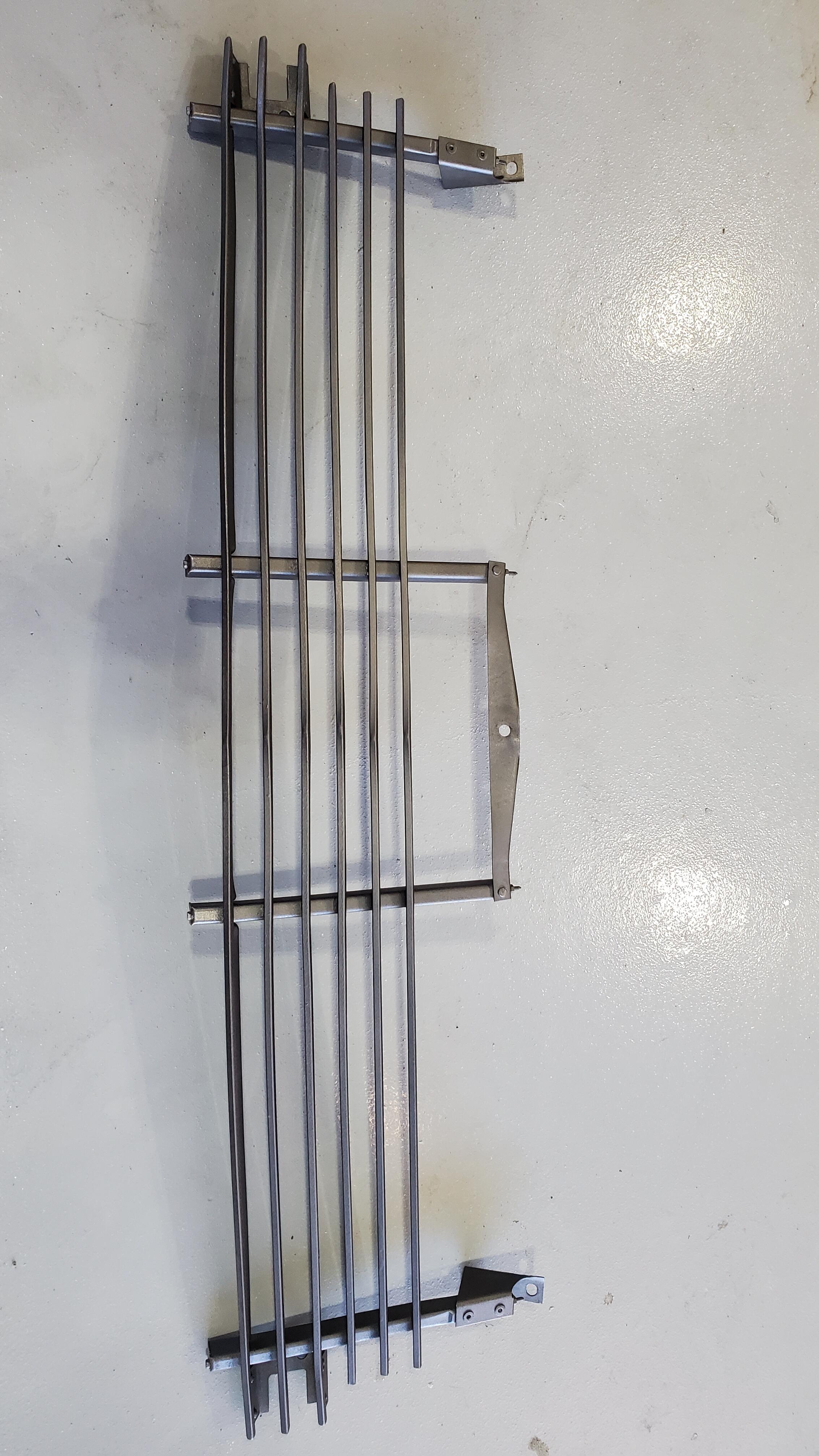

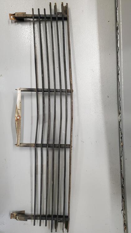

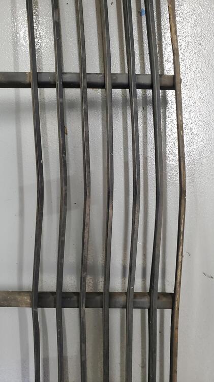

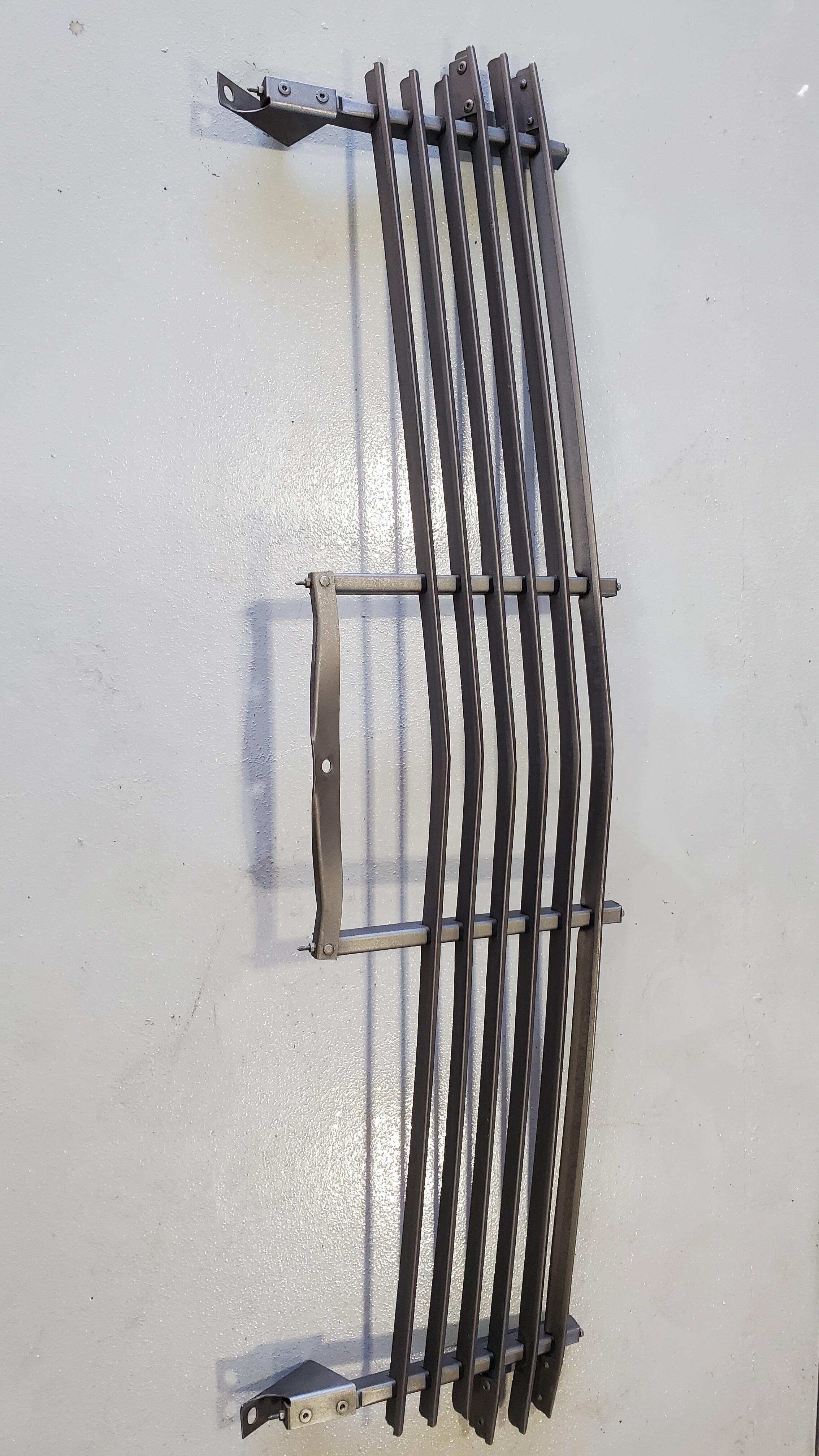

Front grill was a little tweaked, to I disassembled that, straightened the pieces, then re-assembled and painted.

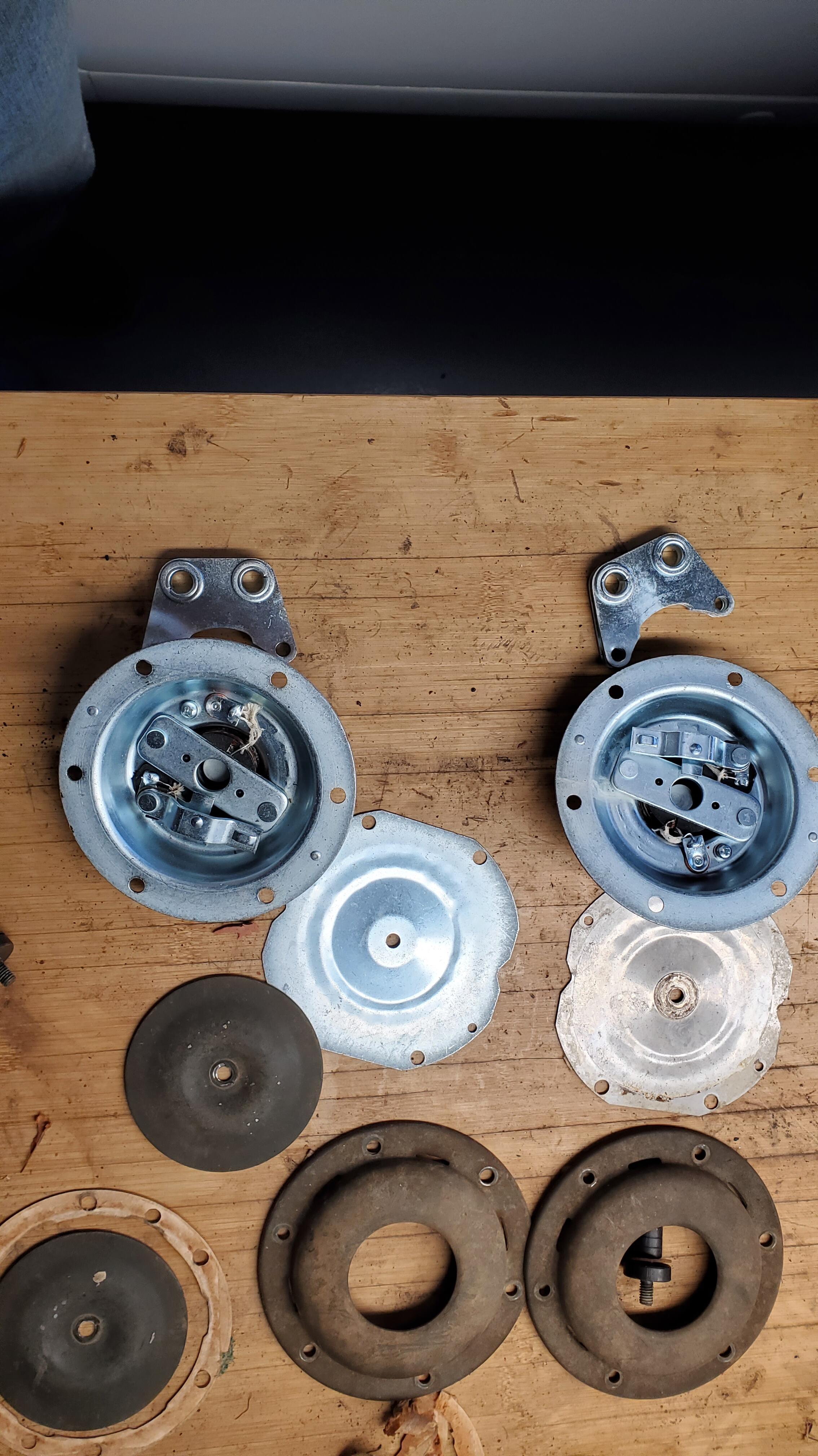

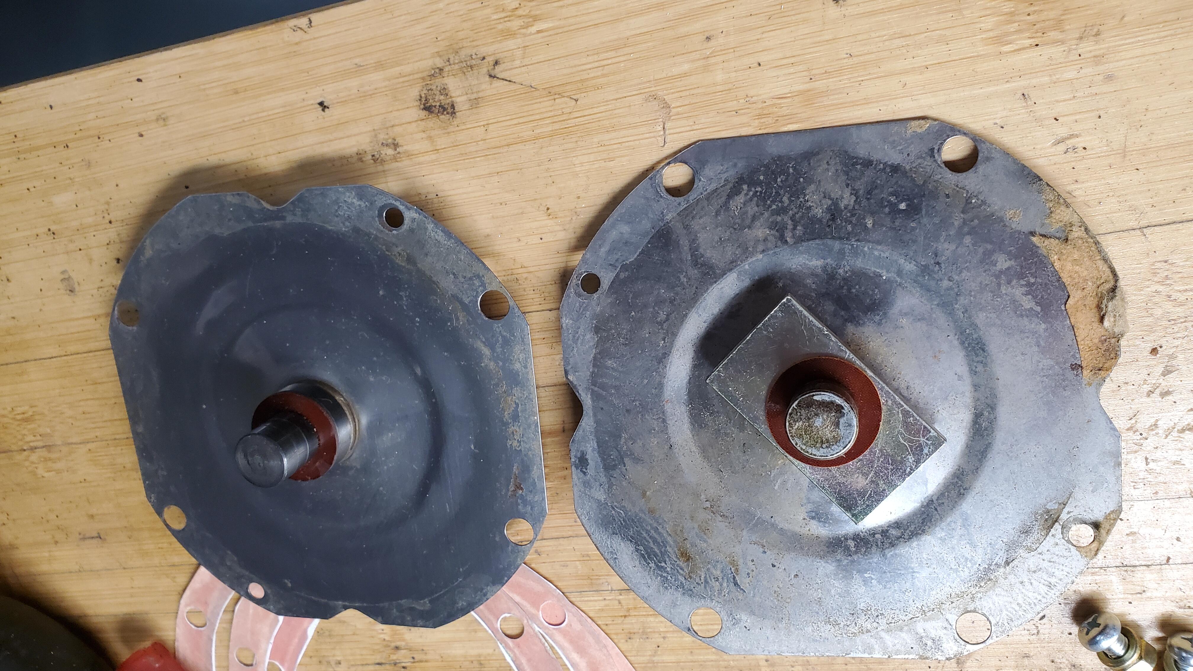

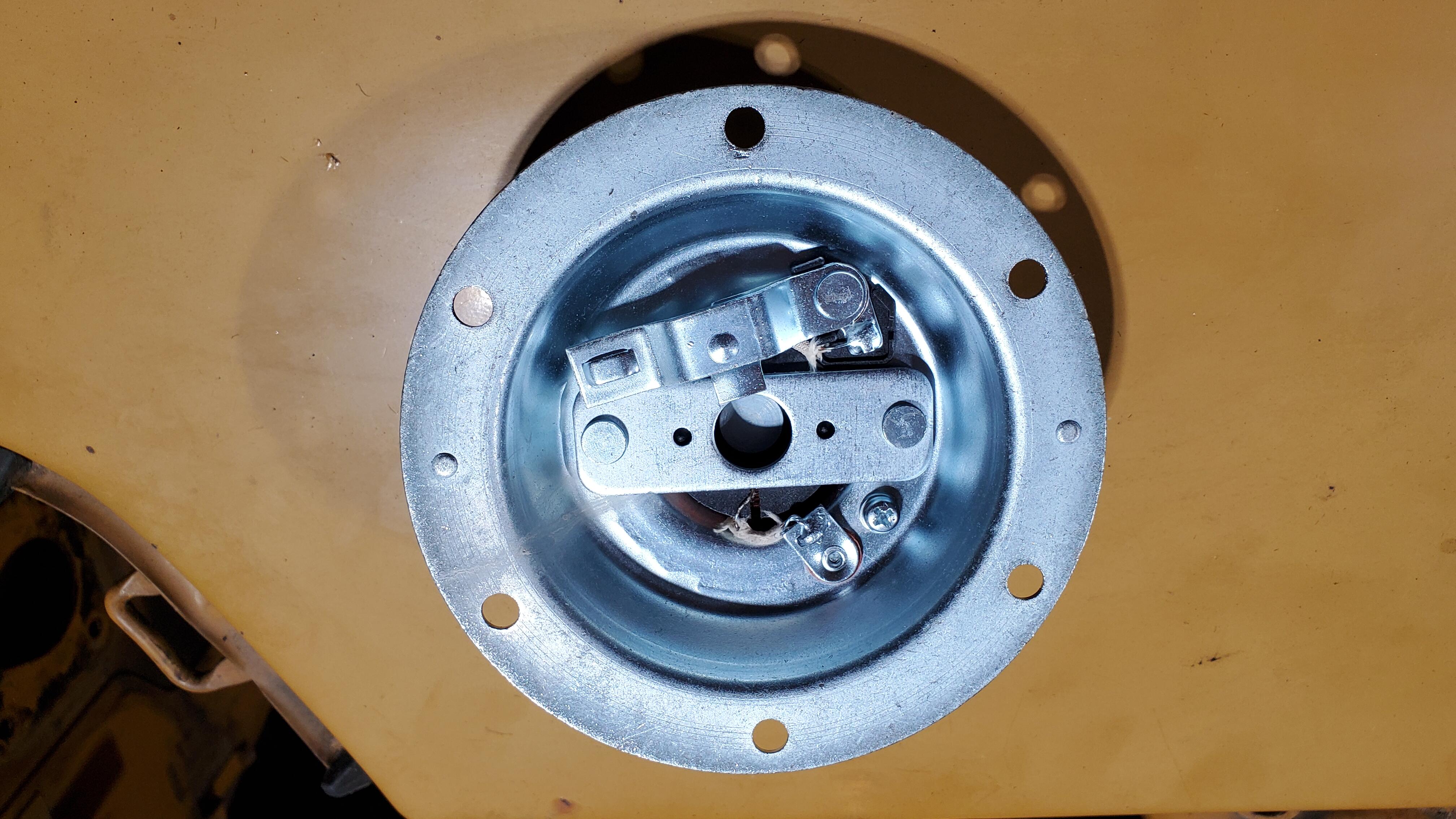

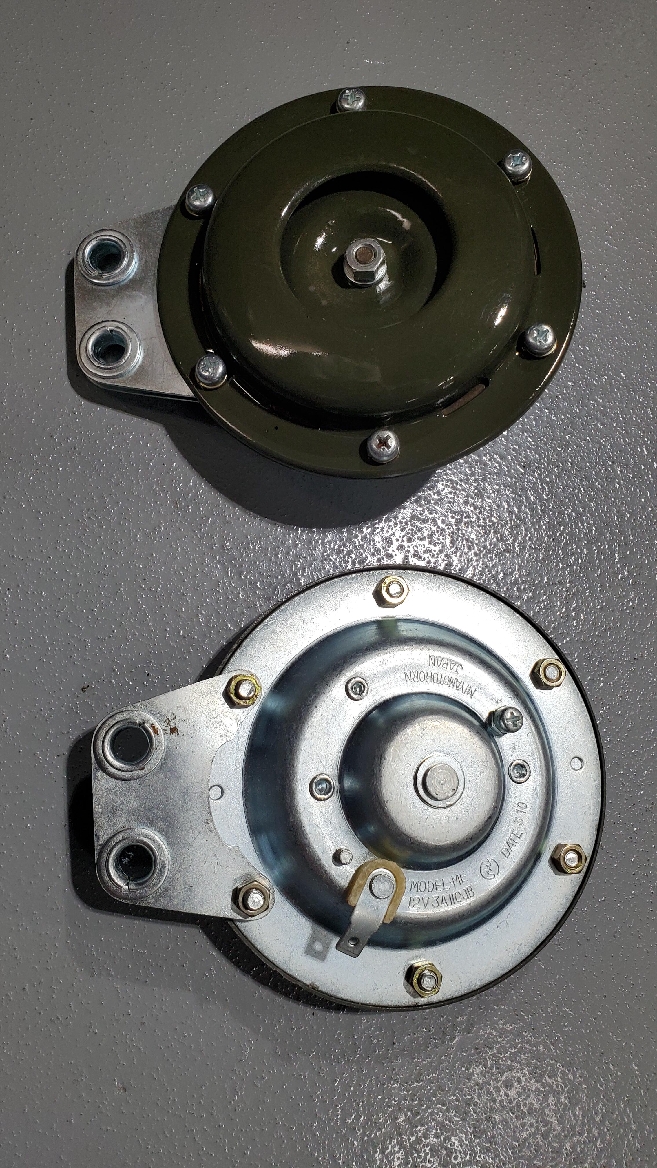

Since we were on the subject of horns, I just went ahead and rebuilt them. Pictures are below.

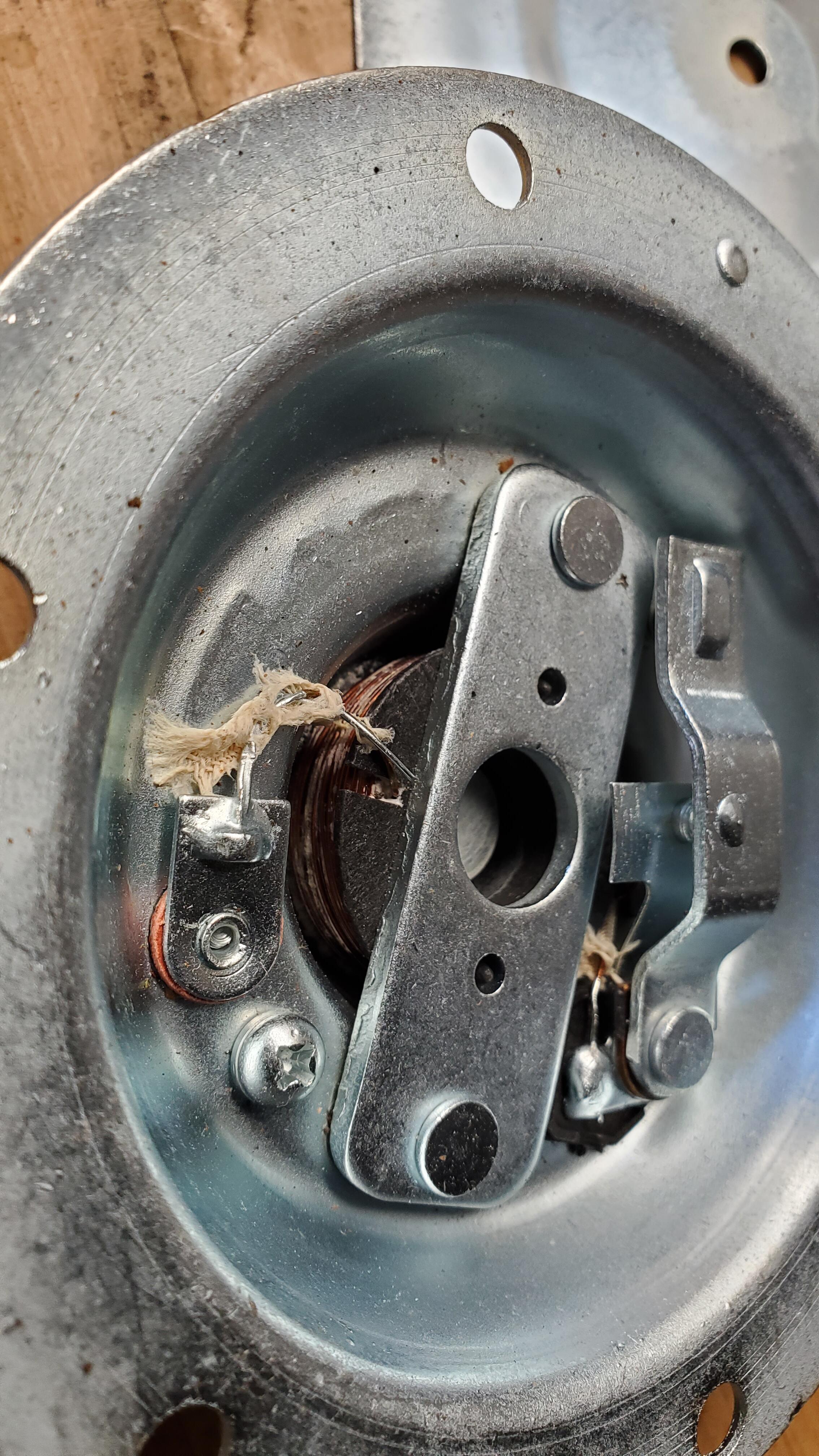

I  added a view of the horn coil.  You can see that the copper is not plated.  (Also, aluminum or any material other than steel will not plate)
Also, I noticed the inside of the horn has a round metal part versus the later rectangular part. Maybe that is unique to the early car horns?
I am pretty happy with the color of the horn front cover in its match of the original. I used a dark forest green camouflage paint with a clear coat for the color.

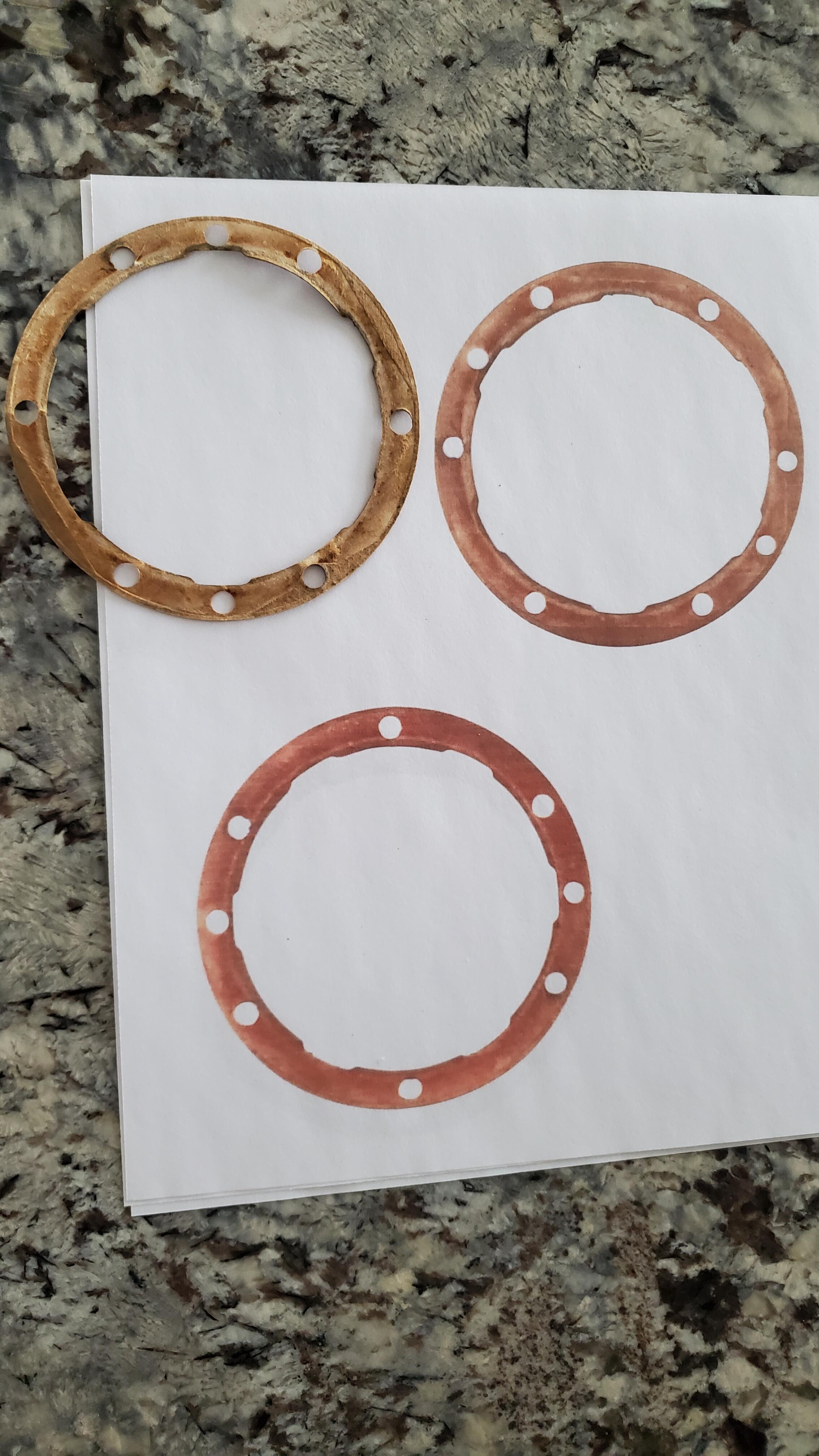

I was only able to salvage one gasket from the original horns out of four, so I scanned the gasket and made 3 more.
