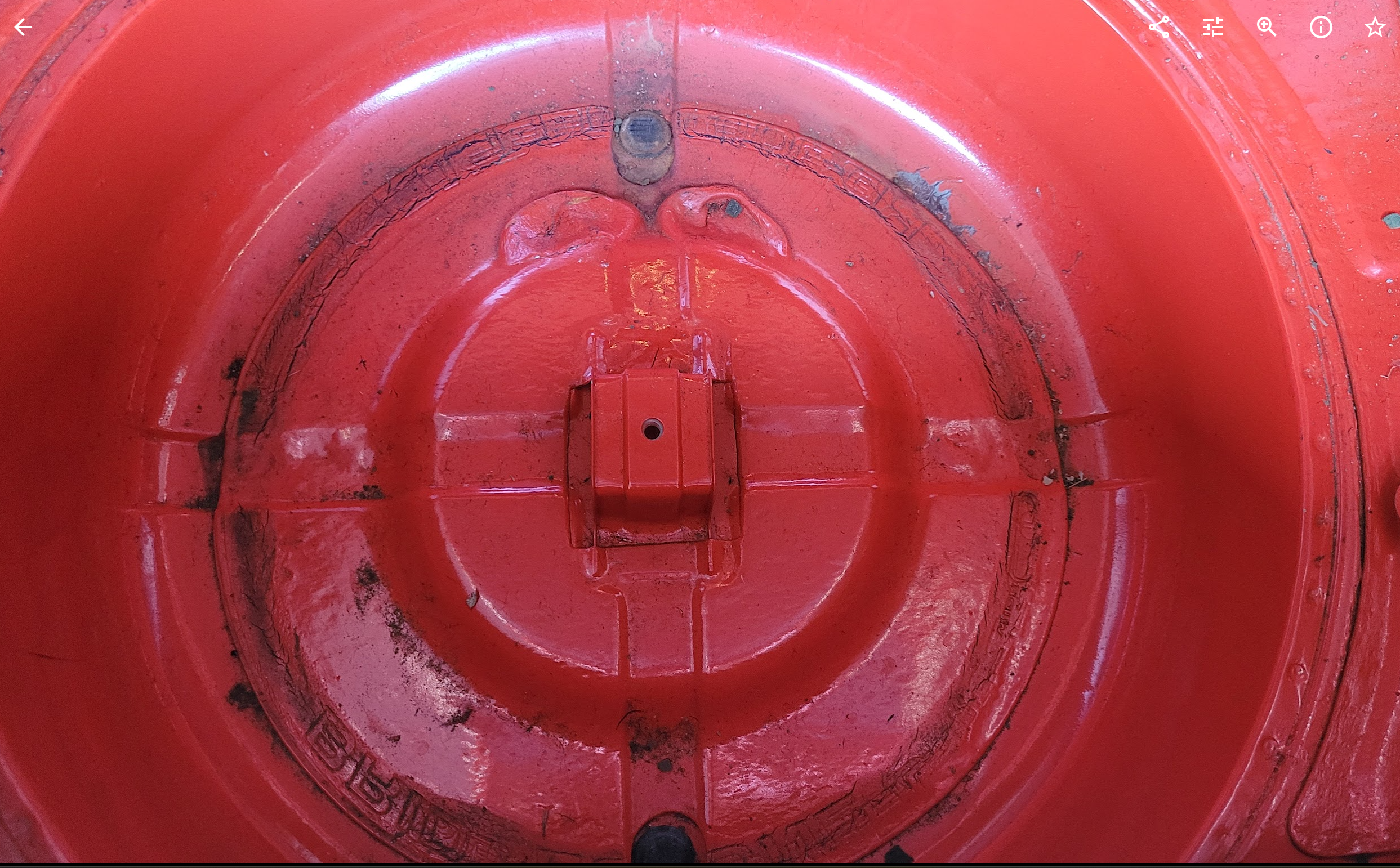

I dug around and found the original, old rusted-out one from may car...one drain hole.  So sometime between 5/71 and 7/76 they added a second drain hole.
Also, my 5/71 tub did NOT have a heat-shield on the side.
Here's a pic of a later tub that has the second (rear) drain hole and a heat shield.  I wonder when this change was made.
