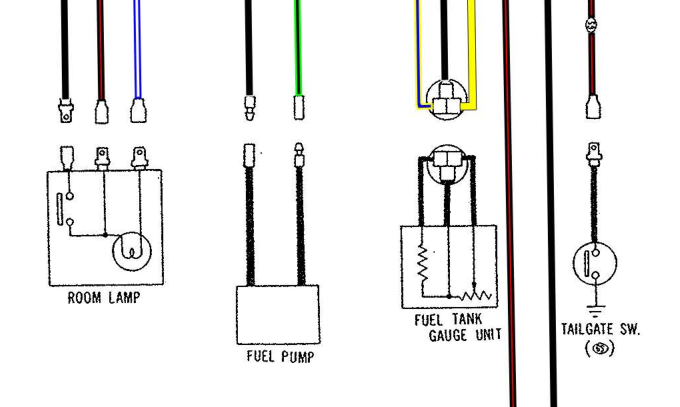

Those are good points.  Another that comes to mind is to pull the small wire from the starter solenoid, the one with the spade connector, and turn the key to Start.  The engine won't crank but the fuel pump should get power.  It's the Nissan recommended fuel pump test.  Usually you can hear it run if it's running.

I would find a way to check if the pump has power when the engine won't start.  You could check at the relay or check at the pump itself.  If there's power, make sure the ground is good.  If there's power and ground you have a pump problem.  Otherwise you have an electrical problem.
Many places to check the circuit.  The wiring diagram shows bullet connectors somewhere along the way.
