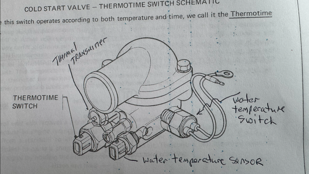

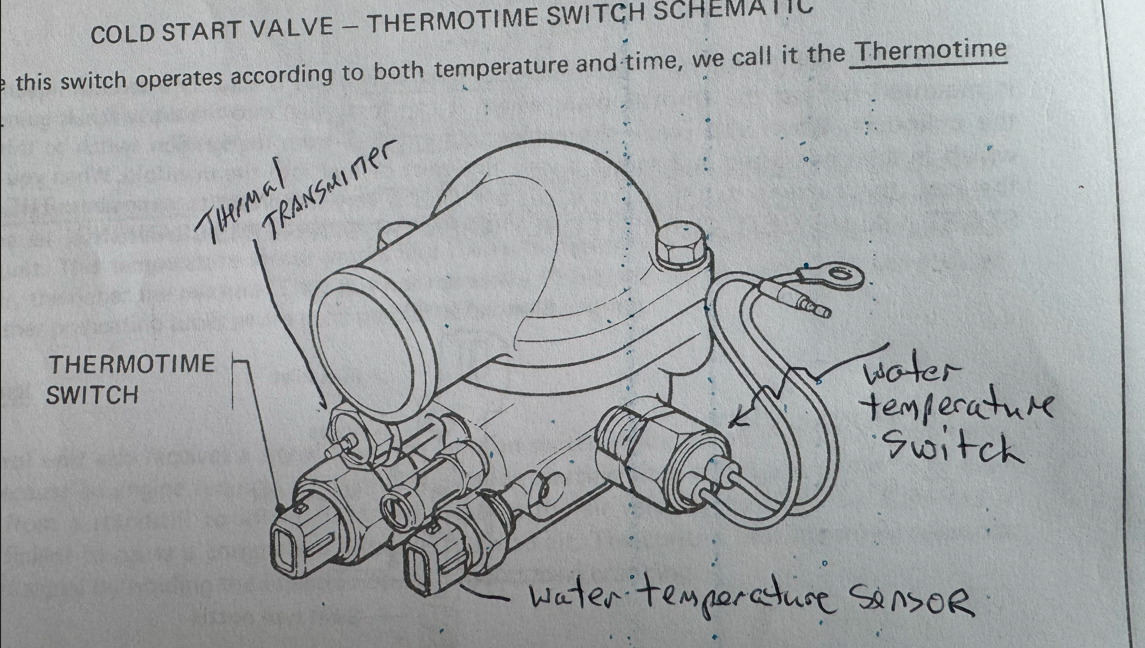

there are 2 sensing devices on the thermostat housing. Could either of those be the cause when the engine comes up to temp??
Can you post a pic of your thermostat housing?
There is too much equipment around the thermostat housing to get a clear picture. I have attached a diagram of the housing and various sensors that could be installed. I have all sensors except the  water temperature switch in my thermostat housing assembly,
