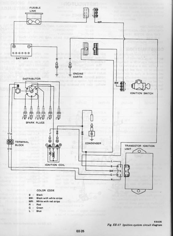

I don't think that that diagram is for a 1978.  Pre-78 Nissan did have a water temperature switch for the dual point distributors.  But 78 uses the single point distributor.  And the EGR system uses a heat activated siwtch.
