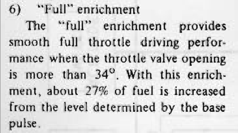

The clues point to a lean mixture.  The very common 280Z EFI problem.
Or, maybe it never gets the 27%.  Maybe the TPS never shows WOT.  Could be a TPS problem.
It's not clear when "sluggish" occurs.  WOT or cruising.  That would be another good clue.
