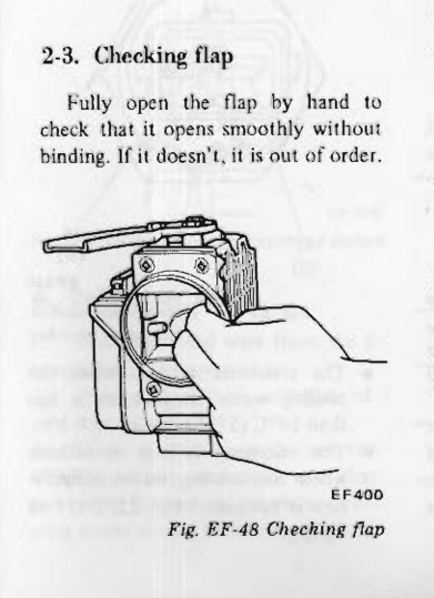

If I recall correctly the very early AFM's did not have a back/front fire protection spring on the AFM vane.  It was added later.  So Nissan was aware that it could damage the AFM.  The simplest check would be to confirm that the AFM vane moves freely.  Your AFM might be out of order.

I have a '78 so if front fire protection was added later-on, I should have it.
I just went through the FSM's checks both with moving the flap and all of the multimeter tests and everything came out in spec

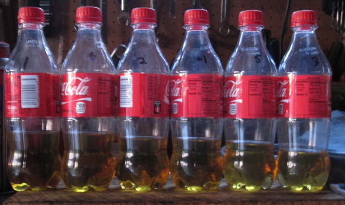

Maybe all of the chaos broke some junk loose and clogged some injectors.  My engine still ran well with these, below, after I replaced the AFM.  Those injectors came with the car.  But it ran a lot better with new injectors.  I probably never needed a new AFM.

The car's injectors are probably around 2 years old
