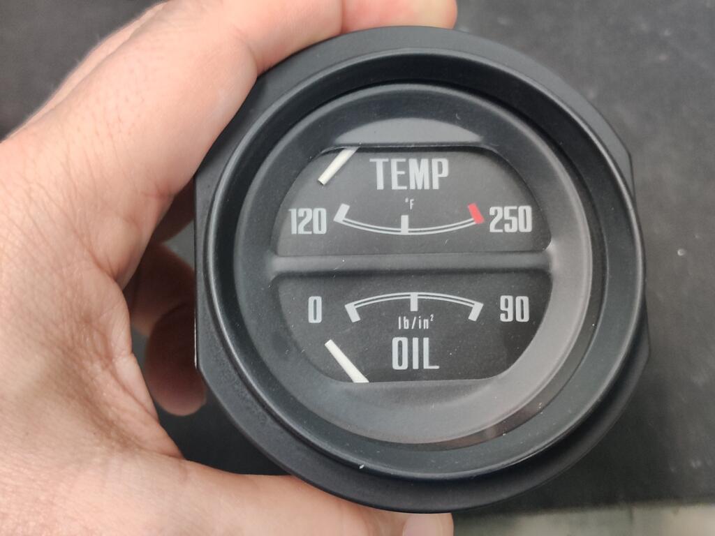

I do not know what my oil pressure is.  I have not hooked up a mechanical gauge.

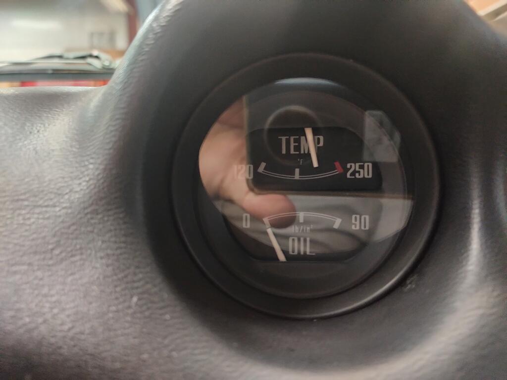

Today, I noticed that when I set the key to the on position, both the temp gauge and the oil gauge needles move from their at rest positions.  I never noticed that before.
The temp gauge needles moves from pointing directly at the 2 in 120 to just a tad bit closer to the 0 in 120 (my laser gun indicated 70 degrees at the temp switch).  And the oil pressure gauge needle moved from below 0 to pretty much right at 0.
When I start the car, the oil pressure as indicated on the gauge goes up to almost max (90).  When idling at a stop light, it is barely off of 0.

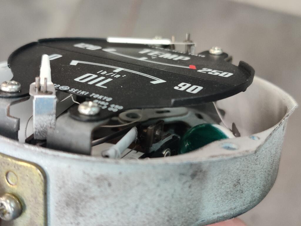

I messed with the bi-metallic strip in the temp gauge today.  I was able to get only slight improvement.  Feels wrong to attempt to mess with it more.  I think the bi-metallic strip would have to be drastically messed with to get the gauge to read correctly.
I drove the car around for a few minutes to get the engine up to normal temp.  I shut it off and took this pic after quickly returning the key to the on position.  Temp needle is a bit lower than it what it was before messing with the bi-metallic strip - oil reads at 0 (it reads below zero with key off).
My laser temp gun aimed at the sender switch showed about 146 degrees fahrenheit with the temp needle in this position in the gauge.

I noticed that when I set the key to the on position, both the temp gauge and the oil gauge needles move from their at rest positions. The temp gauge needles moves from pointing directly at the 2 in 120 to just a tad bit closer to the 0 in 120 (my laser gun indicated 70 degrees at the temp switch).  And the oil pressure gauge needle moved from below 0 to pretty much right at 0.
That all sounds normal. The gauges should move off their seats when you turn the key to ON.

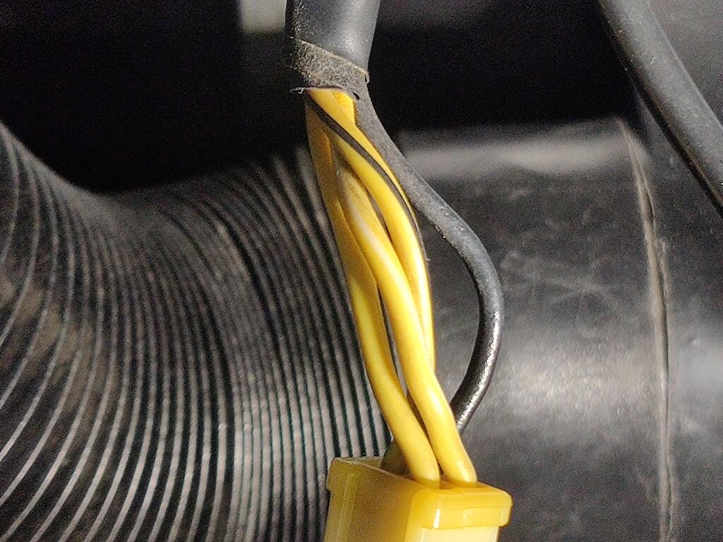

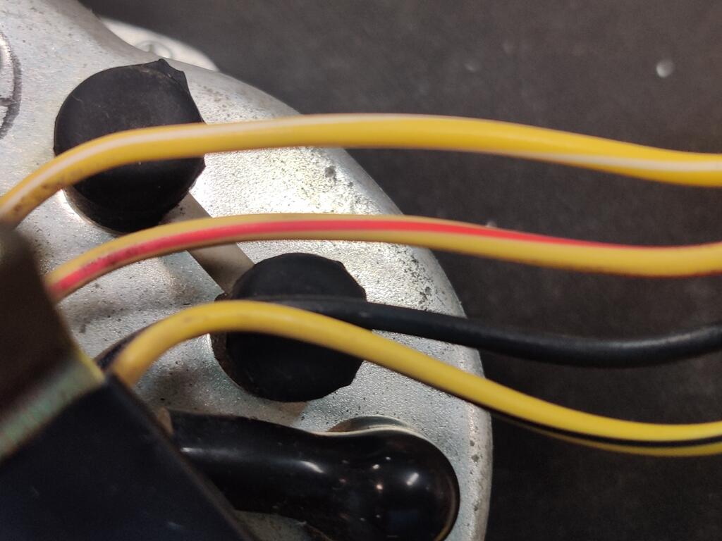

The wiring diagram says the sender units connect to a yellow/white wire (not straight yellow), but that may be on the chassis side of the gauge connector. Sometimes they changed wire colors at the connector right there at the gauge. So if it's as simple as Y on the gauge side and Y/W on the dash harness side, then yes... Your bench test connection plans should work out fine.
No, you do not have to have the sender unit (either of them) hooked up. It won't cause any damage, but the needle will just rest way down at the bottom. So you can let the oil pressure connection hang open while you are messing with the temp side testing.

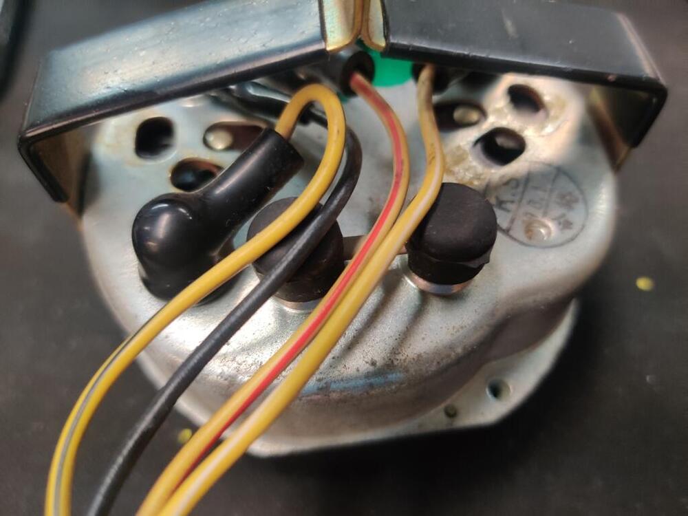

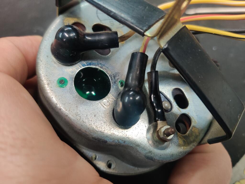

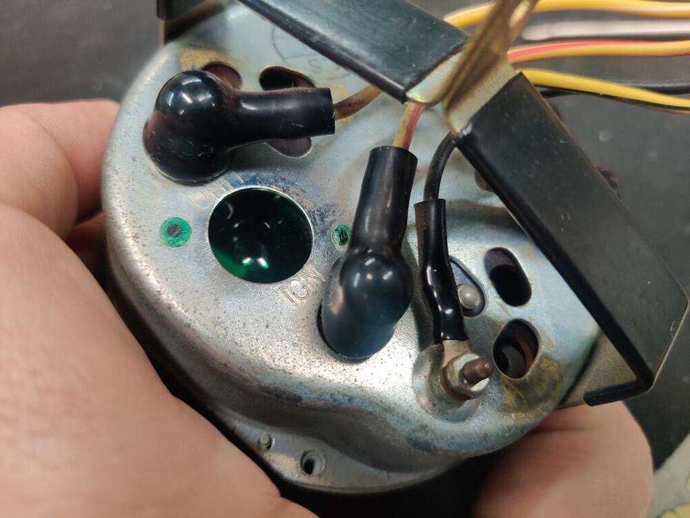

Can you snap a couple pics of the gauge? Some of the connector leading to the gauge, and maybe something of the corresponding connector on the dash side. So we can confirm the color change there at that connector?

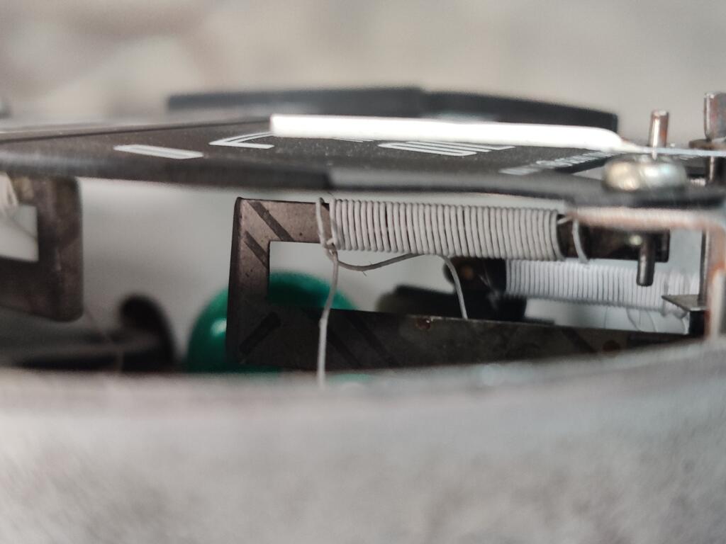

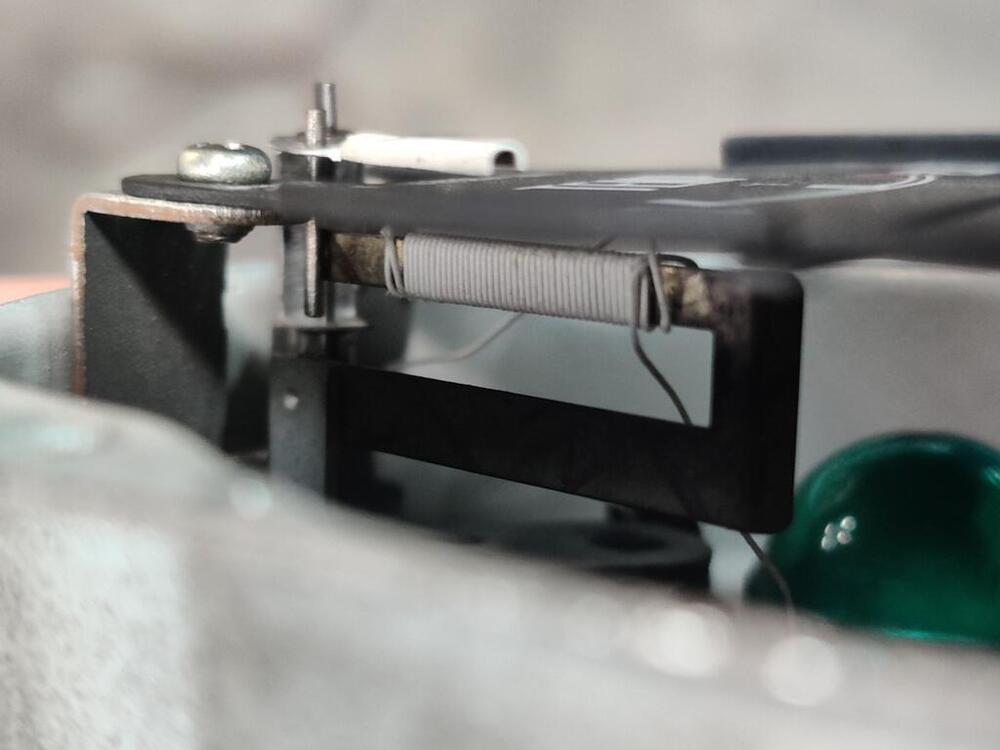

Also, can you snap a pic of the inside of your gauge so I can see the wiring and the adjuster (if there is one). The pics I've been posting are from 280 cars. I assume the 240 stuff is the same, but I've never been inside the early 240 gauges to confirm.
Dash harness wires:
gauge wires:
Inside gauge:
Connections on gauge:

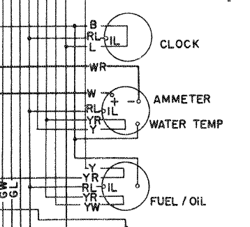

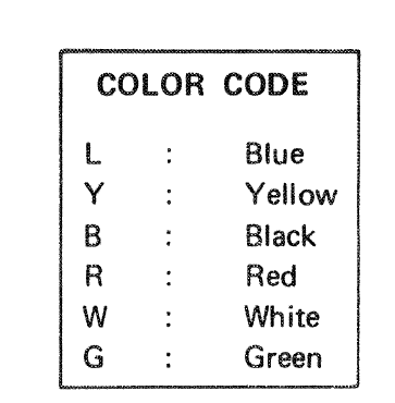

I didn't see the white strip before.  I just glanced at the factory 1971 workshop manual and got the color codes:
Funny how that has the ammeter and water temp in one gauge and the fuel and oil in the other!
Yeah, there are a bunch of mistakes in the early wiring diagram. Another example is that the wire colors on your car are not the same as the diagram. The diagram indicates that both TEMP and OIL use yellow/white, but your car uses yellow/black for one of them.
So a while ago I worked up (what I think is) a better version of the diagram and fixed some mistakes as well as cleaned things up a bunch. I've not uploaded my latest version, but here's the thread where we talked about it:
https://www.classiczcars.com/forums/topic/69026-1970-wiring-diagram/
Which of the gauges uses the Y/B wire? Does that go to the TEMP, or the OIL? I'll change that on my diagram.
And let us know how the bench testing goes.
Y/B goes to the oil pressure.
