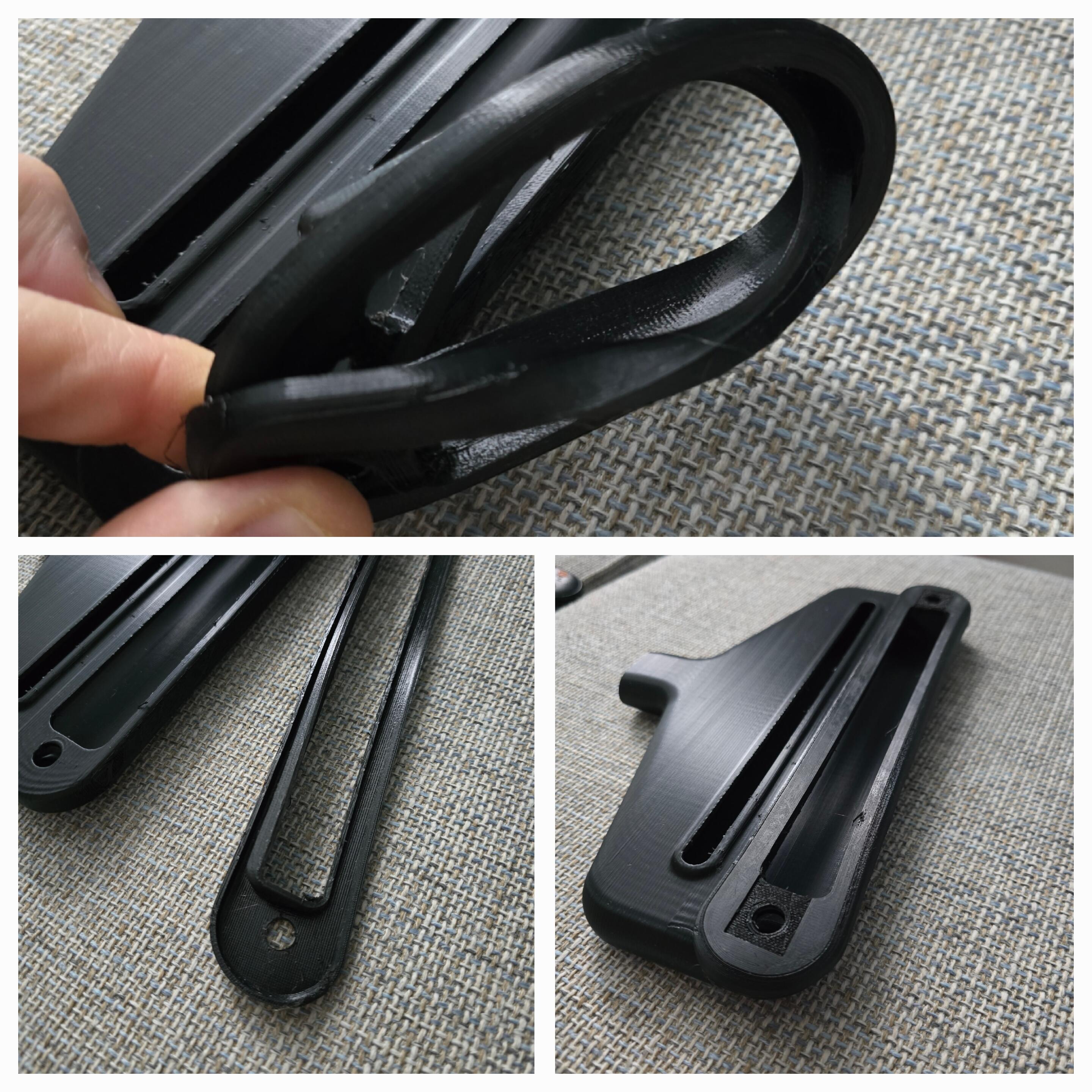

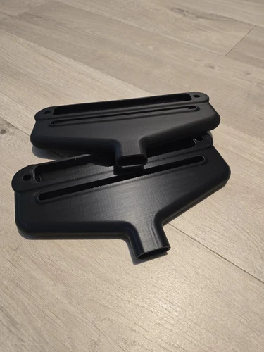

3 hours ago, GoldAir said:
No sooner had I sent the above, did I notice this product from the same seller.
Look like the vent duct (exterior) and the plenum (interior).
I would get those from Steve at 240zrubber
https://www.240zrubberparts.com/product-page/240z-series-1-hatch-vent-duct-system-gasket-set
So to recap:
to my knowledge the hatch vents were always plastic.
You need the grills
The small barrel nuts
the small clips that latch the ducts to the hatch
The duct seals
The ducts and the short tubes that connect the ducts to the hatch exit holes
Pages 74 & 75

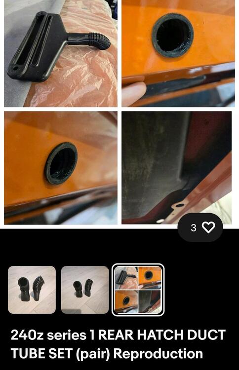

Just saw this thread, these are the parts I make,
The gasket shown is made in a flexible TPU
£69
https://www.ebay.co.uk/itm/167047639467
I also made the drain tube, i designed them with the the bend in place- as the originals seem to fail over time
https://www.ebay.co.uk/itm/167055704650
£50
