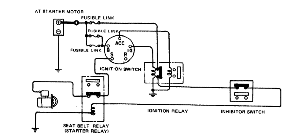

There's actually a relay and and a switch in the starter circuit.  The relay is one of those two function relays, connected to the inhibitor switch.  So, there's three possibilities there - a bad relay, a bad inhibitor switch, or a bad inhibitor switch actuation.  I don't understand how the Inhibitor Switch works, but I think CO and SteveJ do.  Might be that there's a seat belt switch that actuates the Inhibitor Switch which then actuates the Starter Relay allowing the starter to function.
So, I think you need to consider all of these or just find that wire from the ignition switch and bypass all of it.
Notice the M at the bottom, completely bypassing the A/T safety devices.  Funny, because the manuals do not have a clutch or neutral safety switch.  You can start them in gear.

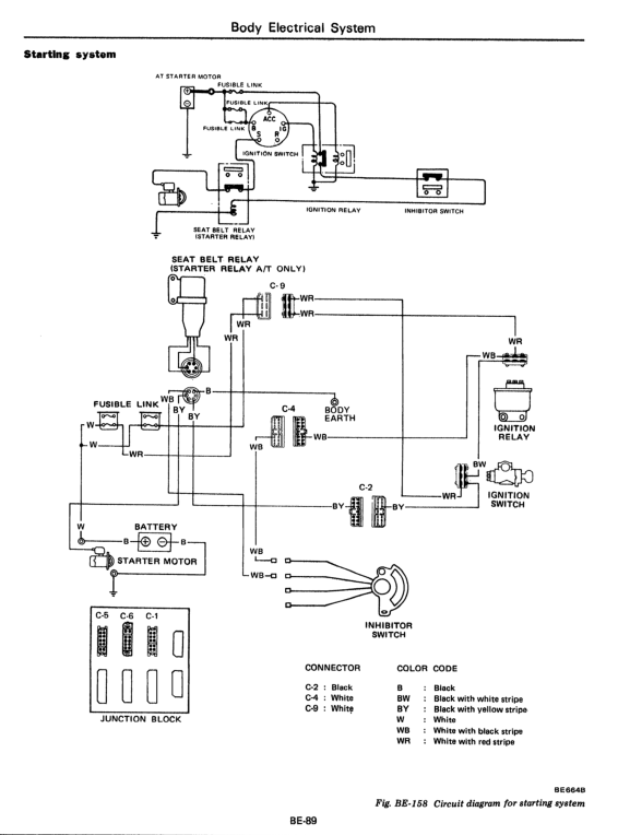

Something that the electrical guys might be able to explain - does this diagram not show power from a fusible link passing through two normally closed relays to a realu coil then to ground?  Can't be right, right?

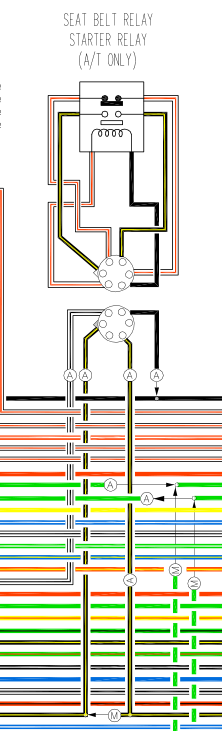

I don't know why Nissan calls that relay a Seat Belt relay.  Hard to tell by the wiring diagrams.  Looks like the seat belt buzzer has its own circuit.

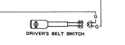

They show the "driver's belt switch" here but not in the starting diagrams above.  Confusing.

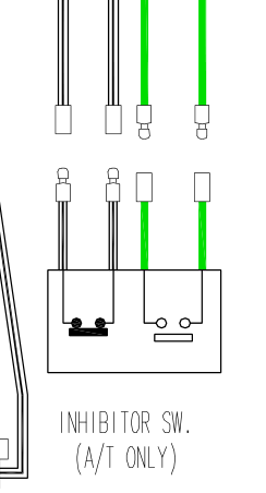

But they do show the belt switch wires as two green wires, which correlate with the two greens at the inhibitor switch.  So, if the buzzer works then stops then the inhibitor is probably getting its power too.
