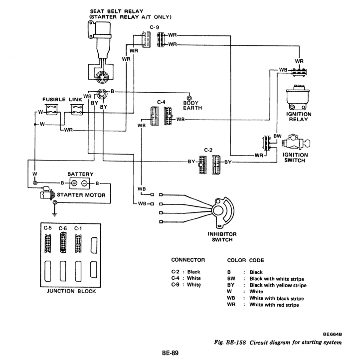

If you want to check if power is making it through the ignition switch I would check for voltage at the black wire with yellow stripe (BY) at the seat belt relay when the key is turned to Start.  That is a straight shot, through just one connector, from the switch to the relay.  One of the two wires at the plug should have power at Start.  The relay just stops it from passing through to the starter solenoid.
The thing about the relays clicking is that when you turn the key to Start the Accessory relay opens to cut power to accessories during starting.  So the click you hear might not be directly related to your problem.
Actually, this diagram frm the FSM clears up a lot, I think.  The inhibitor switch controls the starter relay, the starter relay controls power to the solenoid.
After checking for power, if you have it, verify that the other BY goes to the solenoid.  Then just jump them together as CO suggested.  The engine should spin just like jumping it at the solenoid.

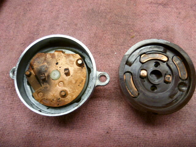

I've never liked the way they run the starter solenoid current directly through the ignition switch. I think they should have put a relay between the switch and the solenoid. That solenoid draws like 8-10 Amps and really chews up the contacts in the switch.
Kinda stupid how on the automatic they DID put a relay in, but didn't actually use the relay to switch the starter solenoid current. They just used it as an interlock. They COULD have put the inhibitor switch on the contacts and the pull in coil on the ignition switch (instead of vice-versa). Operation would have been identical, but it would have switched the higher current load side with the relay.
Here's what happens to the inside of the ignition switch after it switches the starter solenoid a bunch of times:
